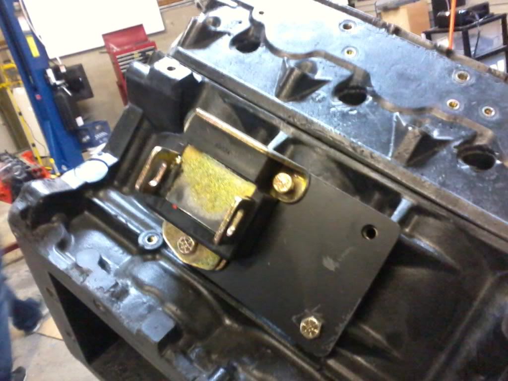

      I have not seen this issue but I would bolt down the frame mounts first then place the motor into place, i use the same frame mounts you have and motor mounts but I have always use the trans-dapt plates, i have never used adaptor plates
      heres the trans-dapt plates used on a mockup block
