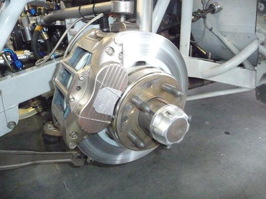

      we Have two sets of the Tornado F4 brake systems!.. you only need to go tru there website to see and READ there tech pages!! info you wil NOT find on any other brake brand website!!!.. They are one of if not the best brake company out there. ther paternd inventions are suspected to be sneeky used bij a Formule 1 team!!. yep thats right!!!!!.
      One of the sets we bought was second hands , we had it completly revised it was the set of Pete Mohrhausers national champion ship winning Transam/GT1 http://www.thebrakeman.com/proad_race
      . Also when they made the car of tomorrow there Tornado F5 brakes where used . A top nascar team tested there system direcly agains a bleu zillion piston fitted 30.000 usd alcon system and that system was spangt in every way!!.
      This team now uses there brakes but wil not let it out here is a picture. Brake man name has been cuverd bij duct tape
      Uploaded with ImageShack.us .
      Uploaded with ImageShack.us when you do your resirts you wil find out that everyting you need is a 4 pistons caliper . they practicly dont advertize and they sell there products more bij word of mouth . 75% of there sales is racing bisenis. NASA champio Ernesto rocco http://youtu.be/OrTxTRr5Z2E http://youtu.be/zpBPopHUe68 grave digger http://youtu.be/z3GGHrAN2LA most of there stuf is custom made to specification, so there is no real one size fits all!!!. Every tegnicel detail about our project car was ask from weight tiLl performance rear ratio transmission to be used tires with hight ecetera the whole 9 yards.
