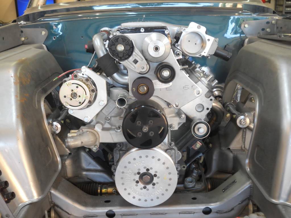

      I am running a Sanden SD7 and made my own bracket.
      Crown Point, Indiana
      1,107
      bracket picture
      Bracket

      Bracket
      Man thats a nice looking setup right there
