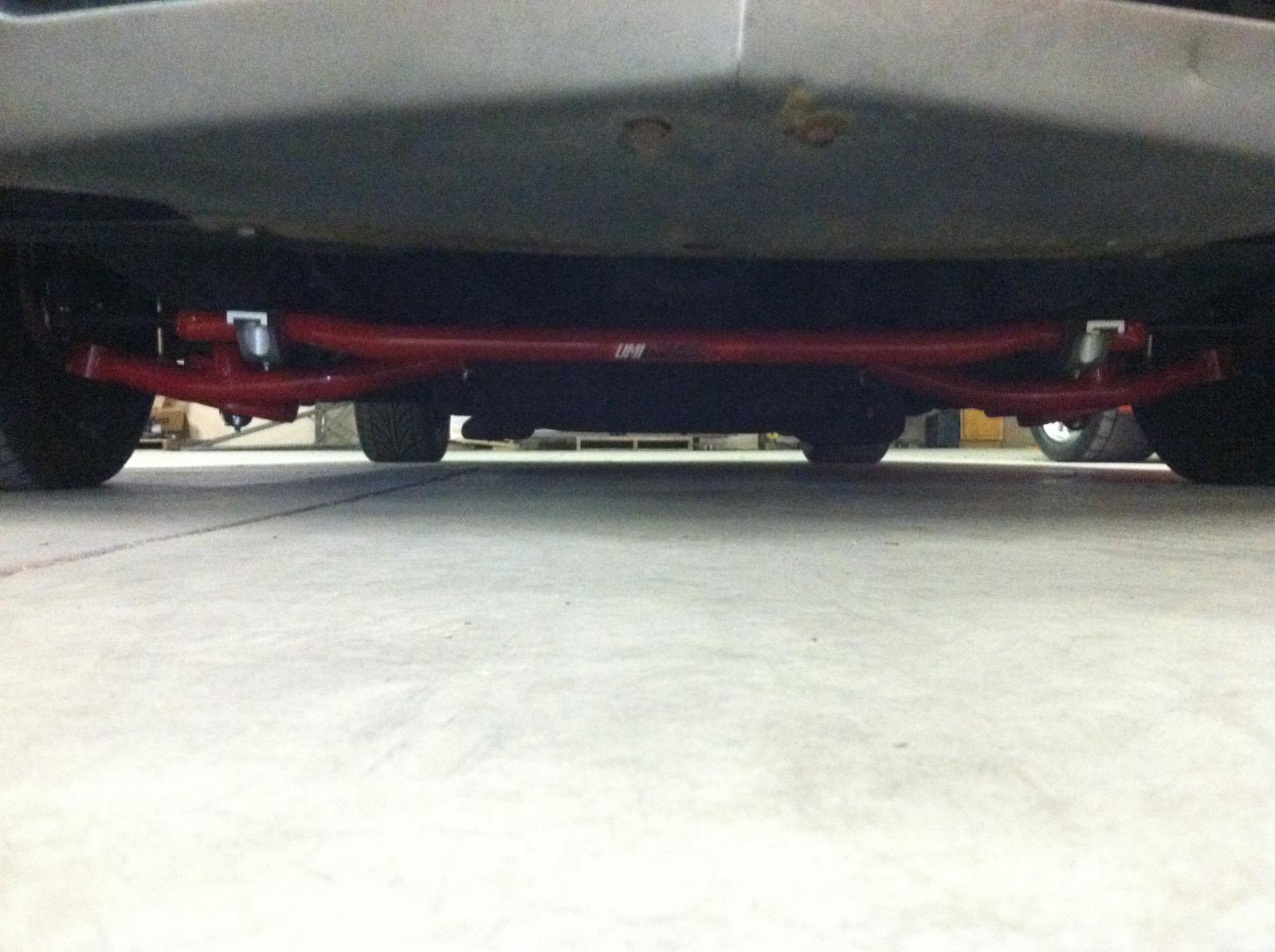

      Great stance. But how's the ground clearance?
      Building a 69 chevelle convertible. Already decided on UMI, likely stage 3 kit. Want the right stance but also want it to be drivable and not dragging on every bump.

      Chassis height is actually pretty good. Our lowest point is the headers (Pontiac engine, not SBC). I can check crossmember height tomorrow when I get to the shop.
      That car has a 2" lowering spring in the rear and 1" in the front. We can 1" rear and stock height front to get the overall height up an inch if necessary.

      Looks good! Curious to hear what the crossmember height is.

      Our car currently has 245/45-17's up front. With a 1" lowering spring and 2" drop spindle, the crossmember height is 3-1/4" and the header collectors are right at 3". The lower a-arms ball joint to pickup point relationship is pretty sweet as the a-arms are parallel to the ground. We're a little bit nose down right now, kind of a Pro Tour look with a bit of drag race mixed in. Adding a coilover up front to get a tiny bit of crossmember height is a nice option if necessary.Name:  LeMans crossmember.jpg
