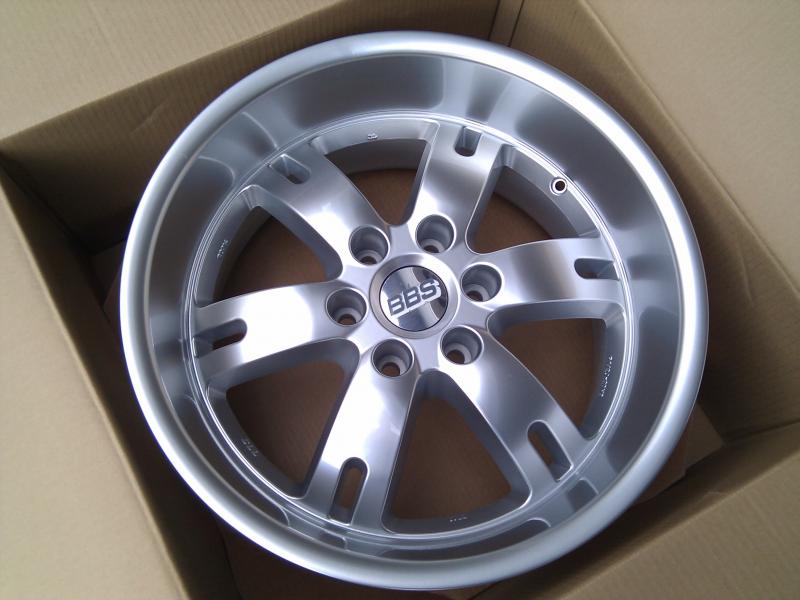

      The shocks look original so I'm going to replace those to smooth out the ride.. hopefully that will help. Also, the tires are older so I'm going to put goo rubber on the new 20" BBS wheels I picked up.

      I scored some 20x9.5 BBS wheels. These are offered as an option for the FJ Cruisers an other Toyotas.. I love the look of them. I'm going to mount them on 305/50 Coopers and then lower the suspension accordingly.. 2/3 drop, keys, springs and new shocks.. nothing too drastic.
