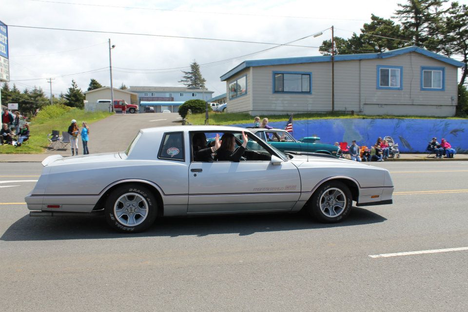

      so I need some suspension education. I got a 86 monte ss it pretty much is bone stock appearing Name:  0430111226-01.jpg
Size:  264.6 KB Name:  526733_3097759684932_1301455088_n.jpg
      i dont want really low maybe an inch at the most. but more than any thing i want to stiffen it up a little so it will handle better.
      I converted it to a big block and am having a hard time finding off the shelf springs.. How do I deter-man the right setup for my front end?? will i have to do somthing like install spring helpers so my exhaust dosent drag the ground? and just deal with it? dont have alot of money to spend on it so any suggestions would work

      ridetech has a great spring rate calculator that will also work for non coilover springs.
      You need to know the amount of travel you want and the corner weight. As well as spring length at ride height.

      As Bryce mentioned, the real key is the front end weight and installed length of the spring. You have several rates and free lengths available from the circle track world.
      Find a friend with a set of scales.

      Once you get the info mentioned by Bryce and Ray, Eaton Detroit Springs should be able to help you if you cant find what you need. They can make springs with custom lengths and rates. www.eatonsprings.com

      We have been having good luck with QA1's Pro Coil system. The adjustability allows you to miss the spring rate by a few pounds with no penalty.
      We can do these handling kits with QA1's up front instead of the standard Eibach kits.
