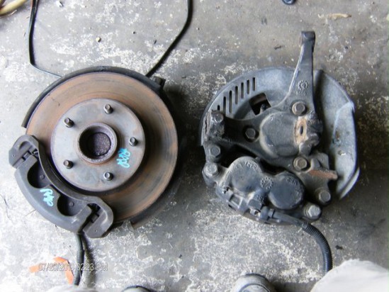

      The 8.5 rears were in the stick shift blazers 98+. If you found one, grab the spindles off of it. the spindles on the 98+ blazers have dual piston calipers and sealed bearings with the seperate rotors (better braking for cheap!)

      Conversion brackets and lines are also available to bolt up C5 or C6 brakes to those sealed bearing spindles
