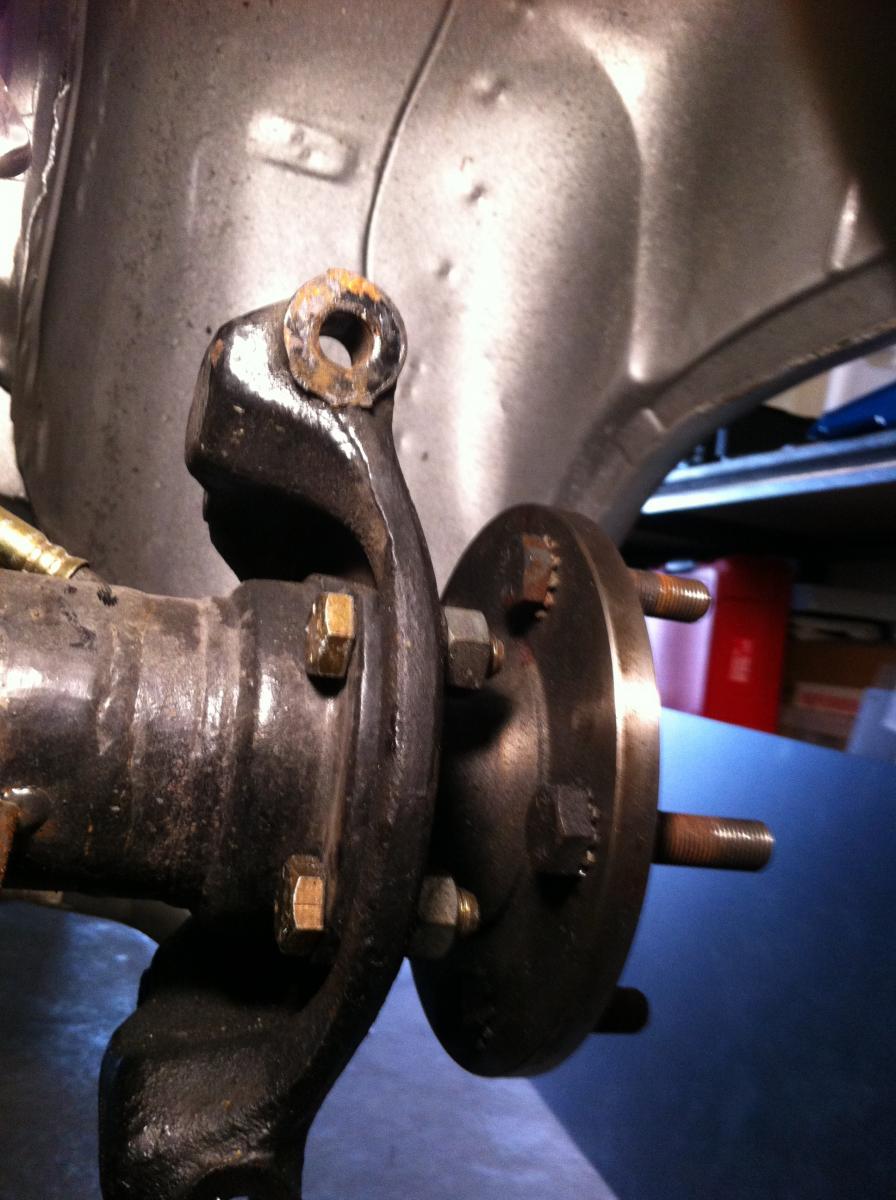

      The axle came out with a slight tug on the flange.
      I could move the bearing about .155'' away from the retaining collar once the axle was out, is this normal?
      before I removed the axle i removed the wheel, and brakes and I could pull the flange in and out about .045''. Good? Bad?
      I also noticed a small nick in the seal not sure if this was the cause of my leak though.
      Is it a good idea to smear a little sealer around the outside of the seal where it seals to the housing?

Size:  87.9 KBOk so here is what I found....

      Well I changed the seal and bearing and finally drove it yesterday only to have it leak even worse than before!!! I am lost on this.......

      It does have a vent but will have to check it to make sure it is good. I am guessing it is cause it leaks all the time lol. Upon taking it apart yet again it seems that it is leaking at the seal part that seals to the axle not the housing.
