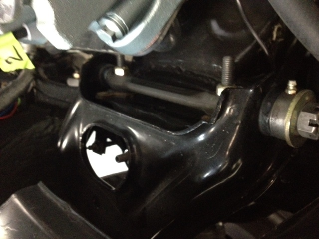

      Hi robscar, I like to do mods that don't show too. On my 1968 Firebird I did the Guldstrand Mod, solid UCA bushings, offset UCA shafts, powdercoated UCA's and Bilstein shocks. Here's a picture. (Couldn't rotate the darn thing) When I did the GM I used a template and tapped marks where to drill, just like the others have said. But after I drilled the first hole I put a bolt through it and the UCA shaft. Then looking in the other hole in the shaft I could verify if the hole spacing was correct. Better than relying on just a paper pattern. I used the old UCA shaft as a guide to drill the second hole.

      That is a great idea to use the old UCA Shaft to drill the second hole! Thanks! I will do that when I do the GM on my 68-FB

      Thanks for the picture. I'm still waiting on my Proforged tall up ball joints. They were in the process of moving when I ordered them. After talking to the gent there I decided to just do the bolt on parts for now to see how well she does before going with the GM.
