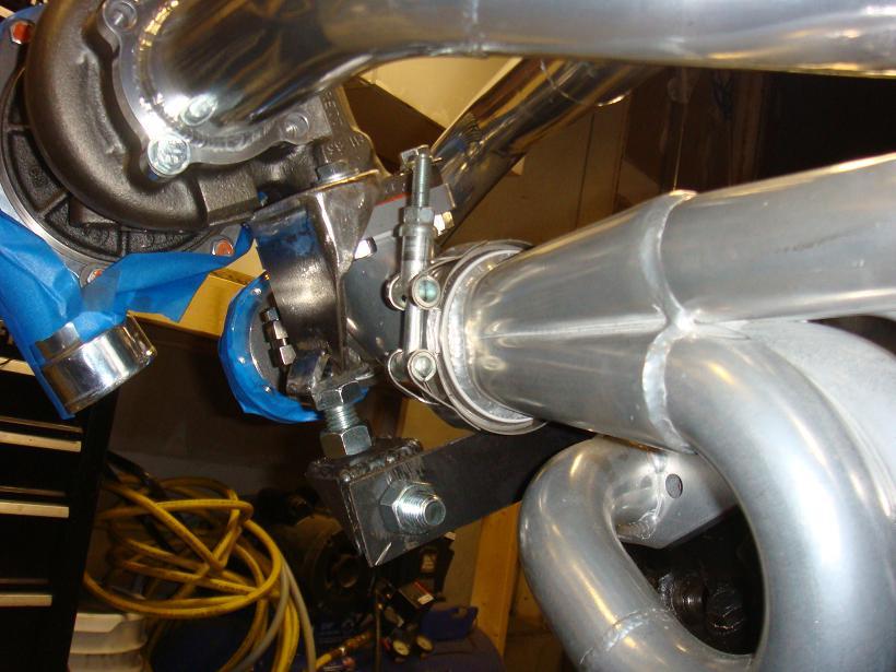

      LI New York
      104
      Quote Originally Posted by sccacuda View Post
      Bracing is pretty easy. You can use a 1/4" or 5/16" rod with small hiem joints on either end. I try and triangulate the braces to support the weight of the turbo but allow for movement.
      They can be braced. It takes some thinking though. Here's my build. I built headers very similar to those out of 304 stainless with floating braces. 2 years so far no cracks.
      http://www.theturboforums.com/smf/tu...26/#msg1448526
      1968 Camaro Convertible. 9" rear, Caltracks, 350 , PTC 3000 stall, Custom Twin turbo built by ME.
      LI New York
      104
      Oct 2009
      Canada
      8
      Well looks not so impossible. Thanks for the pics mnm99. I think I will have to give these headers a kick at the can.
