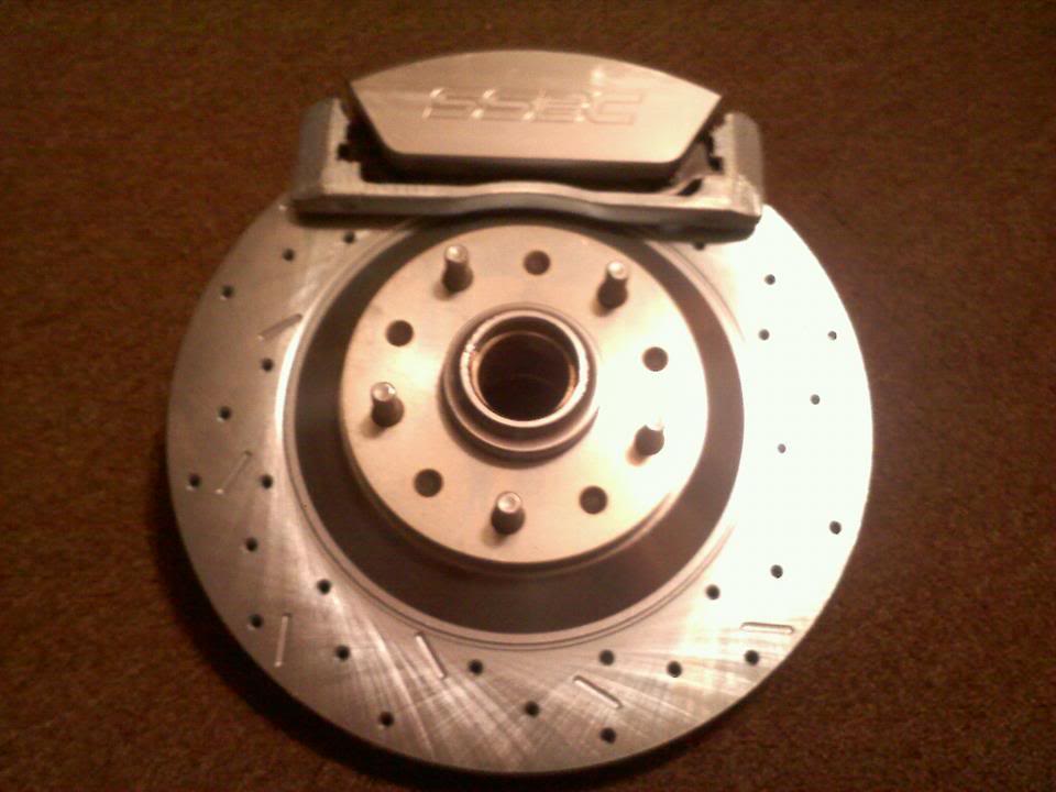

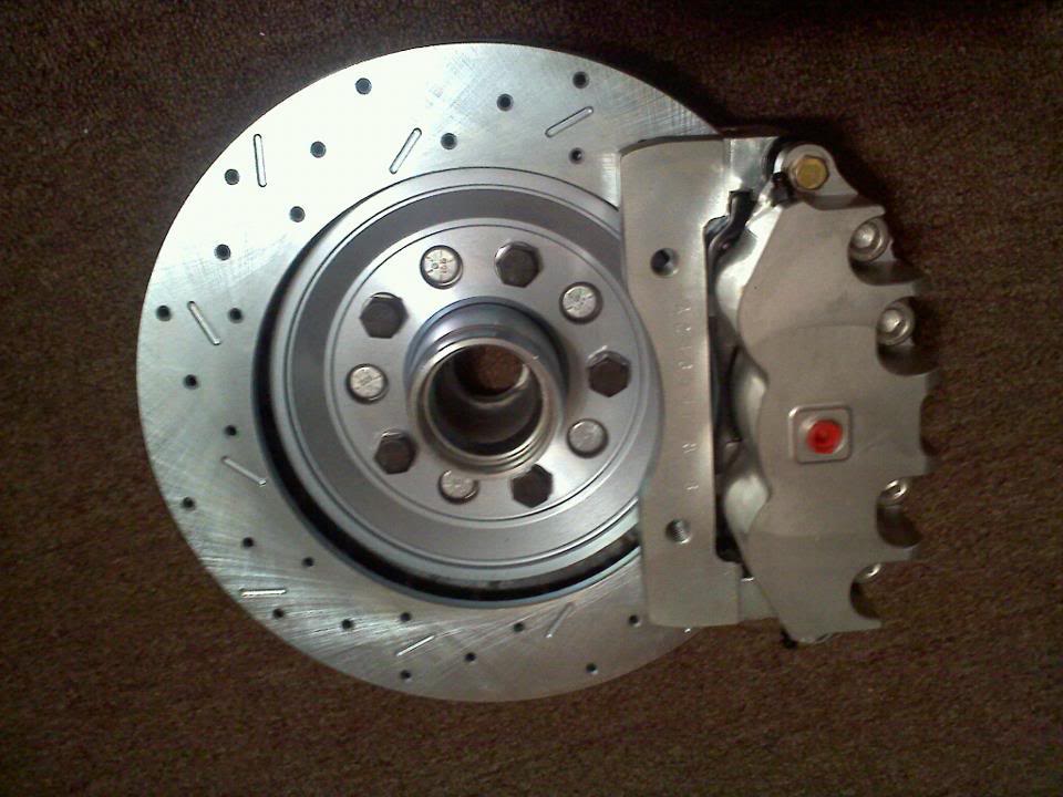

      Well, I went with SSBC.
      I have just received their front (TRI Power) and rear (Sport R1) kits.
      The front is a 3 piston floating caliper and the rear is a single floating caliper with 13" front and rear rotors ( which are actually around 12.8" measured by measure tape)
      Will see soon how they work.
      [ATTACH=CONFIG]62240

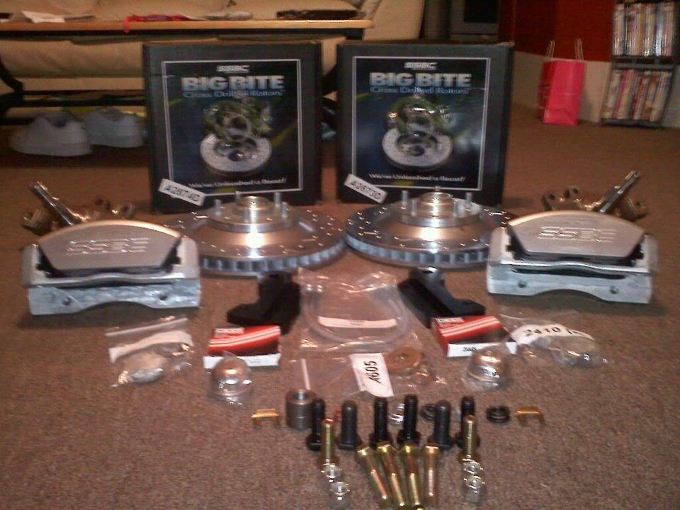

      im running the ssbc brakes too!!!

      Quote Originally Posted by robertjra View Post
      Nice kit.
      I got the grooved rotors maybe I will upgrade them to this crossdrilled type. They look better.
      Have you installed yet?
      Do you have SSBC all around?

      Quote Originally Posted by medbali76 View Post
      Nice kit.
      yes parts are installed car is not running but I have installed 10-15 of the big bite kits good brakes!!!

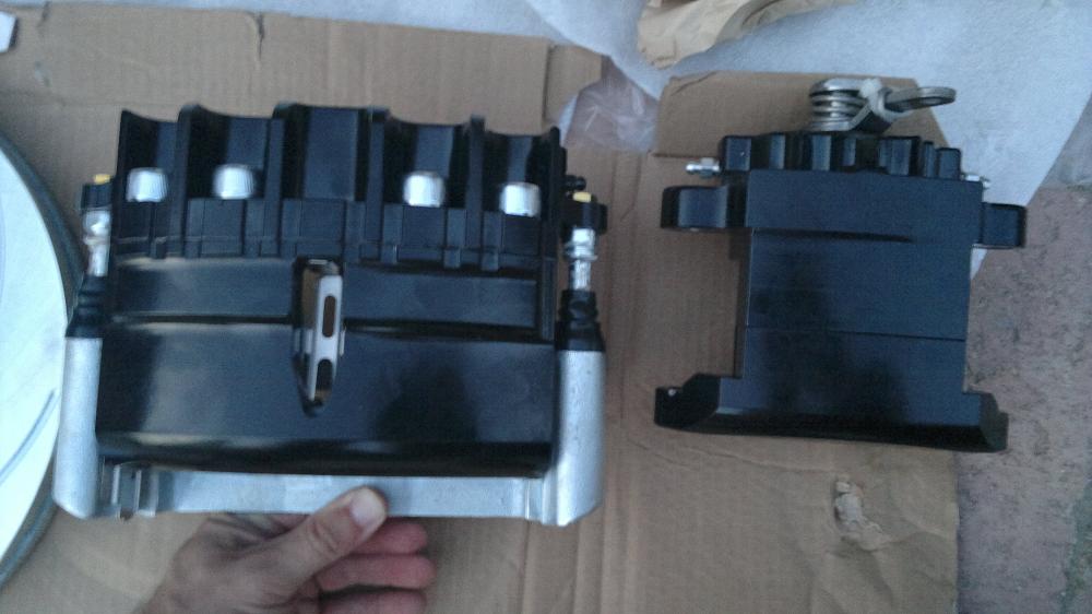

      Here are the numbers. Unfortunately my digital scale broke down so I used a conventional one.
      Front Tri Power caliper is 5.77kg (12.72lbs)
      Rear Sport R1 is 2.550kg (5.62lbs)
      It seems they are not the lightest calipers on the market at all
      Here is a pic of these calipers side by side.

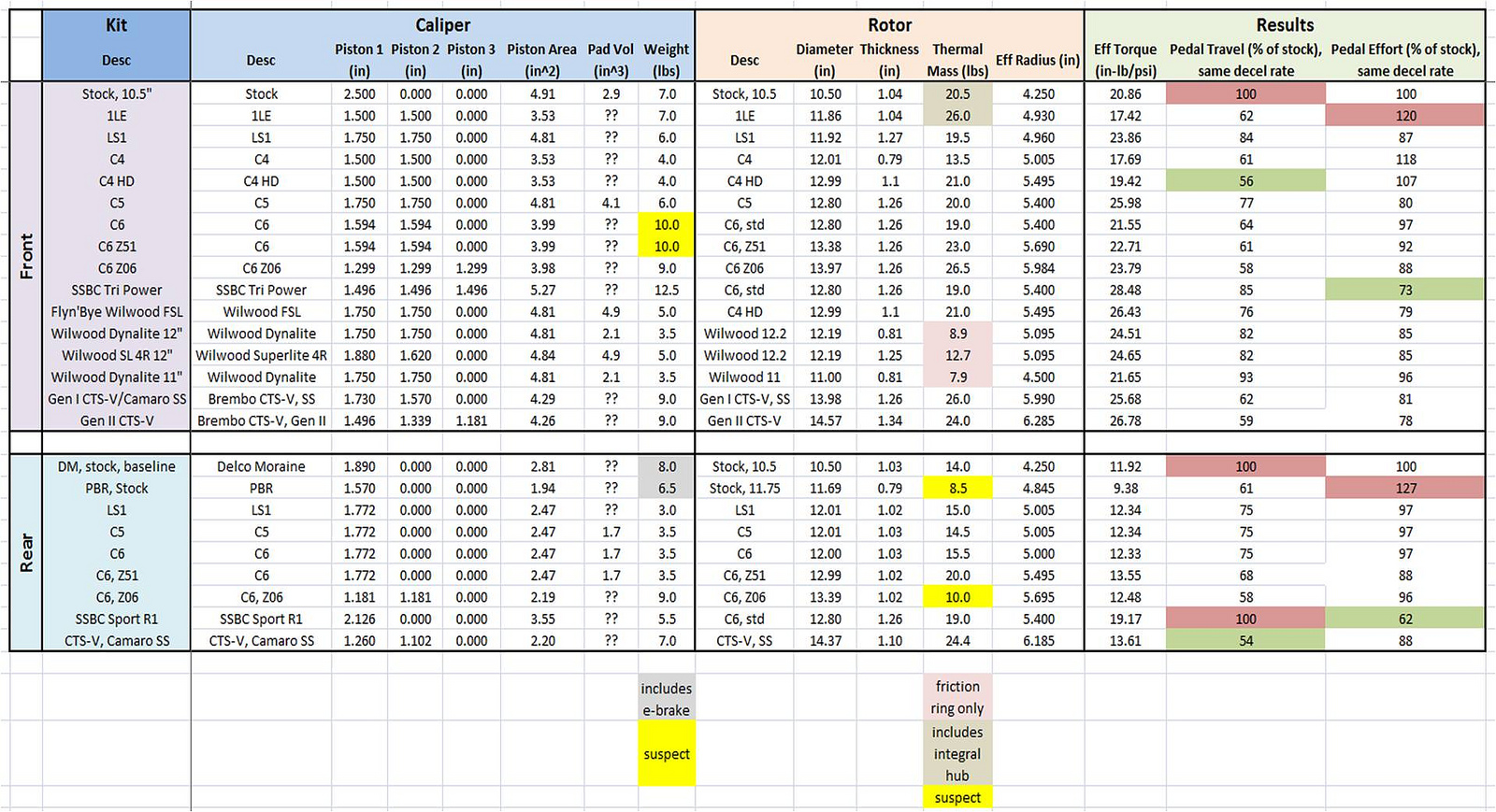

      Wow those calipers are huge. They really look great. Never seen a sliding caliper that large.
      I ran the numbers and these are very powerful calipers combined with a large rotor make for a very efficient system. For reference, the chart compares performance to the top line, which are the stock brakes on a third gen Camaro.
      May 2012
      Hungary
      323
      Country Flag: Hungary
      Quote Originally Posted by jpgolf14 View Post
      Yes, the Tri powers are huge pieces. Maybe the pic is cheating a little on the real size compare to the smaller caliper but it is really impressive by visual.
      According to your chart it seems these SSBC kits are really on the top line.
      It would be very interest to see some Baer and 6 piston Wilwood kits in your comparison chart.
      I wanted to buy the Baer's T4... I am wondering if it is better or not.

      Yeah I am surprised to see the SSBC kit with that much piston area and the huge rear rotor. Pay a lot of attention to those last two columns. And figure out what you prefer. Personally I like a short moderate pressure pedal. So for me a moderate piston area on a big rotor is good. I do not like how long the brake pedal is on GM cars normally. As with everything on cars, its a compromise. Bigger is not always better.
      I would love to add teh Baer kits but I can't find the piston sizes online. I do not like that Baer keeps them secret. If you have the info, let me know.
      The Wilwood 6 piston kits typically have about the equivalent piston size to their 4 piston brothers, but it would still be interesting to see them there.
      Also, for my chart keep in mind I am making the following assumptions:
      Same caliper flex in each kit
      Same pad compound
      Same master cylinder bore size, pedal ratio, vacuum booster, ect..
