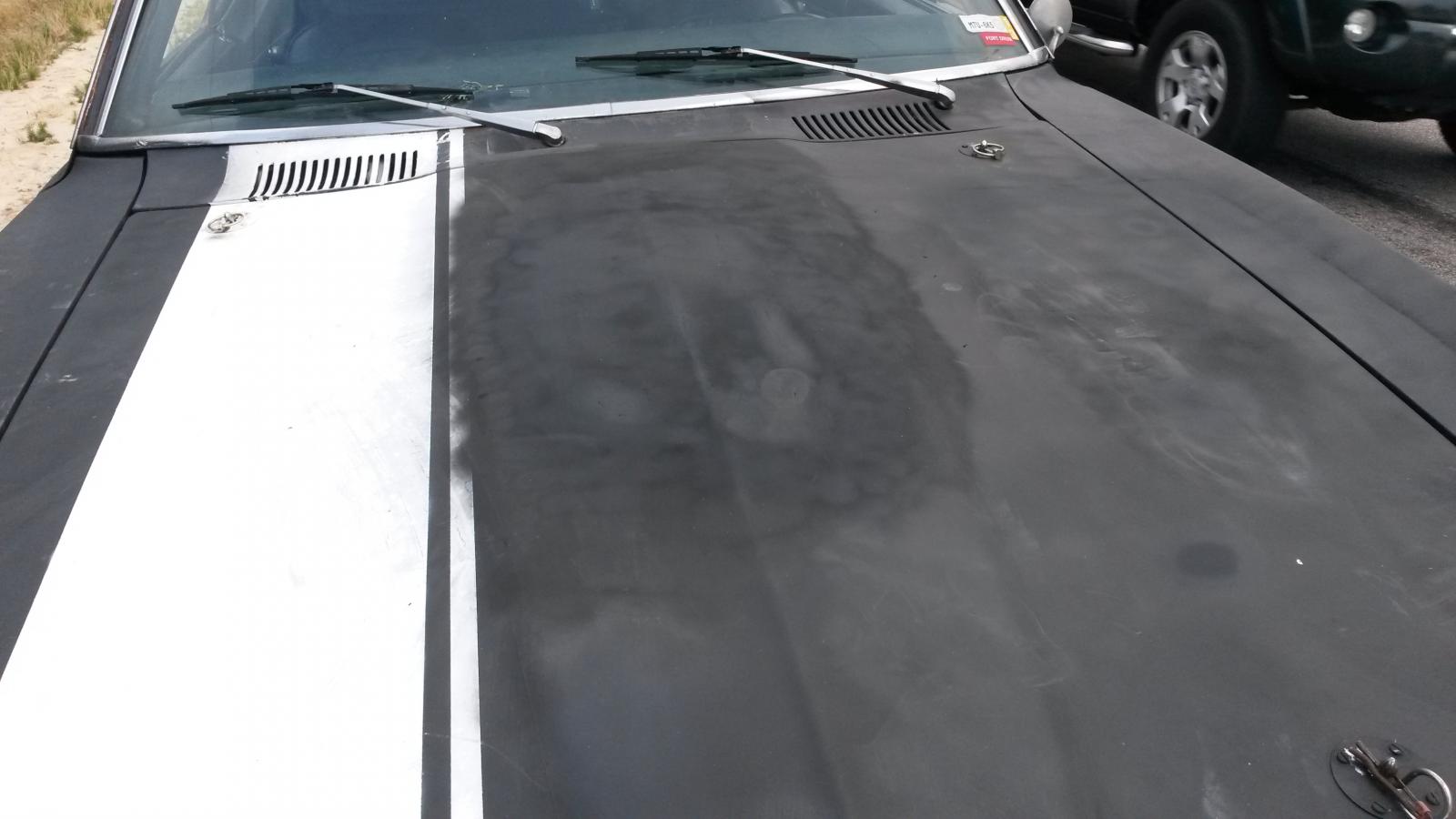

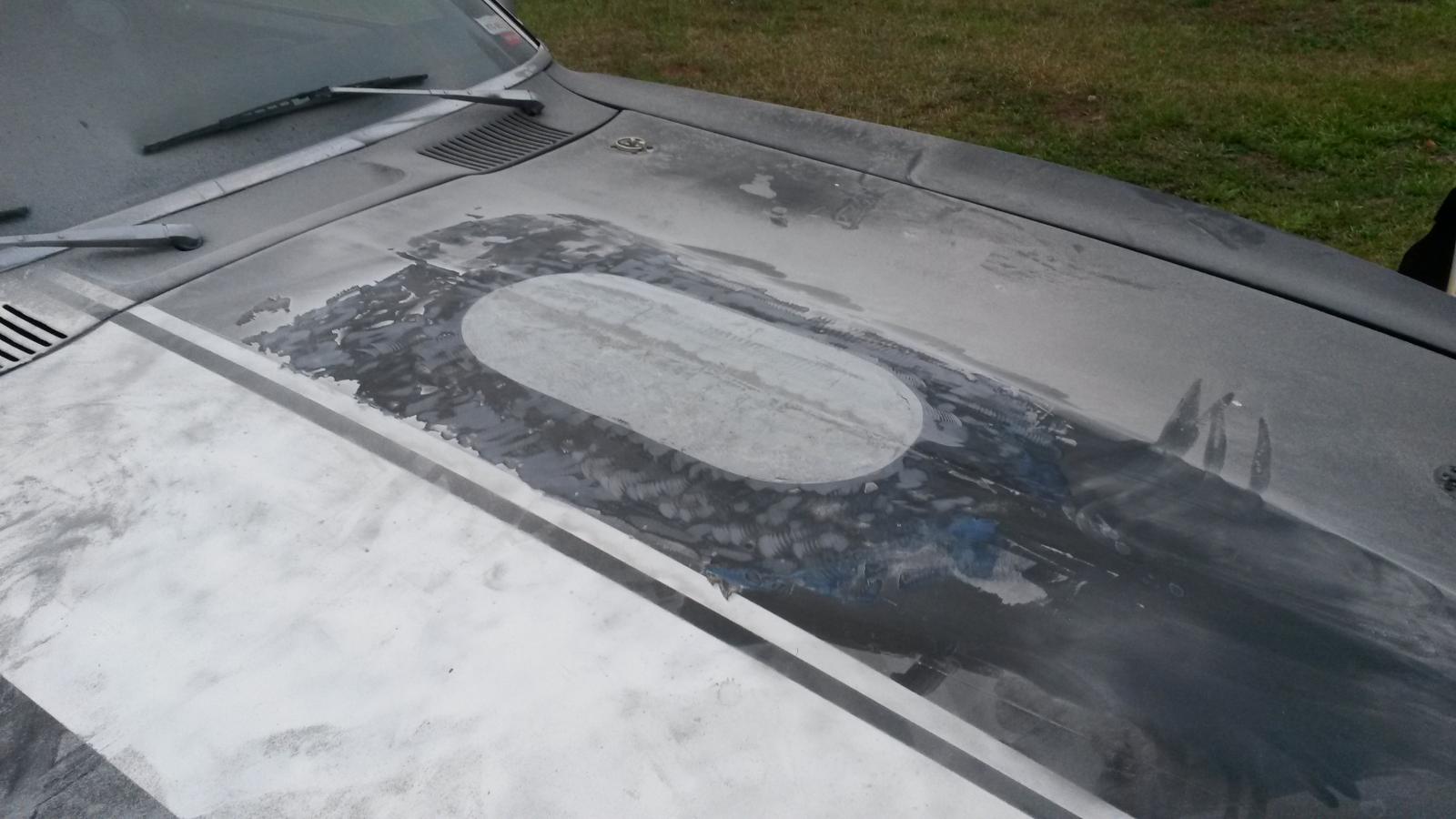

      Aside from that, I saved myself $400 today by fixing the hole in the fiberglass hood instead of buying another one. I bought $6 worth of fiberglass matting in a big sheet, and $15 of fiberglass gel resin. I cut a chunk out of my own metal hood and threw it under the hood on top of my tempest hood, and the firebird hood was upside down on top of the metal chunk. that way the fiberglass had a form to follow and the patch would then have the ridge just like the factory hood did. I was actually really simple, now i just need to do the finish body work on it, filler primer etc. but it looks good, I'm very pleased with it. posting pics and a video in a few minutes.
      Jun 2012
      427
      here's the video of the whole process. a couple hourse of work edited down to 8 minutes. I didn't know how it would turn out but it turned out really really good. i mean the hole was over a foot long and almost a foot wide... took three layers of fiberglass matting and gel in between each layer. the last pic before it was painted shows the matting before i applyed a layer of gel to it too, and then sanded it. no more rivet holes of a giant hole in the middle either. just need to primer it a few more times and block sand and maybe use a tiny bit of filler. now my fiberglass hood looks like a factory flat hood, just much much much lighter...

      Dunno about knowing it all, but I'll try it all for sure. Writing this as I'm waiting for a tow. My pinion yoke nut backed out and dropped my driveshaft on the ground as I was coming home from being in the field for 4 days... chances are my gears are **** now so I can re gear my 12 bolt. On the sunny side of things I'm going back out in the field for a week so when I come back again all smelly and such my parts will be home and ready for me to install them. Whatever it is I want to install. Also a good note is that patch I made for my fiberglass hood turned out really well. Just needs some sanding and paint. But is the right shape and everything. It's anything but rough. The sloppy painting gives it an odd look but it's strait.
