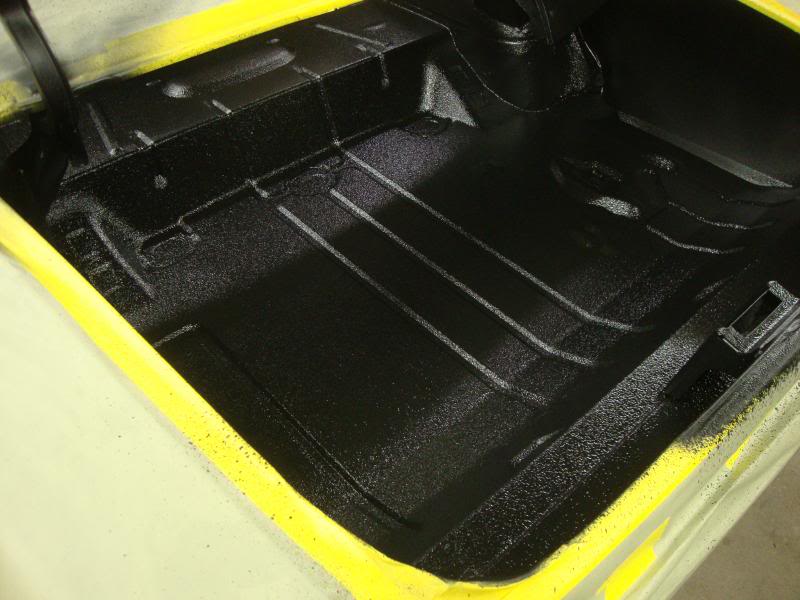

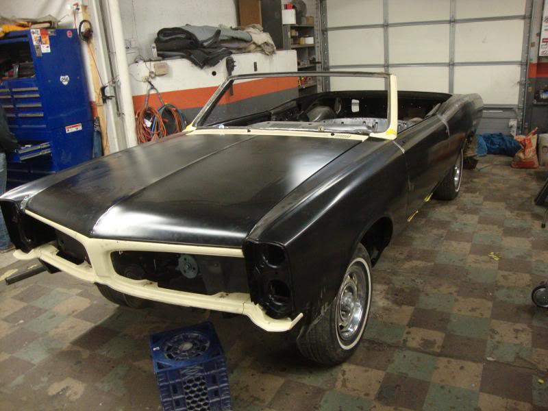

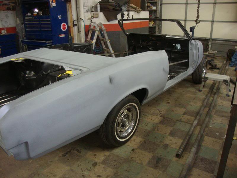

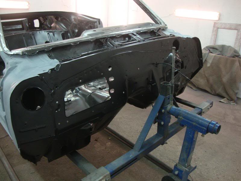

      Made a bit of progress since my last post on this one..
      Here's a few pics.. Really glad to have gotten this one to this point.

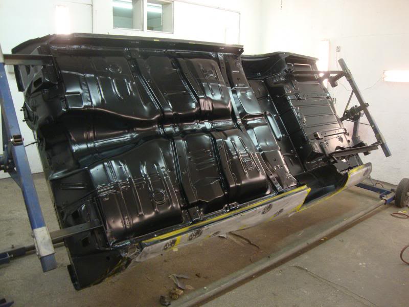

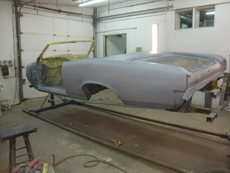

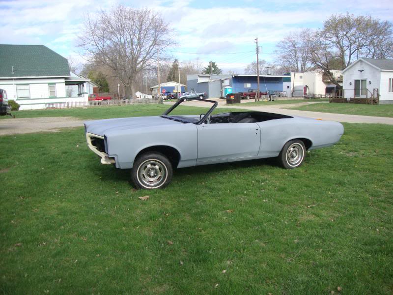

      Moving forward again!!

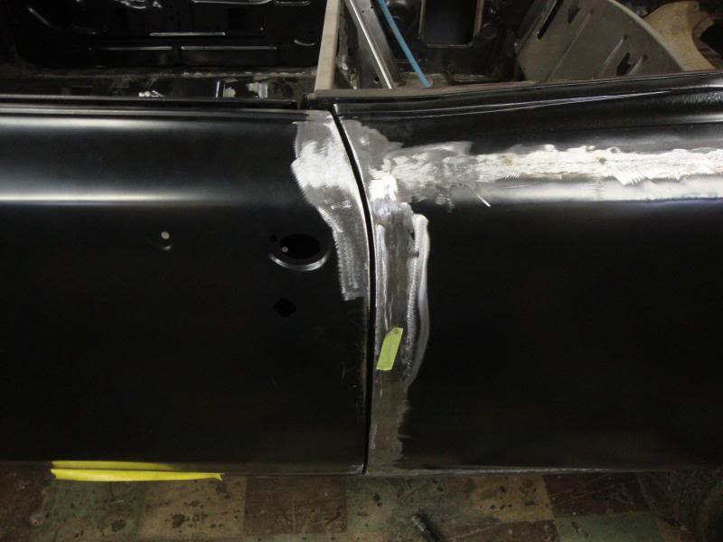

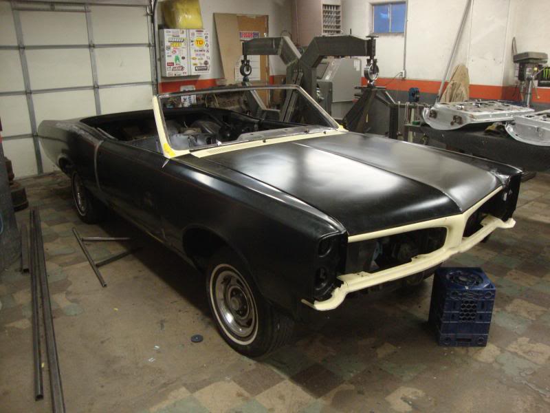

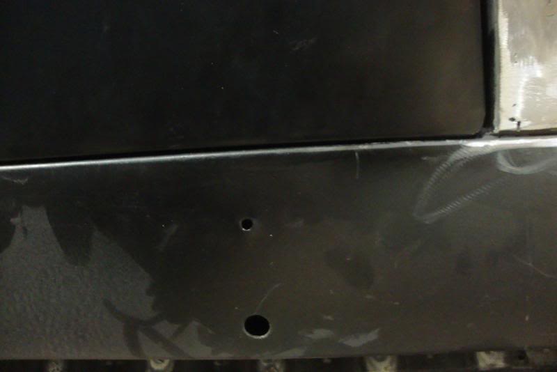

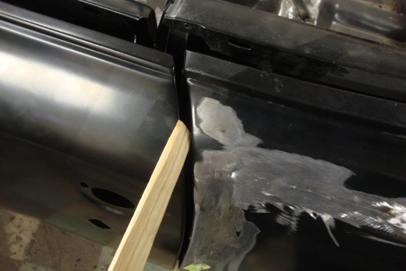

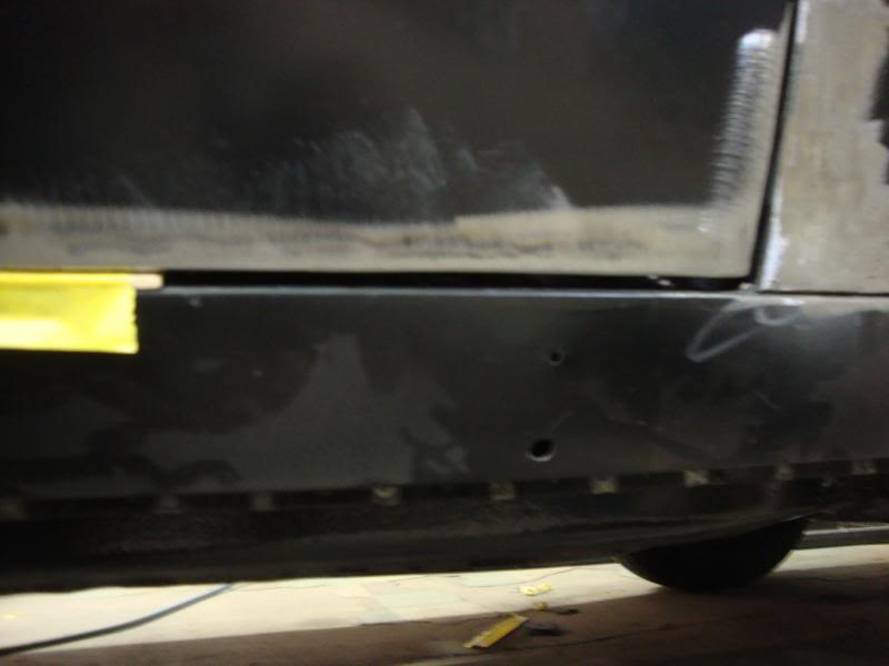

      What did you do to get those two door gaps looking better?
    9. #29
      Feb 2012
      SW, Michigan
      875
      Quote Originally Posted by rohrt View Post

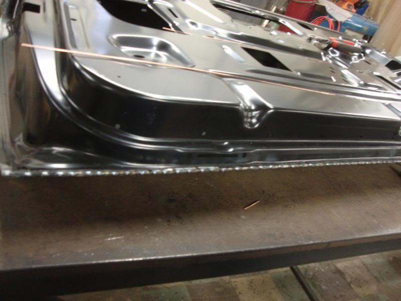

      A bunch of different things, Had to trim off some of the bottom of the door, re weld and grind, a few spots I had to add metal, weld and grind..
      I always do this type of work with the tig welder, it leaves a much better finished product.

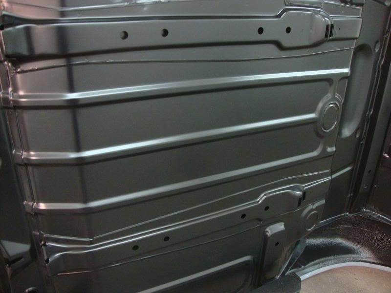

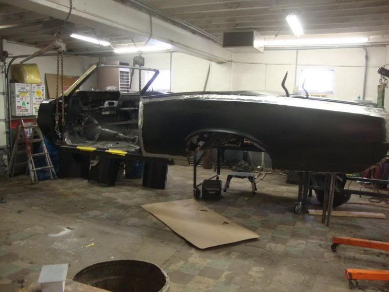

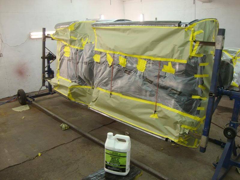

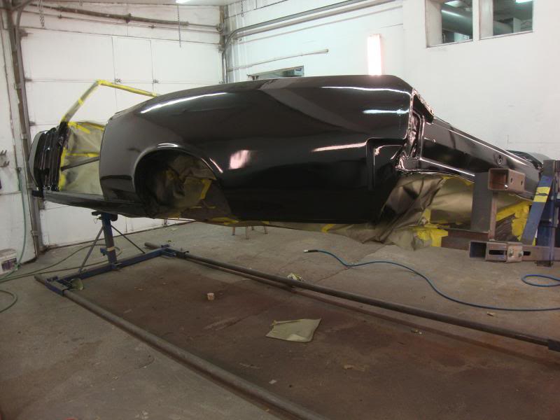

      Putting in some hours again on this car.. Making good headway.

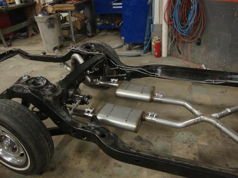

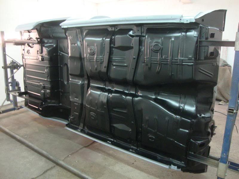

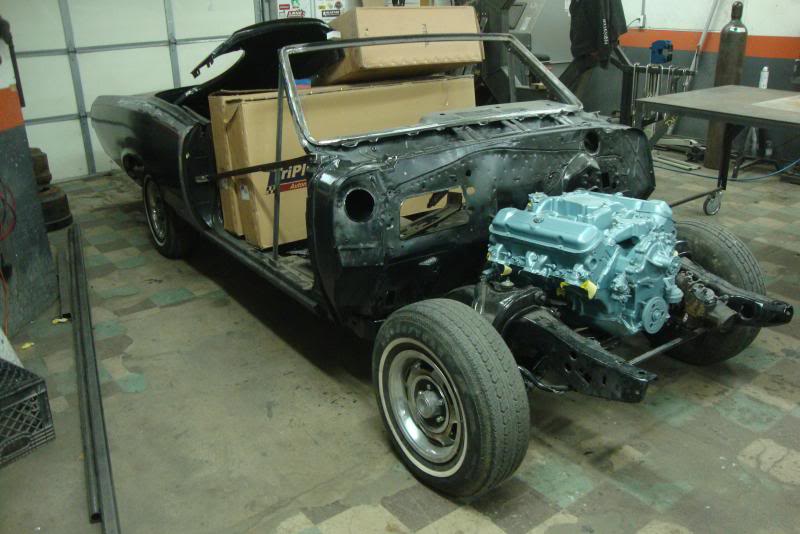

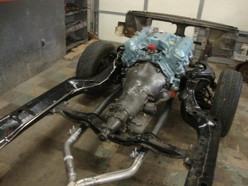

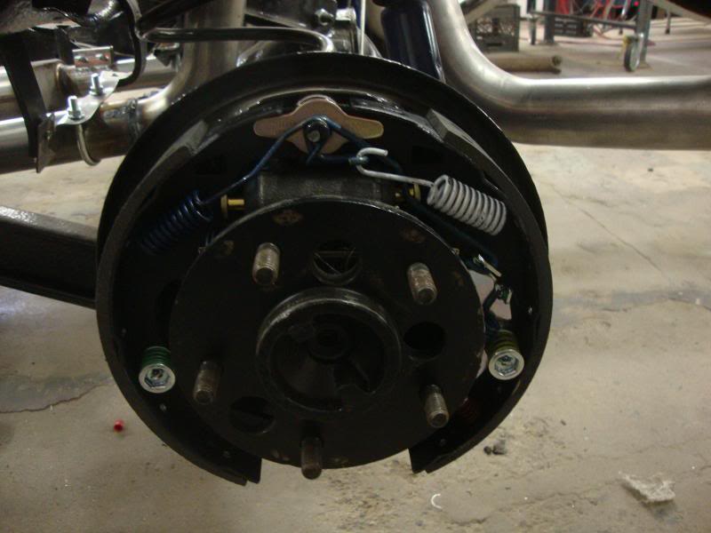

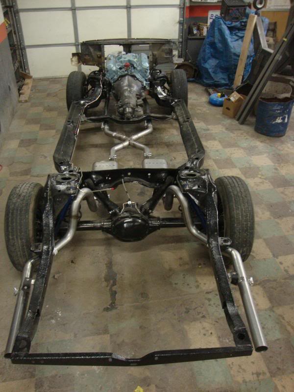

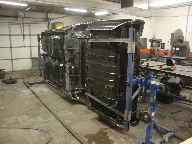

      Pictures of the bottom side of the car, and some pics of the powder coated frame with stainless exhaust, fuel and brake lines.
      Had to move the cross-member to mount the 700R4 trans
