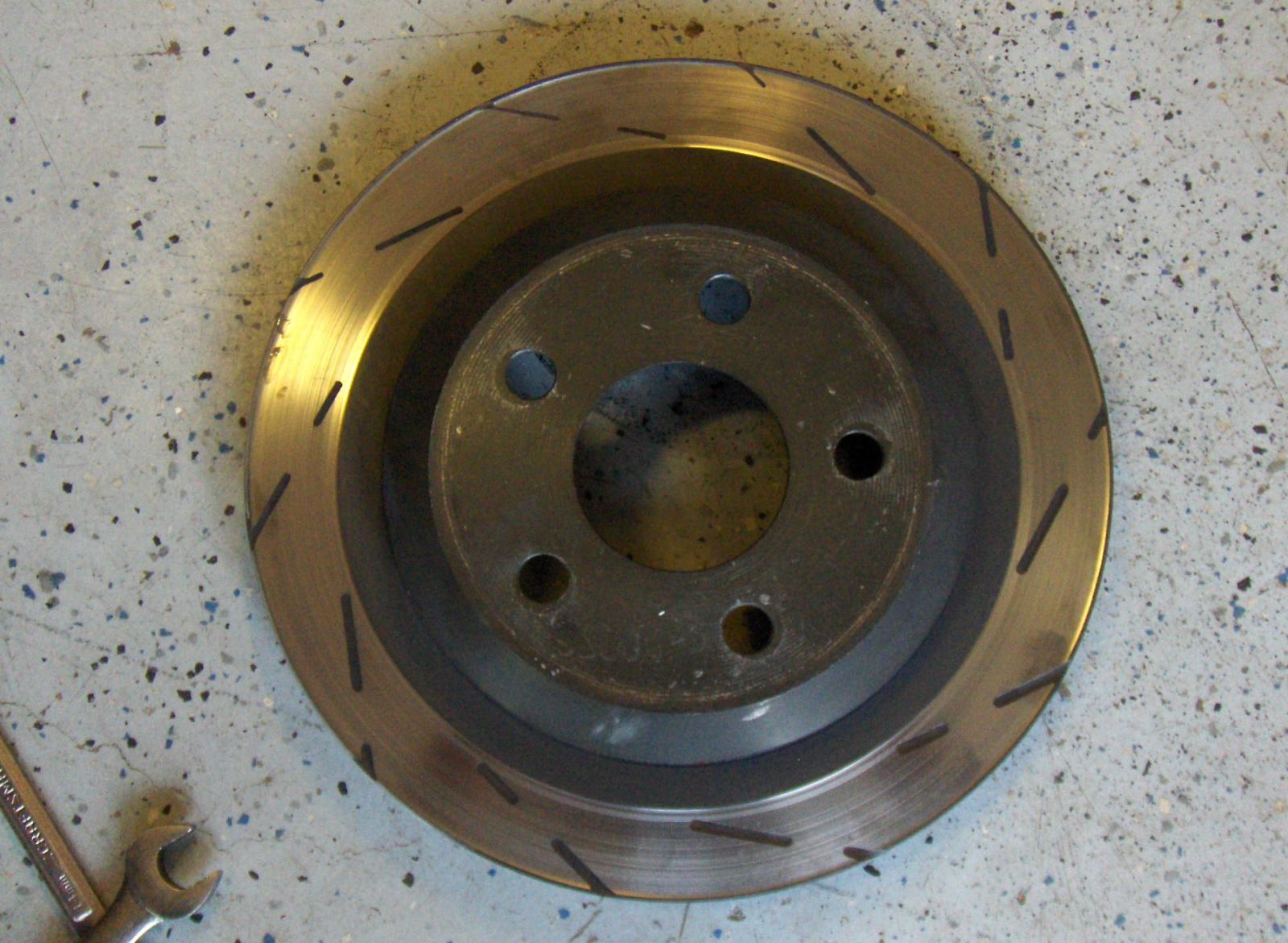

      I pulled the wheels off last week and found the front rotors look almost new while the rears are very worn. The right rear rotor is almost worn through the slots and even most strange to me is the fact that it is not eveny worn (see pic). The pads in general look fine and are not worn at all.
      I contacted EBC and they were very nice to talk to and responsive. EBC is even nice enough to send me a new set of rotors due to the issue. They say the pad compound is causing the wear which seems reasonable since the pad looks new but also seems odd to me since the fronts run the same pad and the rotors look almost new. I asked them which pad they recomend for the maximum stopping without excessively wearing the rotors. They responsed

      Has anyone had similar issues with EBC rotors or using HP+ pads? Any idea why the rotor is wearing uneven?
