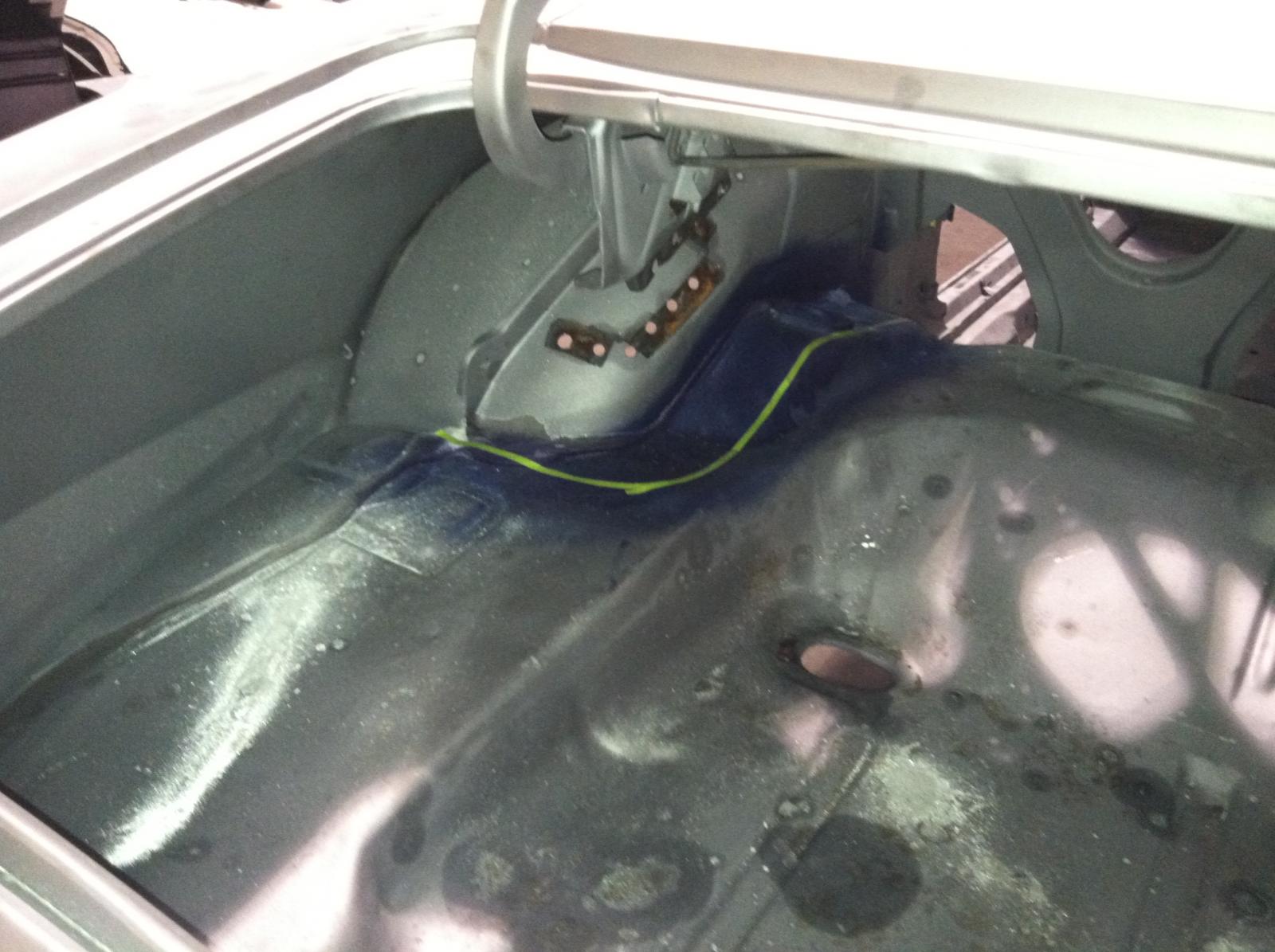

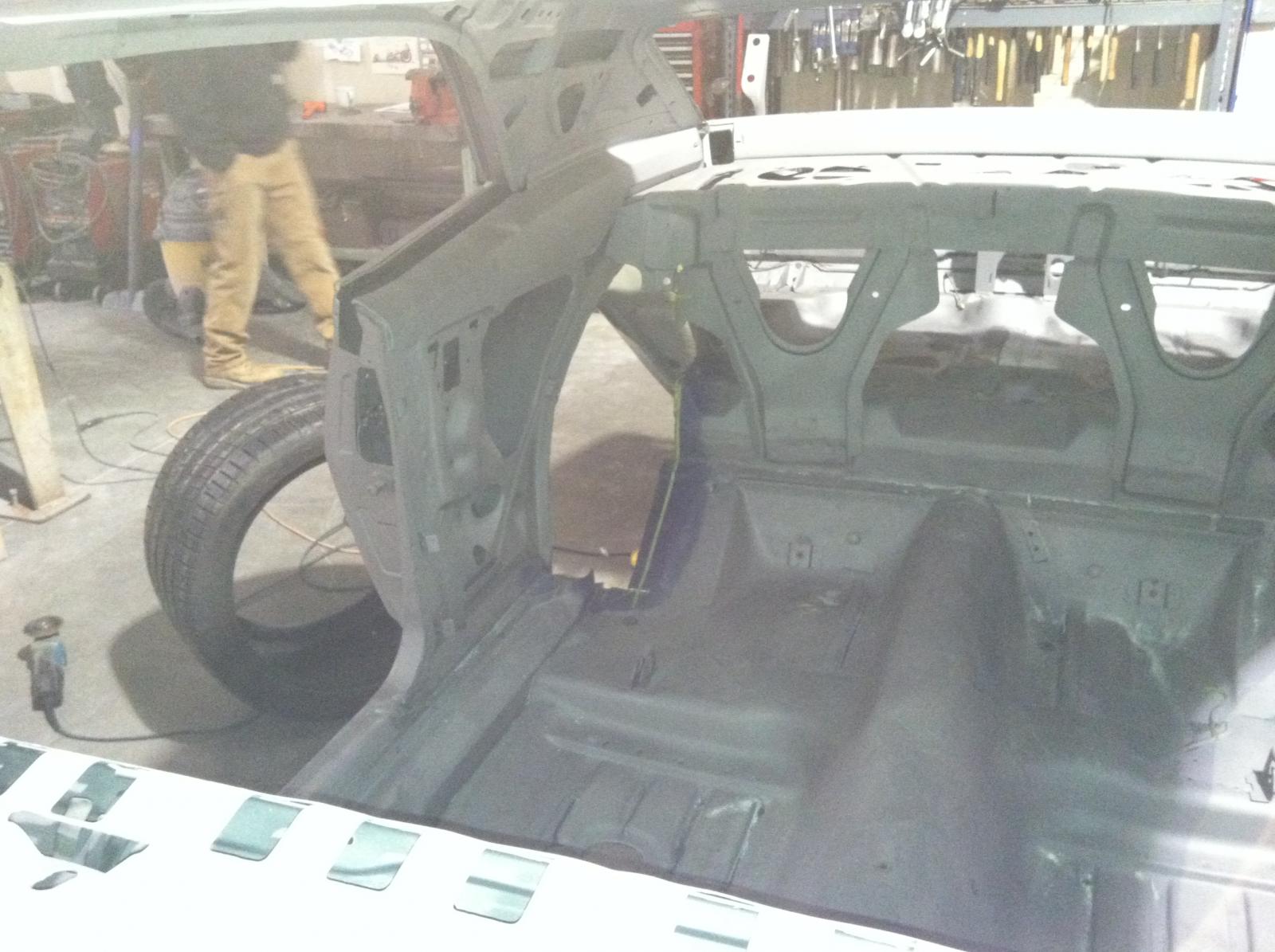

      Great looking project. I have been throwing around the idea of mini-tubing my 68 Camaro. How long do you think it took you to complete the mini-tub on your car?
      Apr 2010
      10
      I'f I remember correctly he spent 40-50 hrs on the tubs. The DSE tubs are built for a maximum of 335. Some additional fab work was needed to stuff the 345/30/20!

      Quote Originally Posted by six8fbird View Post
      I'm speaking on behalf of Tim Conder at Conder Customs in Santa Rosa, CA. I'm currently over the pond back in the sandbox. I'll have to get back to you on the mini tubs. I'f I remember correctly he spent 40-50 hrs on the tubs. The DSE tubs are built for a maximum of 335. Some additional fab work was needed to stuff the 345/30/20!
      I've heard 40hrs before so that seems to be a common trend. Now I need to decide if its worth it. I feel like I will regret it if I don't go with the tubs. Thanks.

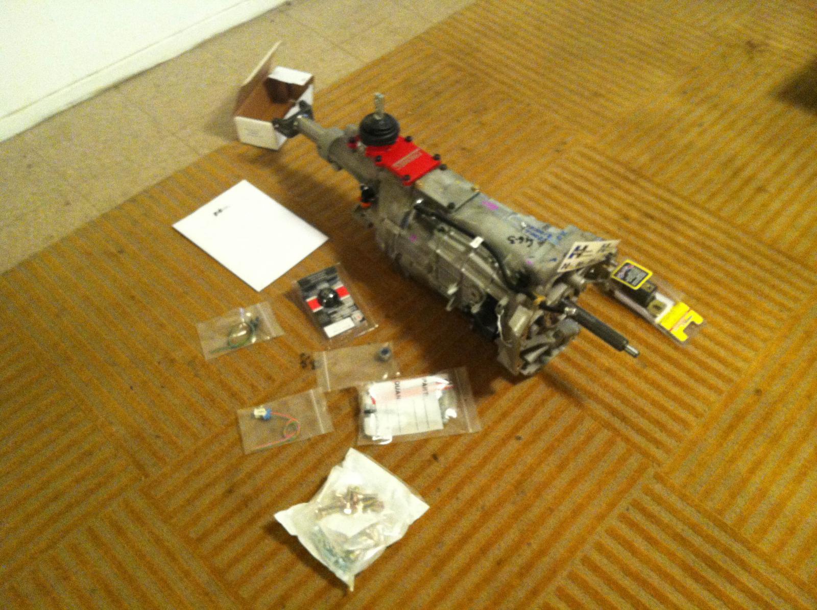

      A few goodies I got to order this last month.
      *LS3 - Had only 40 mins of dyno time. Comes complete with computer and all front drive accessories.
      *Ring Brothers Anodized Airframe Hood hinges and other misc billet anodized interior pieces.
      *ATS (speedtech) Coil relocation bracket
      *ATS (speedtech) LSx Motor brackets - Poly mounts
      *Mcleod (summitracing) RST twin disk & steel flywheel package
      *Wilwood (summitracing) Triple Master cylinders and Clutch/Brake pedals
      *T-56 Magnum .63 OD from Hurst-Driveline conversions - Basic kit
