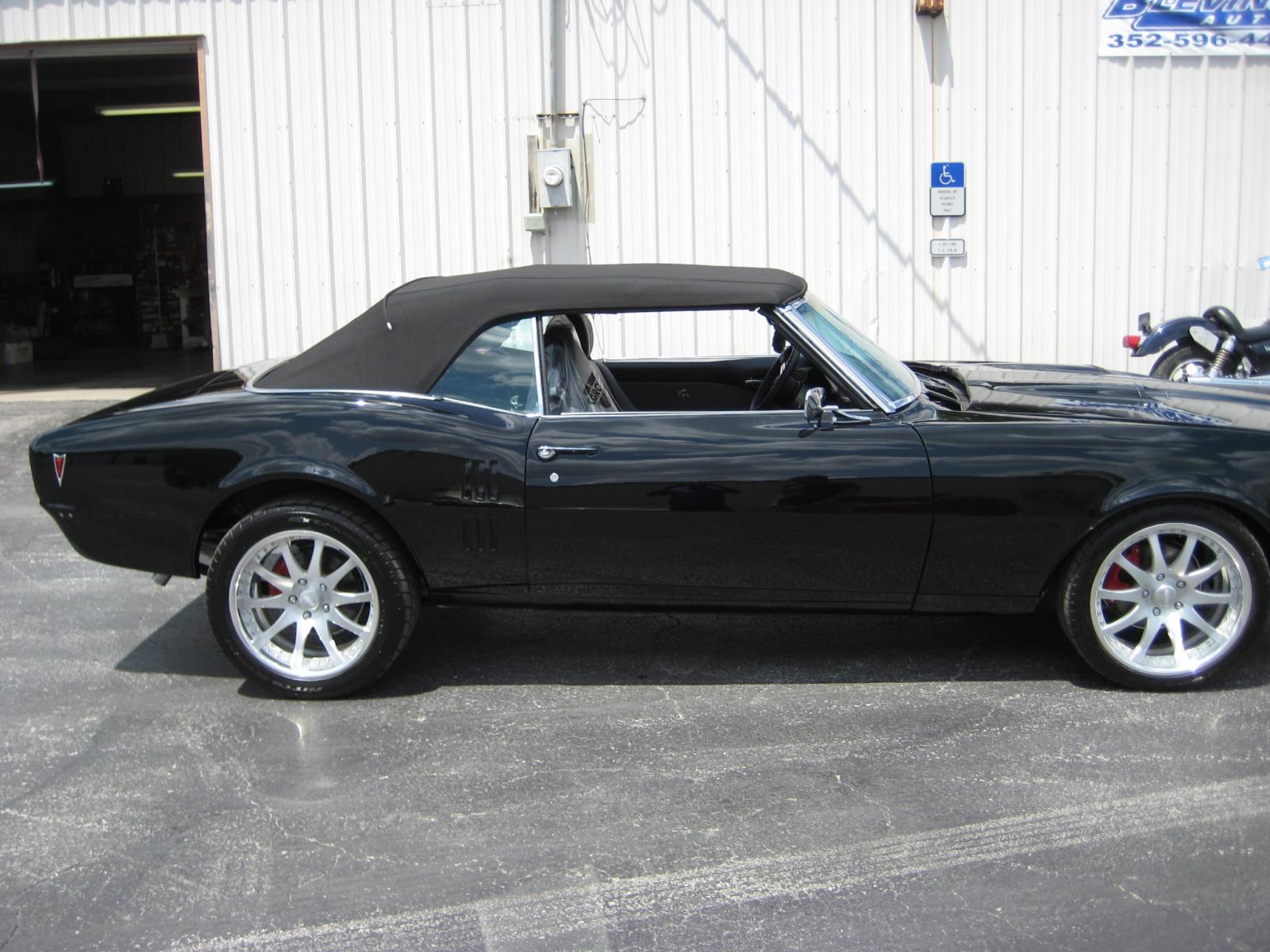

      I really like the look of the 3 inch drop, but I would raise it up an inch if it would make a difference. Will post up pics in a minute

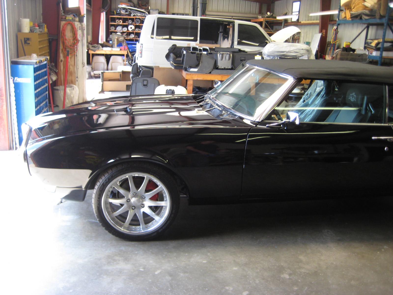

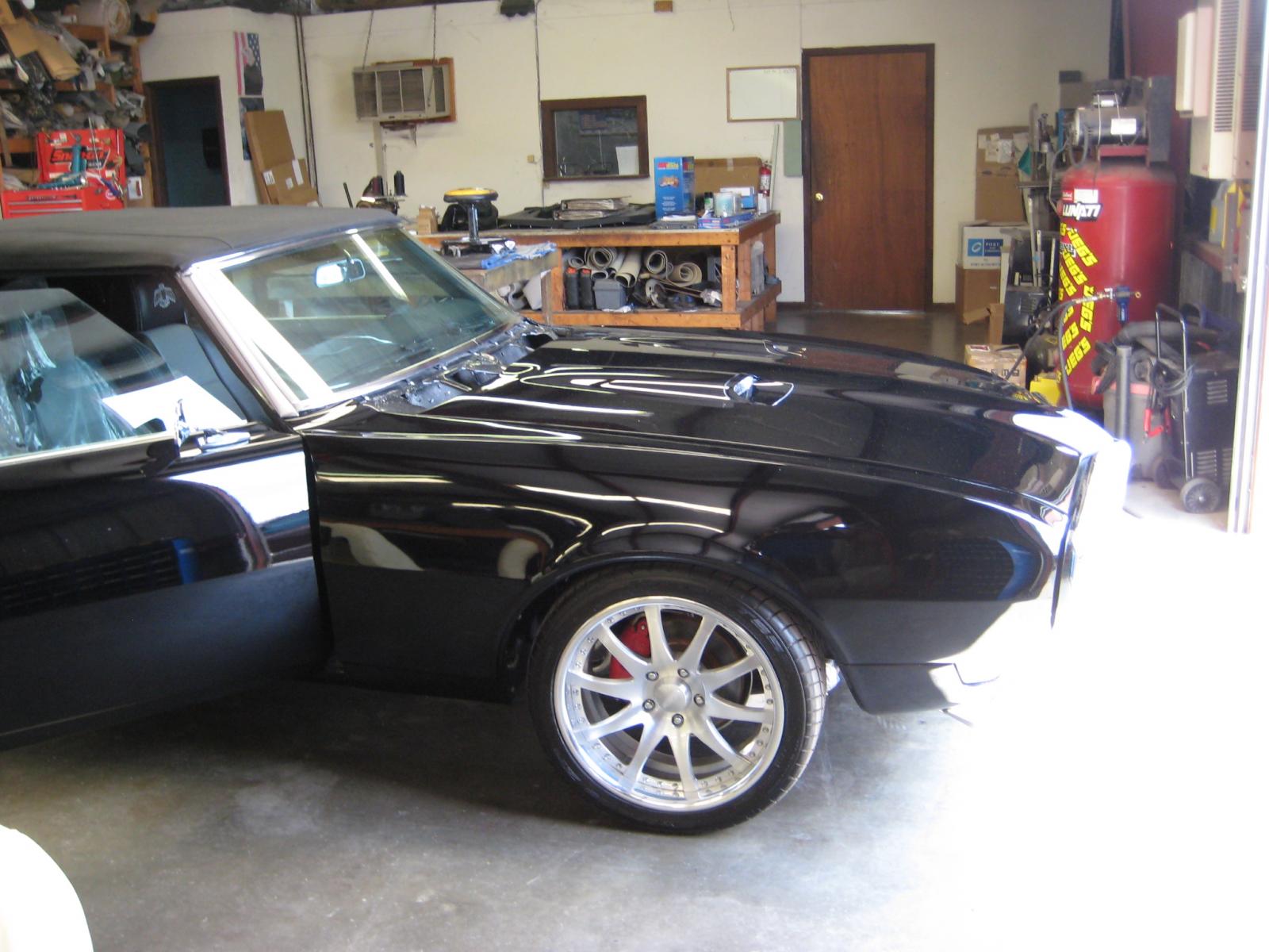

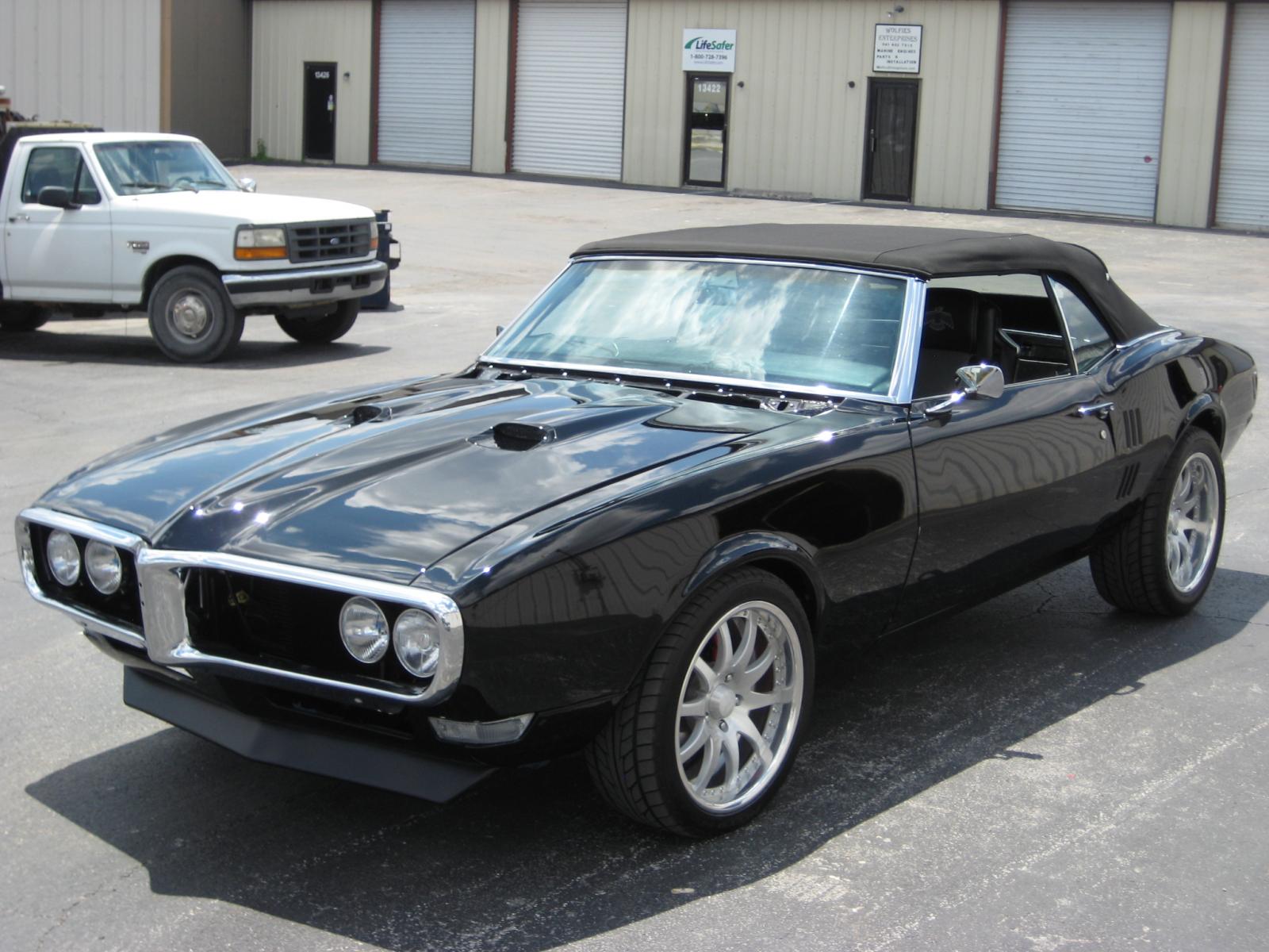

Size:  224.4 KBName:  dirtybird (7).jpg
Size:  214.8 KBName:  dirtybird (5).jpg
Size:  212.7 KBName:  dirtybird (4).jpg
Size:  183.0 KBName:  dirtybird.jpg
      Oct 2009
      New Derry, PA
      1,265
      I think I'd work on the camber curve (which needs help anyway). The "G mod" or tall upper ball joints will help the top of the tire move IN under compression, so you might kill two birds (no pun intended) with one stone...without spending a ton of money.
