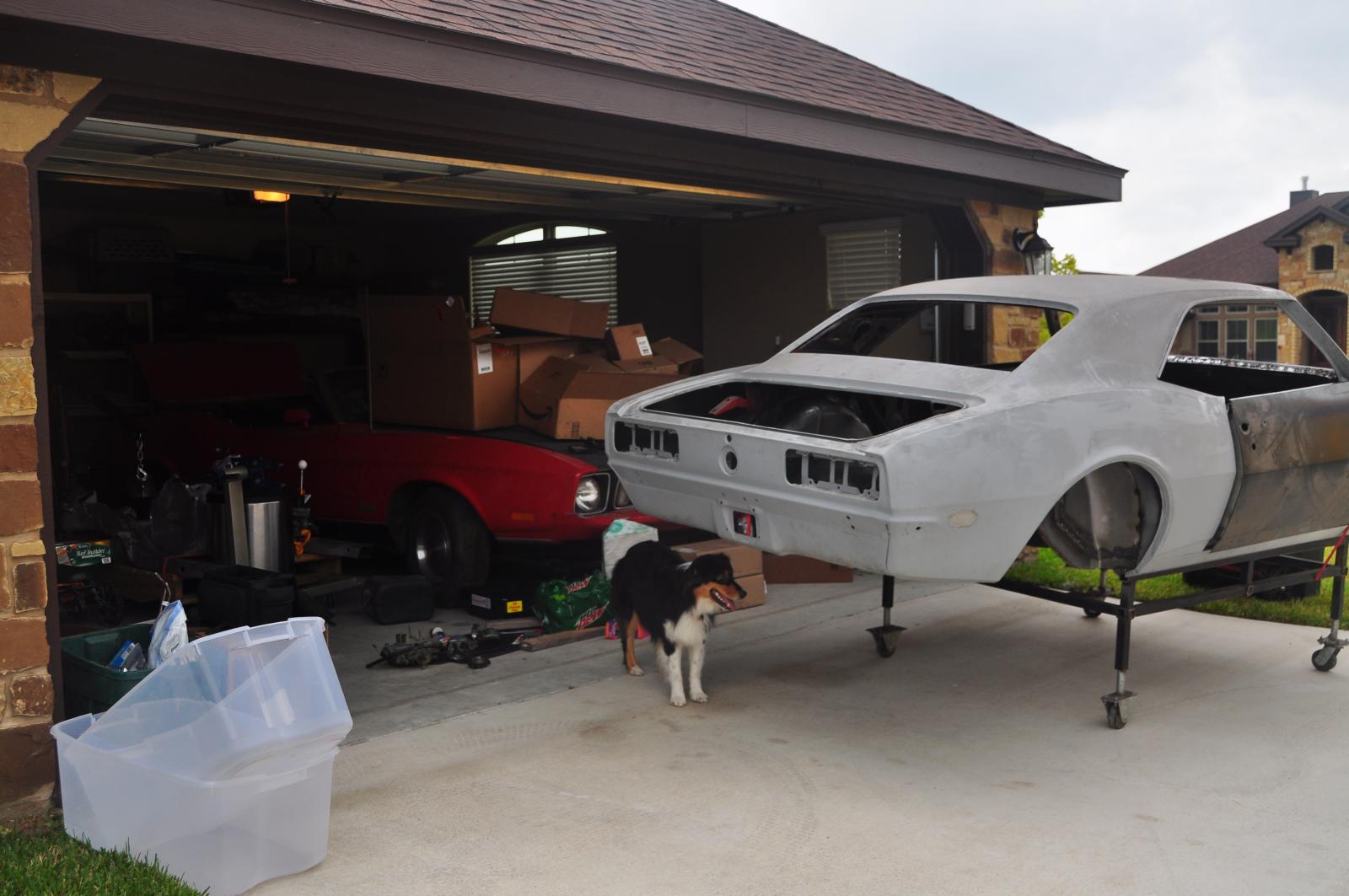

      Now... For the fun part... all of this needs to fit in that truck....
Size:  181.5 KBName:  DSC_7858.jpg
Size:  136.3 KBName:  DSC_7859.jpg
      Somehow, it all made it in!

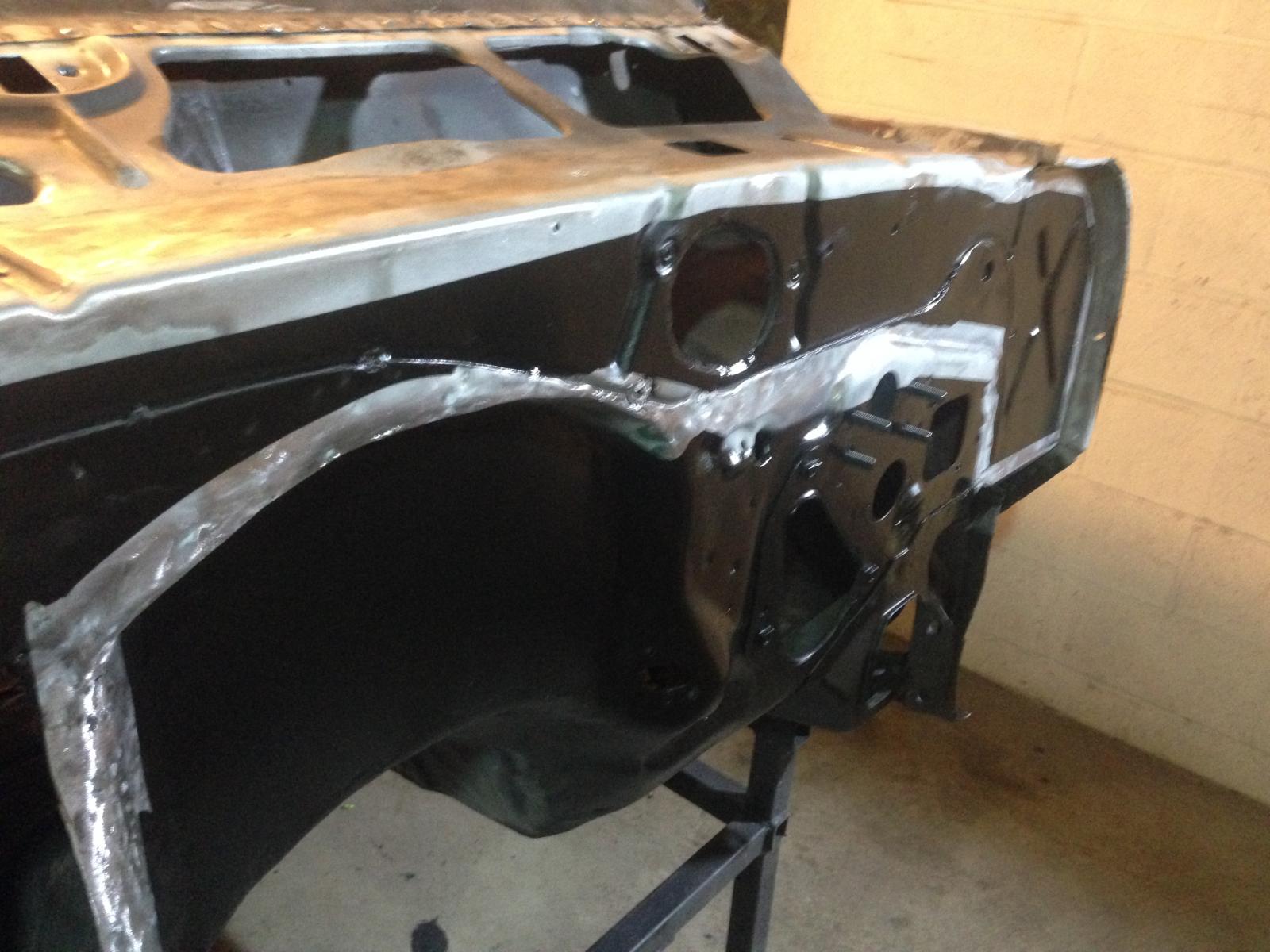

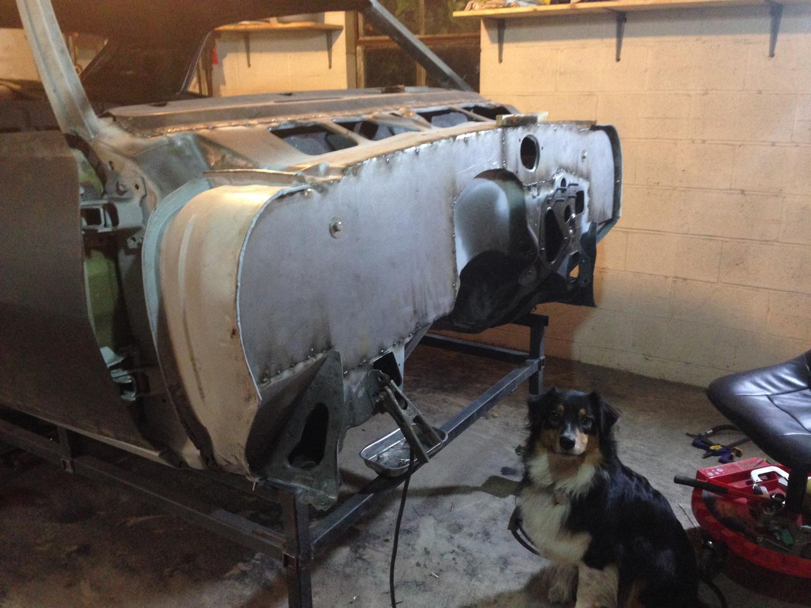

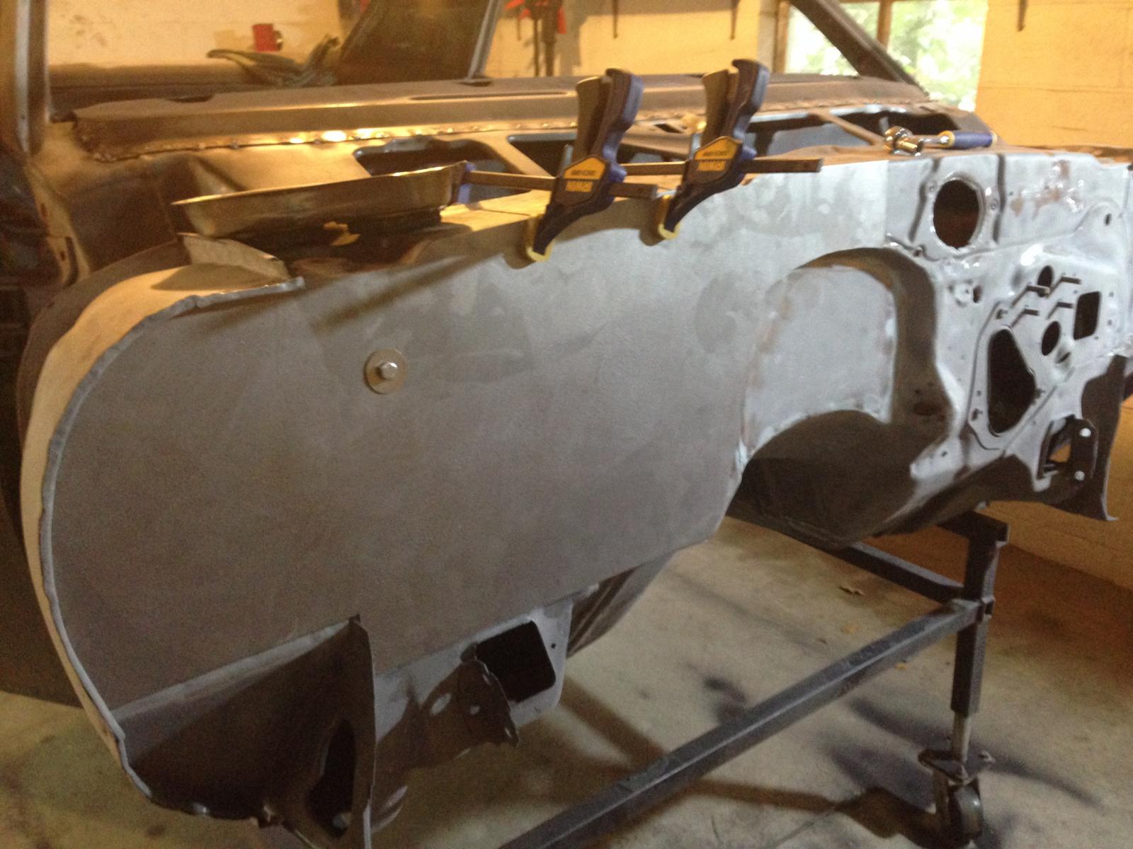

      Made it to GA the next day and the few weeks after that consisted of getting the shop put together, my sister in laws wedding, and finally got back to work on the car. I cleaned up the welds on the underbody to get it ready for epoxy priming and then went to work on the firewall. It needed a lot of work. The previous owner was using it to teach his son some fabrication. It wasn't bad, but I had to cut some areas out and start over and do a lot of cleaning it up (made a lot of friends in the new neighborhood with all the hammer and dolly work), evening it out, and making it all square before I could do the work to smooth it out.
      You can see some of the before pictures earlier in the thread.
      It took a lot of measuring, test fitting, and trimming a little at a time to get it to fit just right.
      After, metal work was done, I sanded/blasted everything down and using two inch masking tape covered the areas I would have to weld to before spraying epoxy primer over the areas that would be covered. The bare metal areas I used a weld through primer
Size:  185.6 KBName:  photo 2.jpg
Size:  122.3 KBName:  photo 3.jpg

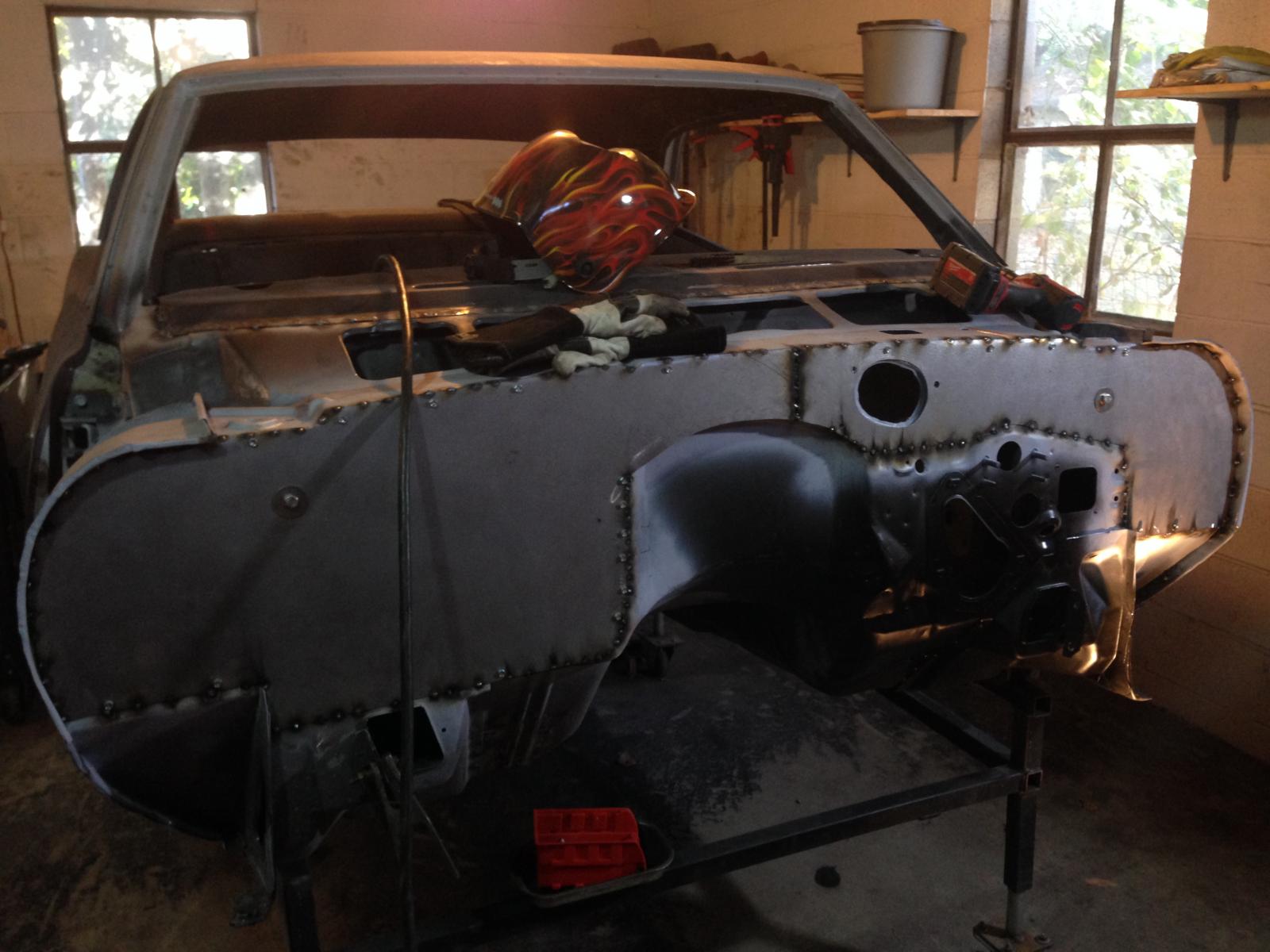

      A whole lot of tack welds every 8 inches all the way around and around.
      This is where I finished up for tonight, still got to finish welding but I think I'll get that done tomorrow night after work.
      I couldn't of done it all in a weekend without her help. Anyone know if they make welding masks for dogs? haha

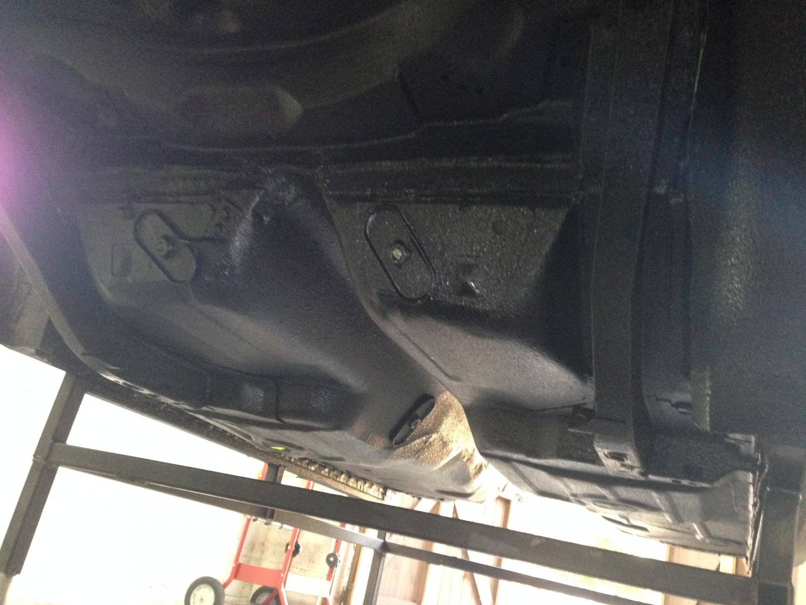

      Then I went to work to get the underbody of the car done. Got all the old gunk and undercoating crap off and of course found a few other small rust areas that needed addressing but all in all it cleaned up well. I covered it with two coats of SPI epoxy followed by SPI bedliner.
      I meant to take pics after I finished prepping the underbody but completely forgot so these are the best I got. I had to remove the pinion snubber in order for the ridetech suspension to fit as well as "gently massage" the ribbed area of the floorpan to clearance the upper bar.
      Name:  photo 1 (2).jpg
Size:  194.7 KBName:  photo (2).jpg
Size:  215.9 KBName:  SPI Bedliner.jpg

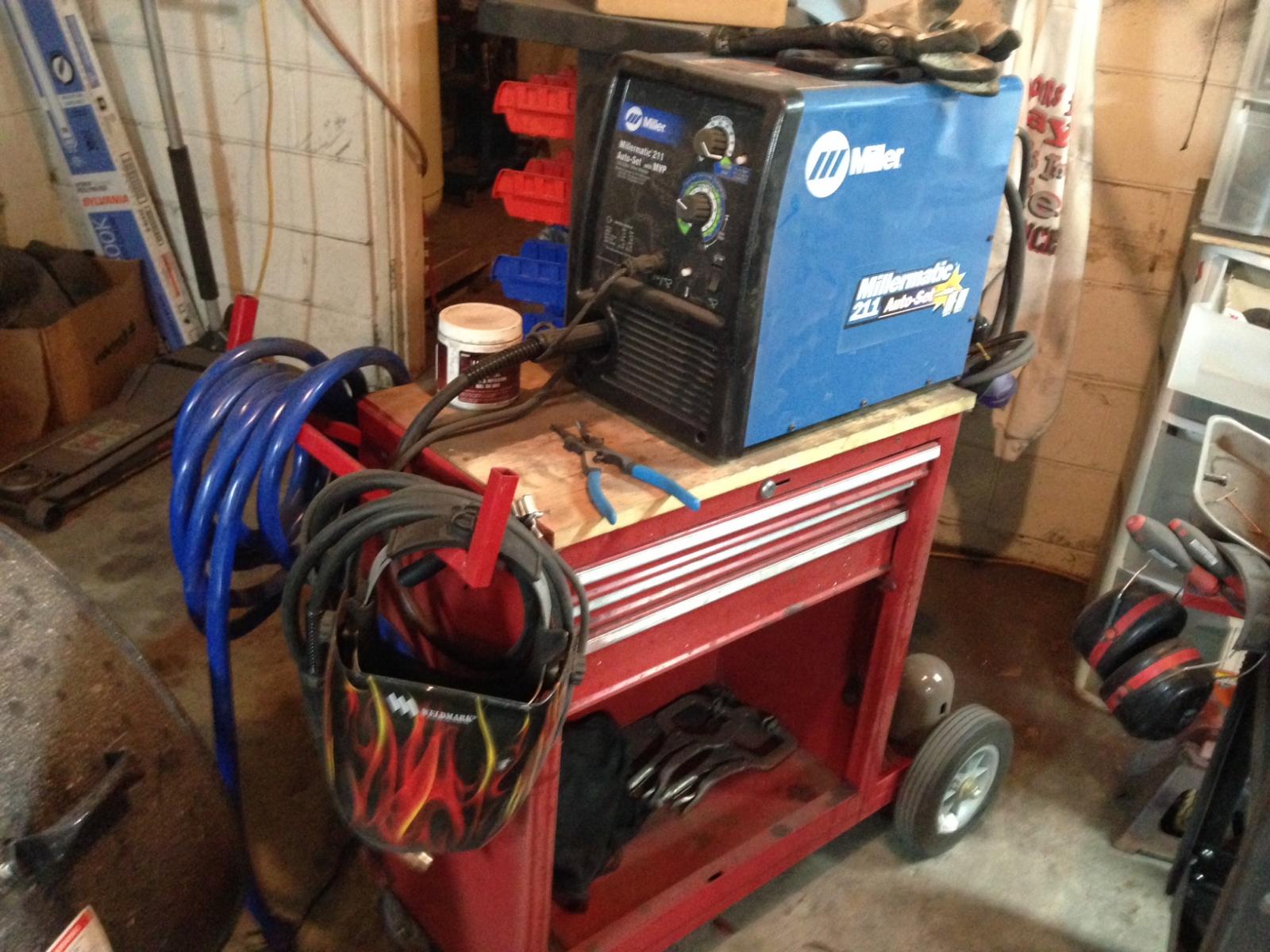

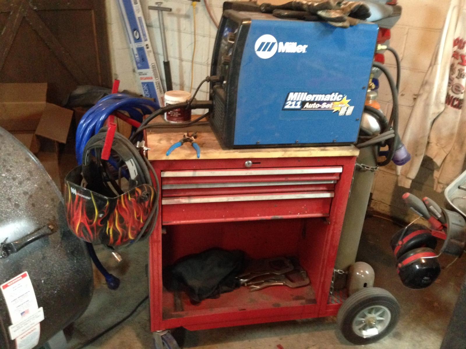

      My wife got me an awesome new welder for Xmas, my first project was converting this old tool box into a pretty slick welding cart.
      Name:  photo 1 (1).jpg
Size:  229.5 KB Name:  photo 2 (1).jpg

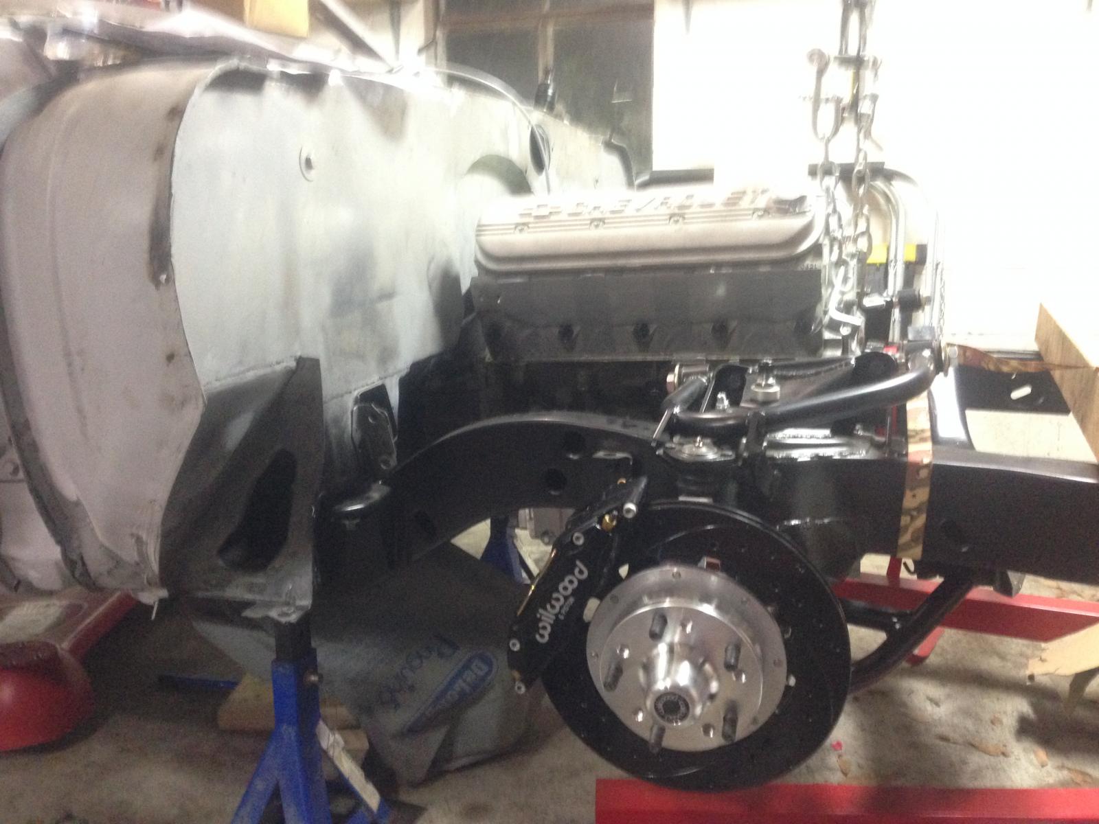

      Went to work on front suspension. Didn't realize the ridetech spindles came uncoated so I painted them a PPG silver metalic

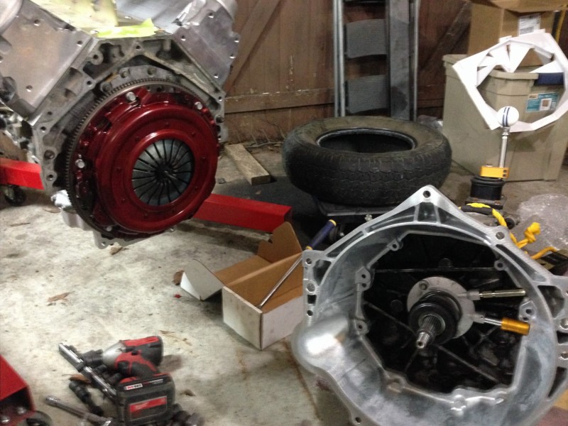

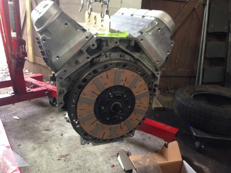

      Time to marry the LS2 and T56
      Pilot bearing in... Flexplate on, progressively torqued to 74lbs. Used new factory bolts.
      Diamond Stage 2 clutch on and aligned...Name:  clutch on.jpg
      Pressure plate on and progressivly torqued to 52lbs with red loctite.
      Name:  pressure plate.jpg
      Bellhousing bolts torqued to 36lbs and the motor and trans are in
    13. #53
      Oct 2010
      Killeen, TX
      106

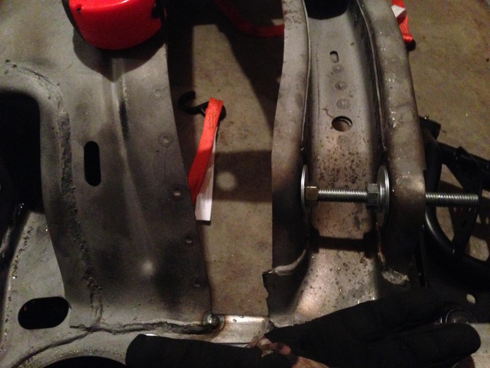

      Small issue took about a week to figure out. The engine is square to the frame and level. but for whatever reason the transmission is tilted (Clocked counterclockwise).... It will not sit flush on the ats transmission mount which is perfectly level... I have finagled the engine every which way but pulled my hair out trying to get the trans level and the motor... I ended up pulling the motor and separating the trans just to check the dowels but everything checked out. even out of the car it was obvious the trans was about 3.5 degrees off of the motor. I asked around a lot and found out it is a fairly common issue and not a big deal. I wanted to trans mount to be flush with the crossmember so I used a 3.5 degree pinion shim and it worked perfectly.
      Heres what I mean:
      Name:  trans mount off.jpg
      Luckily I had a lot of help figuring it out.

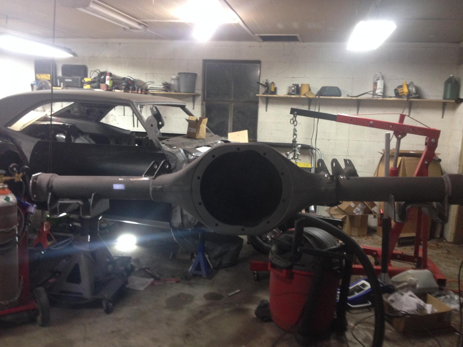

      Got all the rear suspension in place, set the pinion angle, and centered the axle and then welded on the top arm mounts.
      Name:  axle centered pinion set.jpg
      Name:  mounts trimmed to fit 9 inch.jpg
      Name:  welding mounts on.jpg

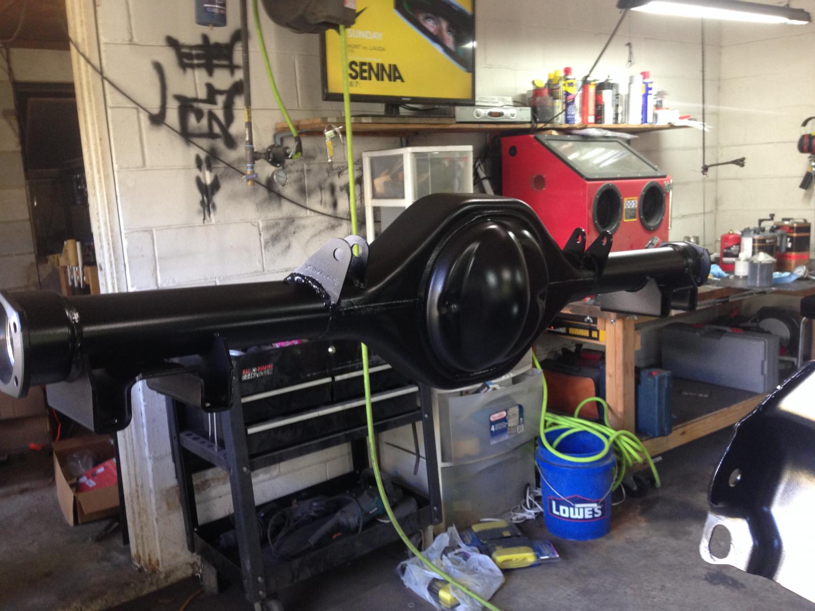

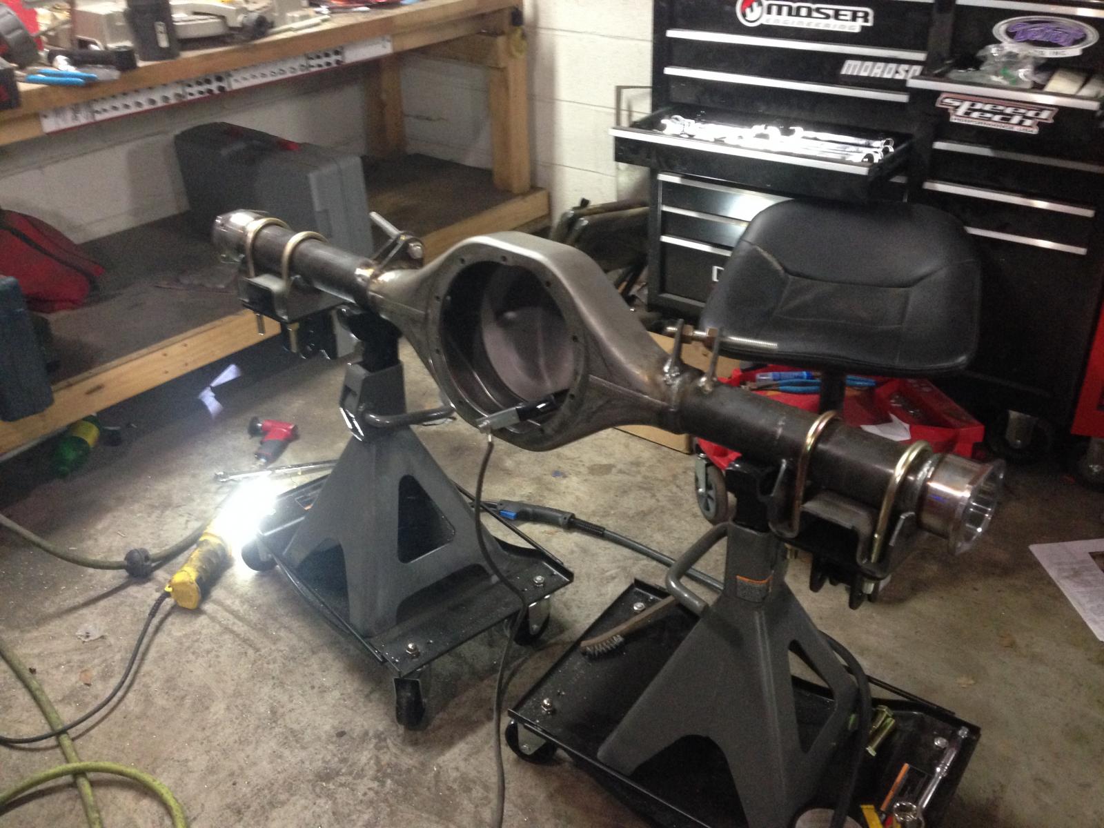

      I completely installed all the rear suspension one more time just to make sure it all still lined up, then pulled the axle housing... blasted and painted... I used 2 coats of SPI epoxy, followed by eastwoods 2k Ceramic chassis black. I hadn't sprayed the chassis black before but it shot just like epoxy out of a 1.5 fluid tip and laid down real nice. I've heard it is pretty durable and I liked the idea of touch ups down the road. Hopefully, the third member arrives on time Monday and I can button up the rear next week.
Size:  167.7 KBName:  ready for primer.jpg
Size:  165.4 KBName:  painted.jpg
Size:  165.7 KBName:  photo 1.jpg
Size:  196.6 KBName:  photo 2.jpg

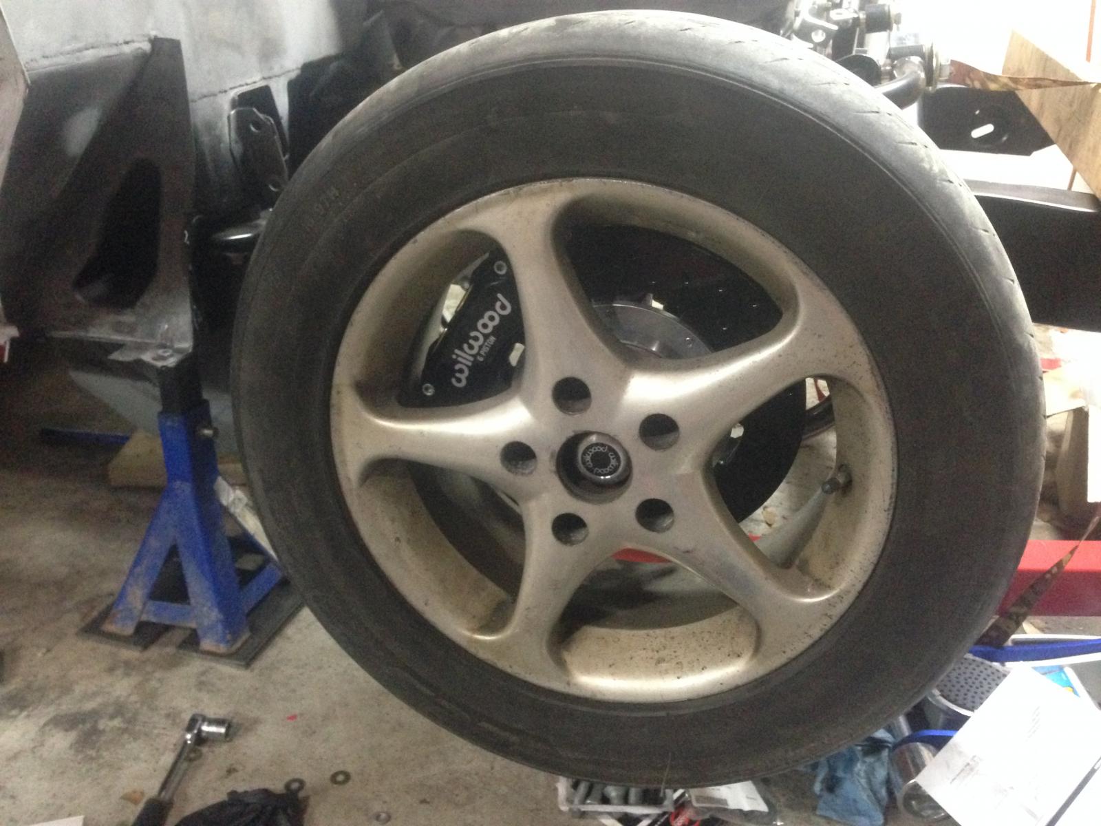

      Front brakes on! these things are sexy... I love finally putting new parts on!!! Especially when they don't require days of cutting, welding, and grinding...
      Half way to a roller, got these wheels from a local pick and pull for cheap so I have something to push the car onto the trailer with.

      Well, the third member did not arrive today but I decided to get the axle housing and suspension installed in the car so I was still productive. But first I finally found my camera so I took some better pics of the ridetech cradle welded in place since I had a few pm's about the truck bed liner undercoating and how it looked.
