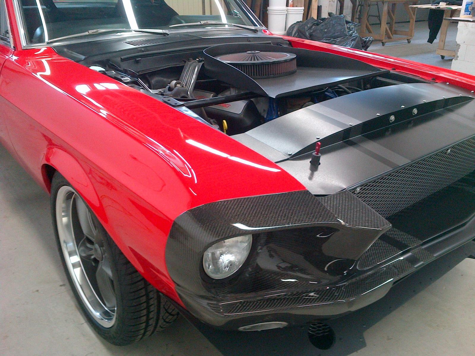

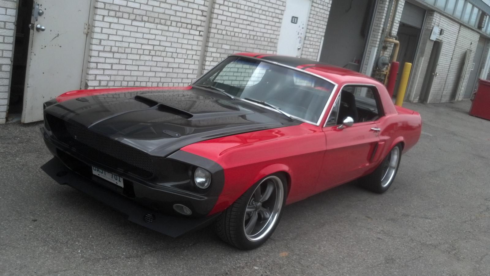

      My 68 mustang coupe
      New to this world of computers. Gonna make an effort cause I like what I see on this site. Wondering if there are any events that a new commer might attend in the Toronto Canada area. Looking for an excuse to bring the car out. Here are some pics.

      Car was built to a transam look six years ago but this winter i made a lot of changes. I got my hands on a prototype 67 shelby carbon fiber hood, nose piece and a carbon fiber California Special rear lid. That got the new look going. Dropprd the front end 2.5" and put in the new CPP suspension. 2" drop in back. Rim and rubber are now 18" (from 15" ) with 245 in front and 295 in back. Manual disc breaks on all four corners. Shortened 8.8 to accommodate the 9.5" rims. Running a 351 SVO create motor married to a T-5 and a 355 gear. Thanx for the interest!

      Quote Originally Posted by Angelo View Post
      Dropprd the front end 2.5" and put in the new CPP suspension. 2" drop in back. Rim and rubber are now 18" with 245 in front and 295 in back. Shortened 8.8 to accommodate the 9.5" rims!
      How much did you shorten rear? If you used a 275 tire would you have to narrow? Thanks for input...oh & NICE CAR!
      May 2012
      412
      Hey Big Eddie, It's more about the rim, in this case, than the rear end. Reason for this is because the rear end was originally shortened for another set of rim and rubber and with the offset of these new 18's, i had to use spacers to get the rims off the inner wheel wells. Now that you asked, I'm thinking the stock length could have been close to working just fine. I really just wanted to centre 11.5" of rubber with deep dish rims into the rear quarter and was prepared to adjust the rear axles to do it. The rims are the Boss 338's i believe . 275's will easily fit, provided you have the proper rim offset.

      Interstesting choice of body modifications, turned out really nice.
      Did you fabricate the front spoiler, or is that off the shelf?
      Welcome!
      May 2012
      412
      Made it out of aluminum - after my fourth wood template. Put in functional break cooling ducts. Was always into the race look and love well placed spoilers but its kind of touchy with the 68 body style so thanx for the compliment.

      The wheel and tire fitment and ride height look spot on. Sounds like an fantastic streetcar with the combination you have.
