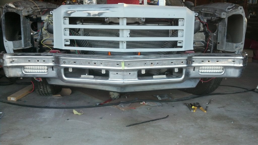

      I cut 3 inches off the blankets. Flush and tuck the front bumper. I just put day running lights/turn signals in.

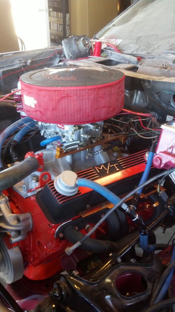

      Motor back in

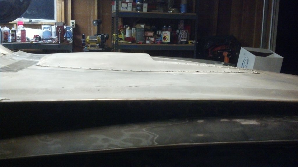

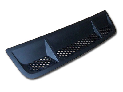

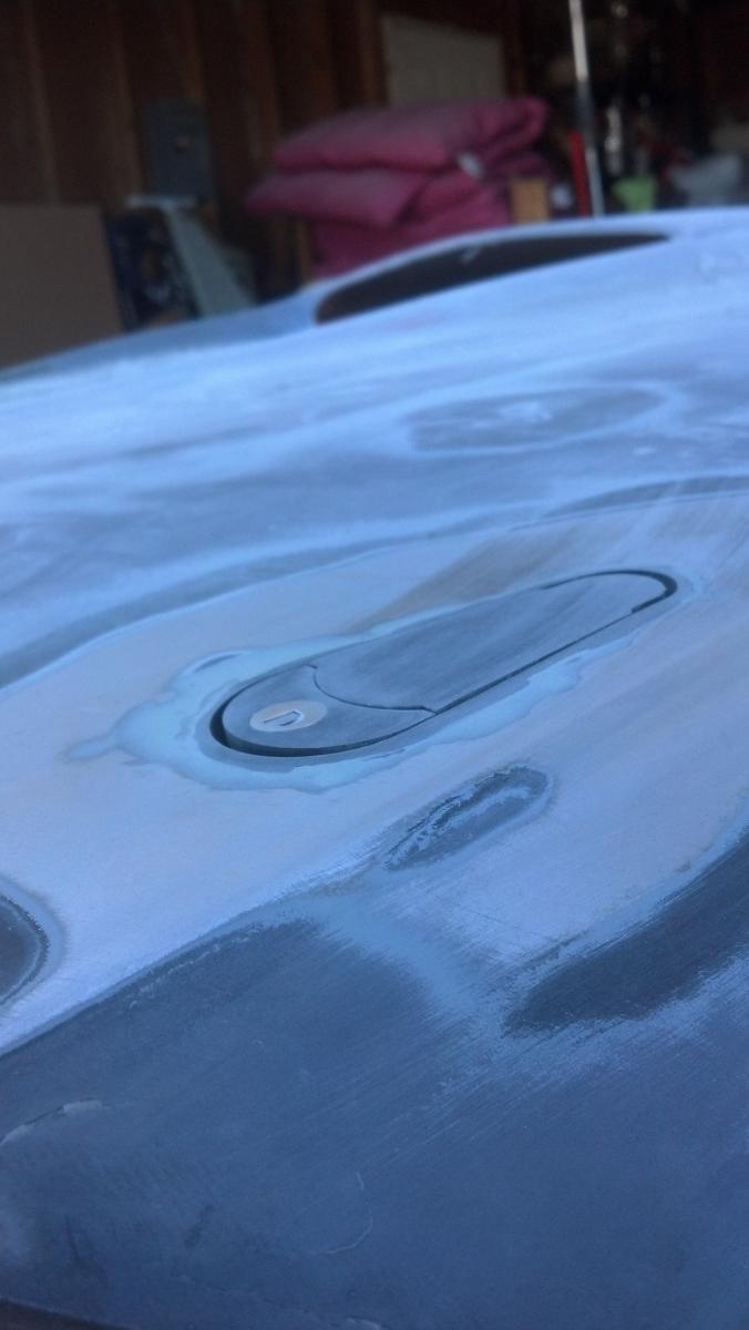

      I'm going use the gt500 vent for the cowl vent.
      Any ideas or where to get a closeout panel?
      I'm heading up to Laramie, WY for school at Wyo Tech.
      MD
      232
      I installed a cowl hood once with rivits and then glassed over the seam and it cracked within a year. I don't know if I didn't scuff up the metal hood enough, but they have different rates of thermal expansion so when the sun beats down on it, they want to come apart. My flange was pretty thick though. If I were to try it again, I'd probably use some kind of 2 part epoxy like what they use to glue body panels on. Good luck though, cool project!
