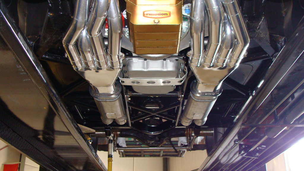

      Here are my first mufflers to go behind those headers. Two 5" spintechs with oval in and out.
      Splitting into four 3 1/2" with more to follow...

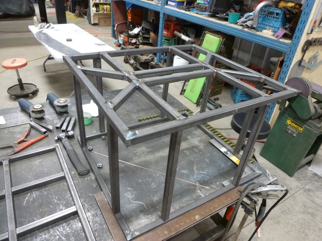

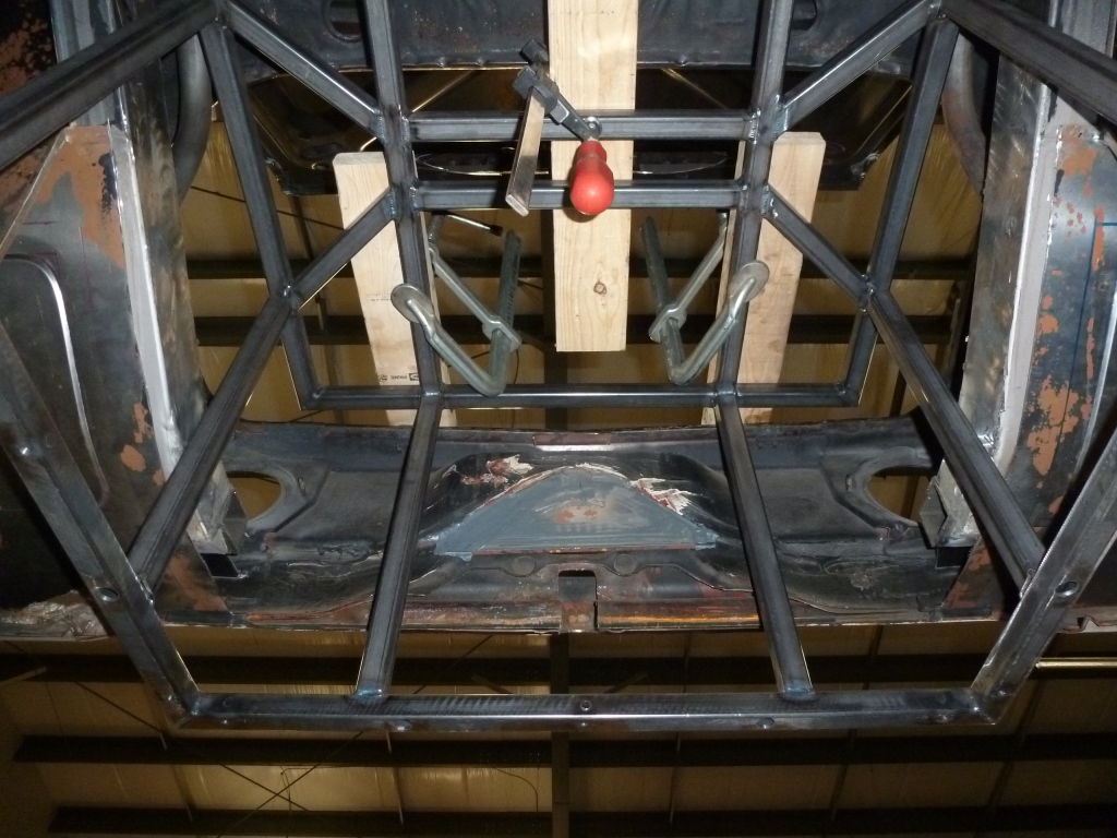

      I also added in an approximately 45 gallon fuel cell custom made by fuel safe complete with bladder, foam, surge tank, and dual A1000 Aeromotive pumps. It was too big to go in from above so the 'support cage' is actually built above it and it mounts from below.
      looking up...
      the crash bars...
      and the cell itself

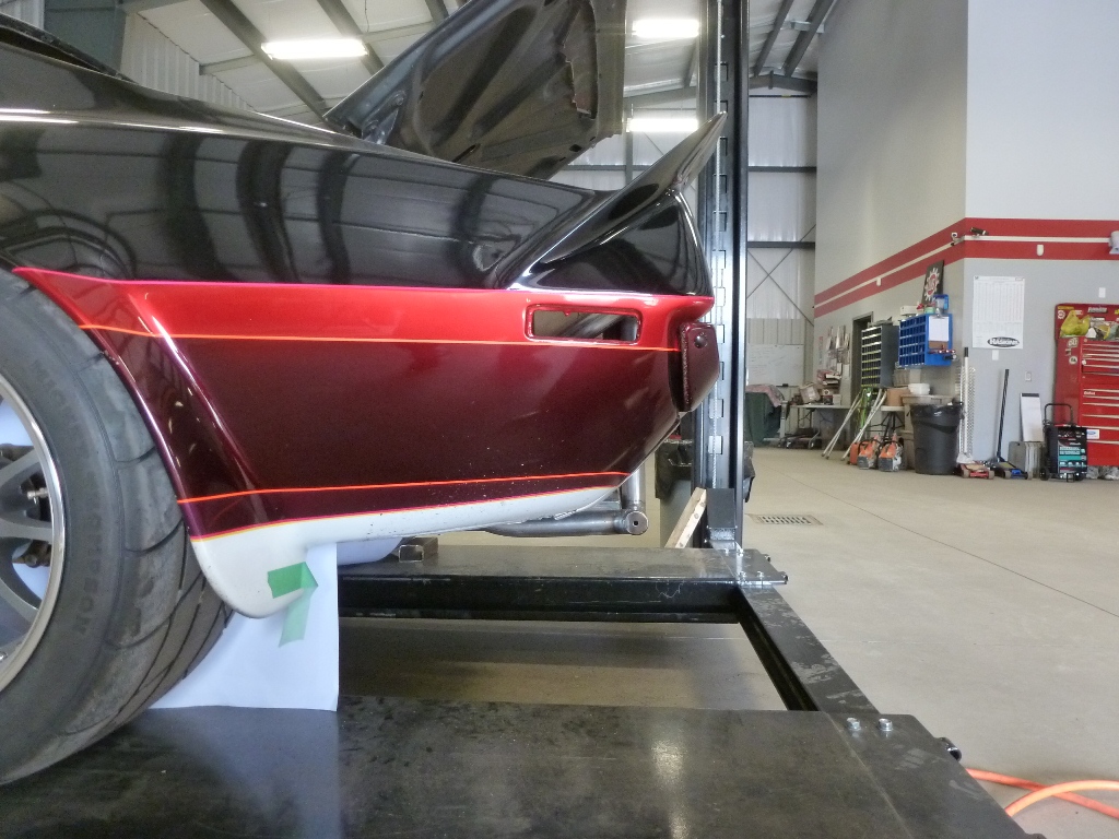

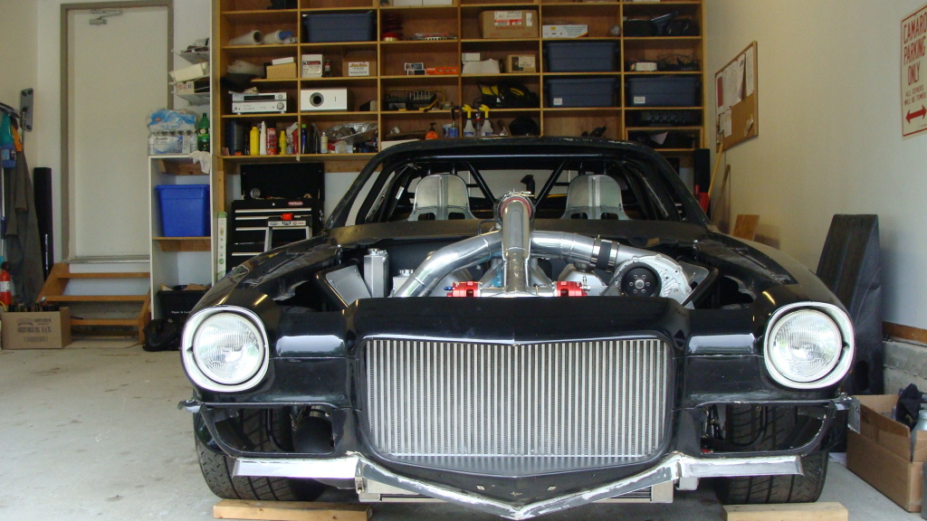

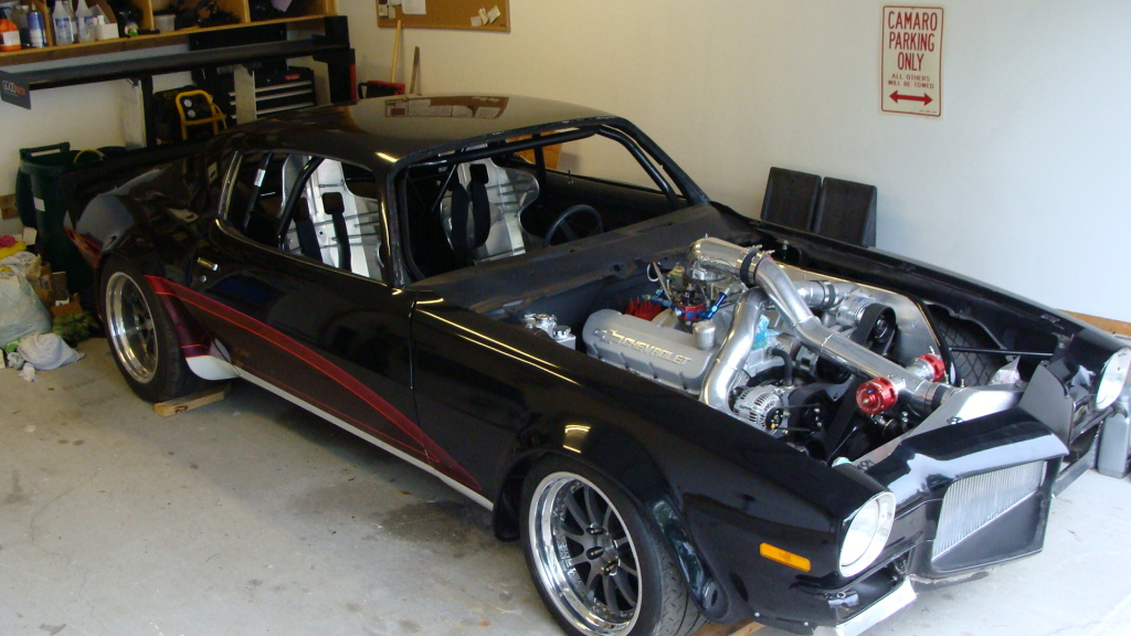

      A few more pictures now that I got it home. It needs a good dusting still after being at the fab shop so long.
