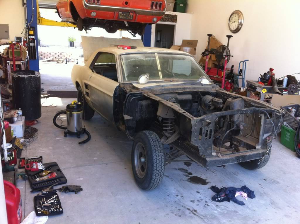

      After finishing my carbed ls1/t56 1969 camaro i took a break and decided to start a new project.

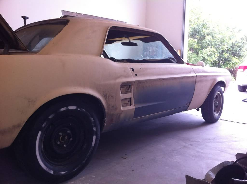

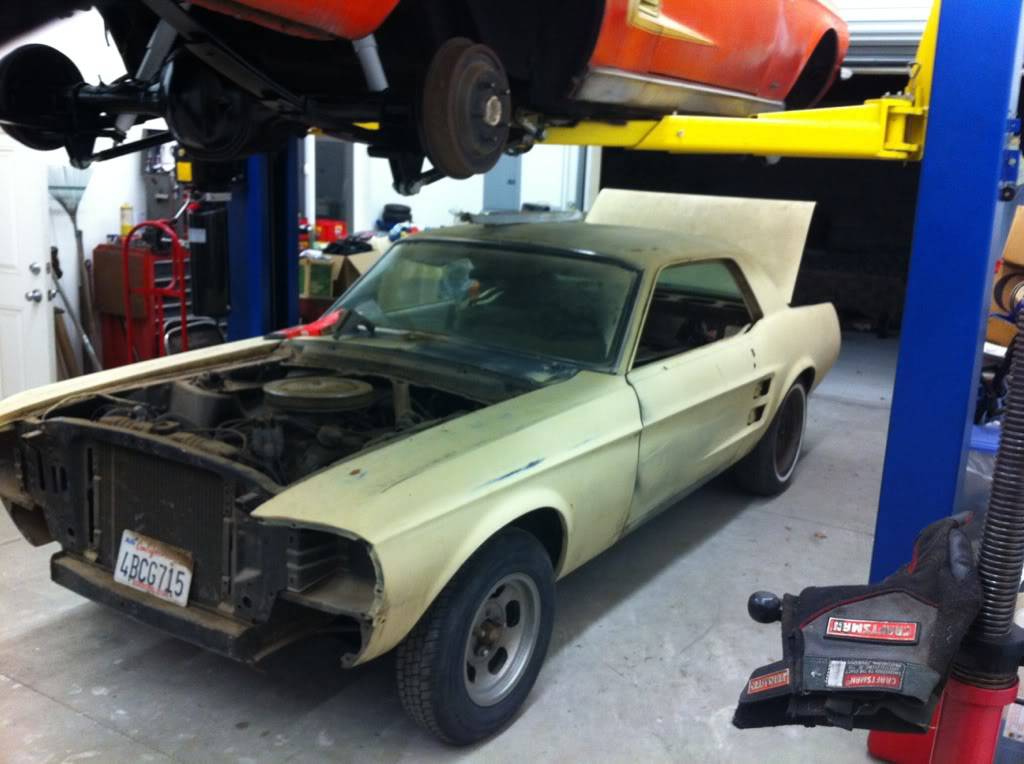

      call me crazy but i am going to swap a 5.3/th400 into this 1967 mustang and keep its rear steering. plan is to run a front sump pan and weld up some custom mounts. it will be a complete budget build... so i think lol. i am still gathering parts for the swap but i dont think i did to bad on the chassis.

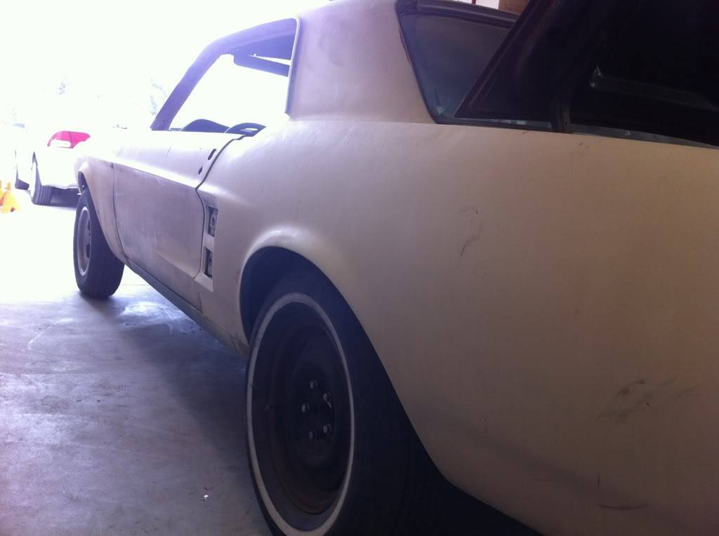

      the previous owner started the body work on it. It is amazingly straight, very little bondo. the car still sports the original doors and fenders. it was originally an A-code 4bbl small block car and has deluxe interior. The front floor pans are shot from carpet and being stored outside. I am going to perfect my welding and replace them from the seat mounts to the toe boards. more pictures to come.

      Sold the crusty old 289 2bbl engine and c4 trans today for $350. glad its gone, now i have room in the corner of the shop for my 5.3 or 6.0 engine.
      Car costs so far $1450

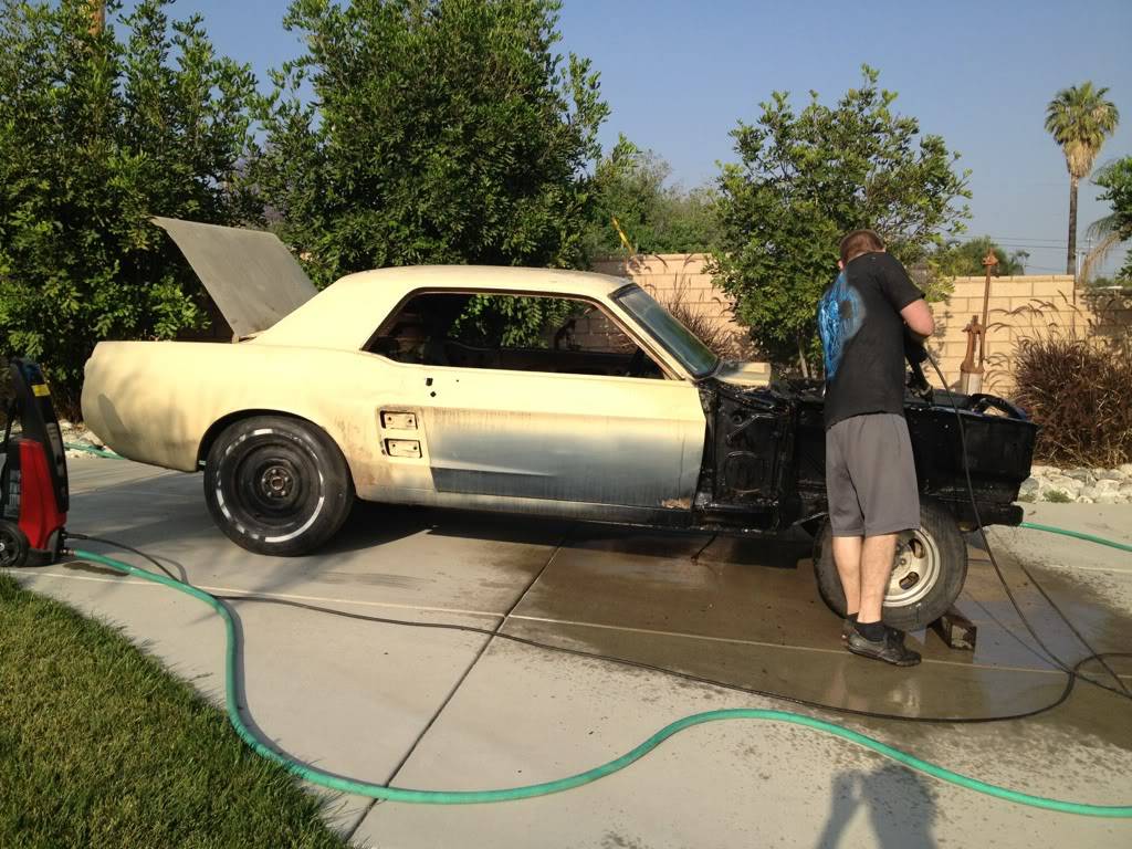

      No new updates other than pressure washing the front end and taking off the window stainless. man what a bitch that was. the previous owner must have had a leak in his windshield because all of the stainless was packed full of RTV! i couldent get the clips to bend to release the trim. had to muscle most of it out. its not too mangled.

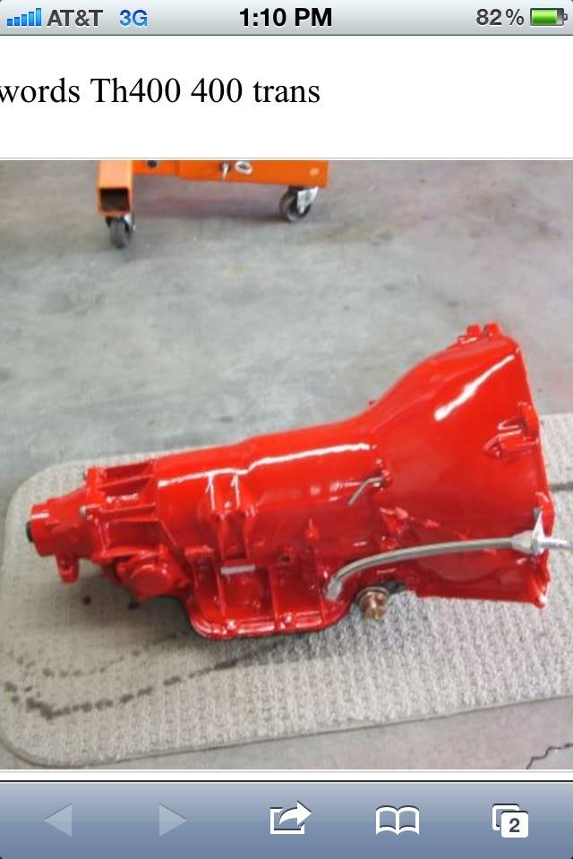

      anyway! a guy answered my craigslist reply just as i went to lunch today. i picked up a fresh TH400 out of this hot rod. The guy ended up going with a larger 500 big block and needed a more built TH400.
      its alot of RED but i can handle it.

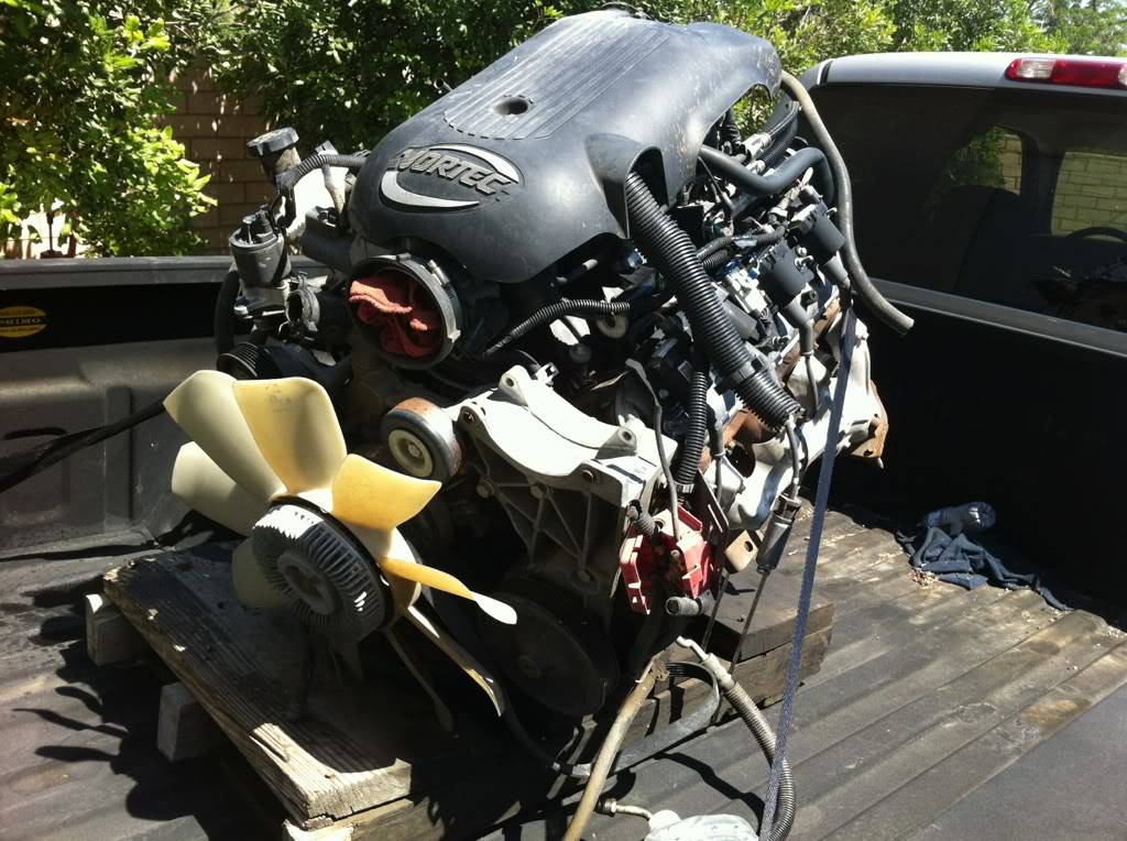

      scored a 5.3 today! paid $648 for the complete pullout with the gas pedal and the tac module.

      Nice, 5.3 is definitely where it's at. I always wanted to build an aluminum dart block sbf, but I can pick up two all aluminum l33s (aluminum 5.3s) for the price of the block alone! LS it is.

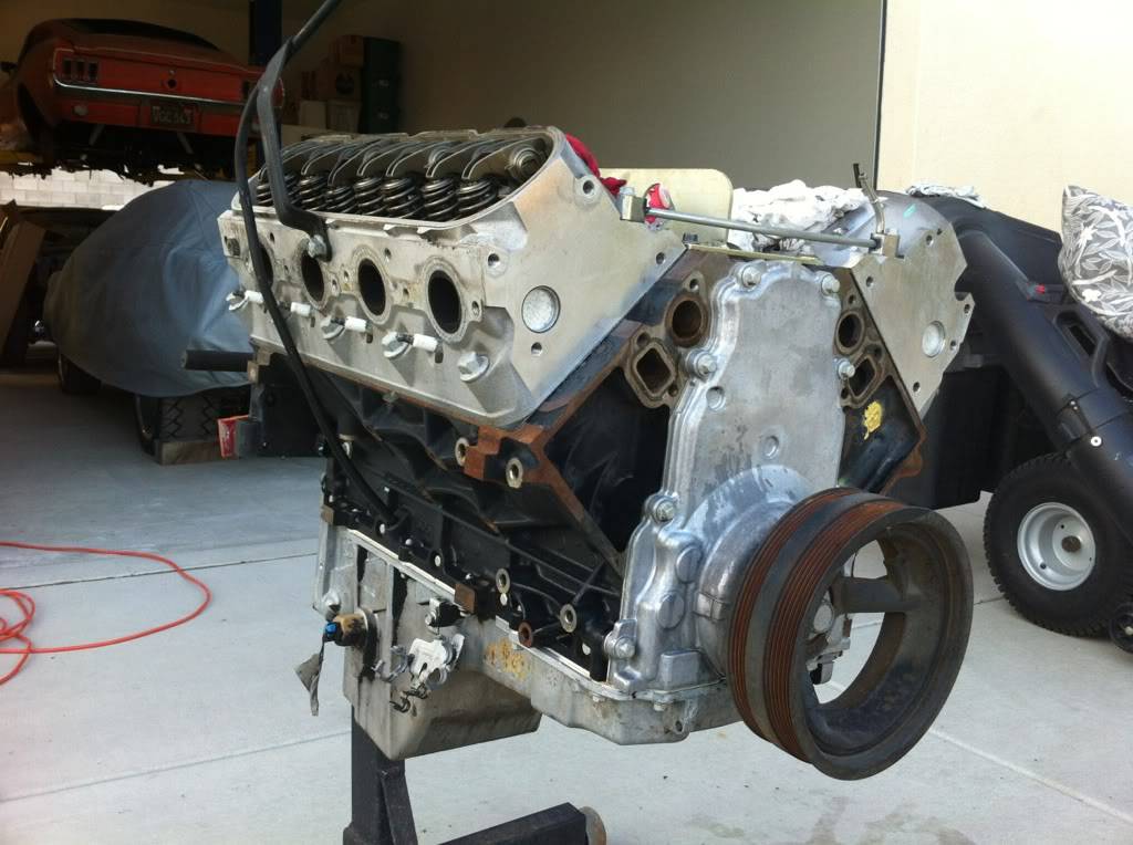

      Pressure washed the block and tore it down. I'm going to leave it as is, I don't want to spend the money on gaskets and bolts.
