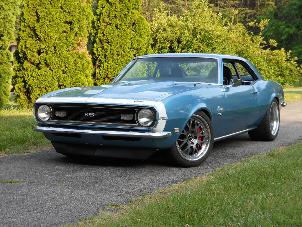

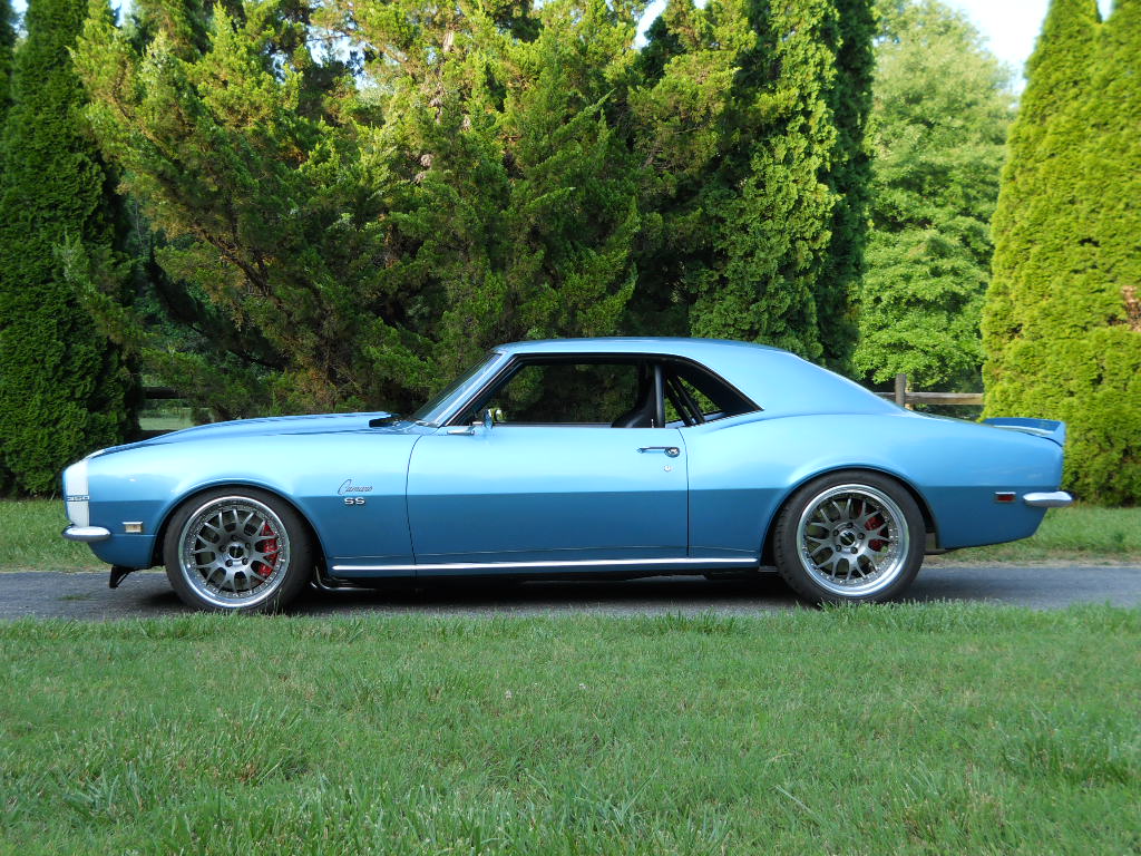

      I have 18's all around on mine....18x8 frt and 18x10 rear...ordered direct from Boze Alloys, lead time was only 3 weeks

      Im going with Boze wheels Just haven't picked the one yet. Just when I think I have made up my mind on a wheel, I see a different wheel I like and Im back to square one. Very sweet car you have Steve are those the injected wheel from Boze? Did you mini tub if not what did you go with for a back space? I didn't tub my car, as I said just lowered it a bit.

      You are correct, those are Boze "injected" wheels...I did not tub the car, but the rear lips are rolled, and the rear backspace is 5.75"....
      Good luck with you're wheel search....I can tell you that selecting wheels was the hardest part for me...Just for the reasons you mentioned....too many choices and too much $$$...When you find the wheel you want, you'll know....

      Wow, your car looks awesome! What size tires are you running? What finish do you have on your wheels?

      Thanks for the compliments....Front tires are 245/40/18, rears are 275/40/18...Polished hoops with brushed satin centers....
