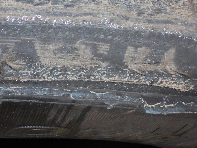

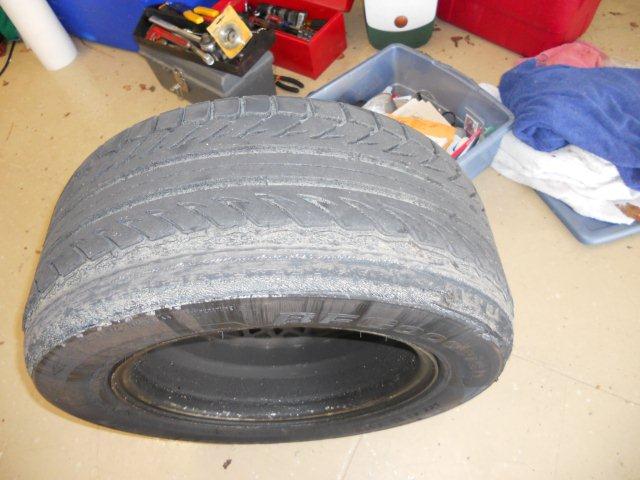

      If you are running the older versions of these be on the lookout for tread separation.
      These are the old ones (not the new Comp 2s)
      We had a Tread Separation at Big Bend Open Road Race going south and apparently ran another 105+ miles averaging 140.00 MPH with 20% of the tread on the inside of a back tire missing. On our in car video, about 12 miles in on our south run, there is a little noise and vibration that smooths out after 2-3 seconds that has to be the tire coming apart. We thought it was just a washboard patch in the road at the time.
      Because it was the inside back of a low car, it wasn't until we changed the oil that we noticed it.
      The Tires were 3 years old and were always used in back and have never touched metal. Someone told me they had two separate tread separations with different sizes of this tire, two weeks later, we had one, too.
      These Tires are W rated but appear to have design or manufacturing flaw.
      If it was a front tire that let go, It might have been my driving or fender rub, but a back tire, furthest away from the fender has to be the tire.

      Can you post a picture of the date code of the tire for me?

      Thanks for the input. The tires are down in the storage garage. I'll post pictures of the date codes tomorrow.

      What was the date code on the tire ?
      You may have bought them 2 yrs and 9 months ago , but they may be 3 or 3 1/2 years old ..
      I wouldn't punish any tire over 2 yrs old .
      My feeling is , this isn't a BFG problem , it's an age problem .

      The tire had 34 psi cold in it. It wasn't overload/overheat failure because the tire that failed was the lightest loaded shoulder on the the lightest loaded tire (inside shoulder of back tire, with 1.5" between tire & frame). I put my hand on the front tire after every run and they are warm, but not "hot".
      It wasn't a "rust" issue from water vapor, because the tire still held air and Averaged 140 mph for another 110 miles after the tread separated. The Internal air had no contact with the area of the tread that failed.
      The tires were only on the car only a couple times a year... the rest of the time it sits on "Garage tires" to avoid flat spotting, so other than asking them to go 168 mph twice a year, they have a pretty easy life.
      It was either an age issue or tire defect. the failed Tire was 3 years old with less than 1000 miles on it.
      This is a good lesson to anyone who wants to enter an open road race with a 2010 or older "new" car that still has the original tires one it.
