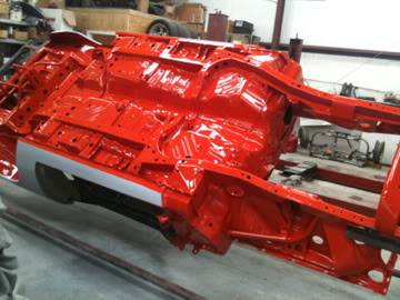

      The Shwartz chassis is a very nice piece. It depends on if your a "purist". I chose to to reinforce my 'Cuda and leave it as a unibody, but my car was a very solid rust free Cali car. If I started with the typical rusted E-body, I would have gone the Shwartz route for sure.
