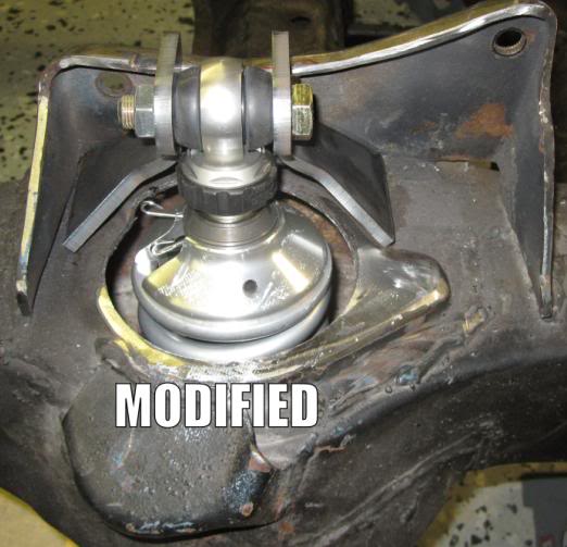

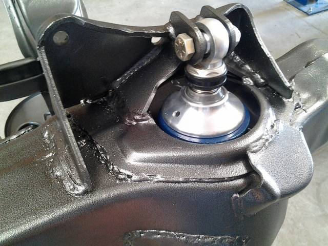

      Heres what we are offering a guy like you....
      Remove the upper shock with a cut off wheel or plasma, using a guide supplied use a 4" metal hole saw and drill through your frame for the coilover housing. Install the upper mount plates using a jig.....
      and then once the front is done we can set you up with a rear suspension too!
