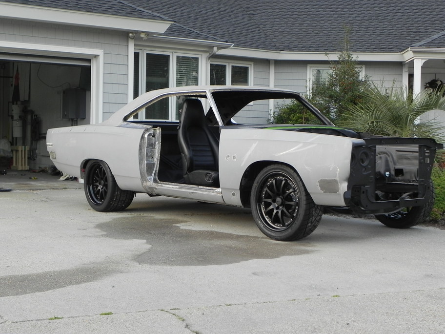

      I've got 18x8 with 4.5" backspace with a 245 on the front of my 69 runner. The car isn't completed yet but I have the full front suspension and fenders on and there is plenty of clearance I actually think I could have gone an inch wider with the same backspacing. In the rear I was going to attempt running a 10" wide rim but I ended up mini tubbing and going to a 12" wide rim, so I couldn't tell you for sure that a 9.5" would fit, but from my past measurements I think it would with the correct backspacing.

      Thanks man I appreciate the help. I think that I've foud a 9.5" will fit in the back with 5" backspace nada 285.

      You can run a 295 on the back with ease using the 5" back spacing on the rear. I run a 285 on a 9 and a 255 on a 8 on my Challenger. The B-Bodies are cavernous compared to the E-Bodies. Good luck.
