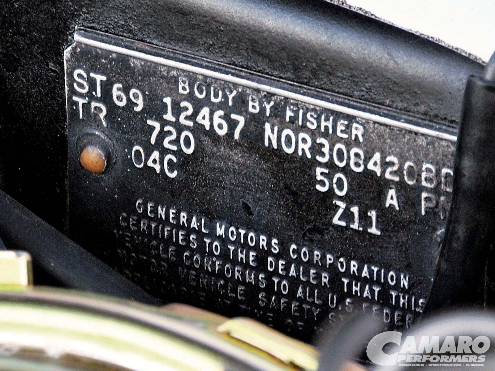

      Mark,
      As others have pointed out, the trim tag next to the master cylinder will help.
      How does the firewall look? Does it have all the original holes? Or were they all filled in?
      If you PM the info to me I can check the range of the VIN and the data on your trim tag to see if they are in the right range to see if they are correct for each other.

      Mike is completely right about the X11 tag. Check the VIN on top of the cowl and compare to the VIN tag.
