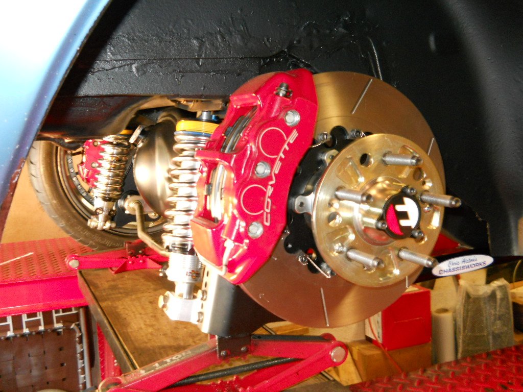

      I did roll the lip on the rear fenders but not the front. I have a DSE subframe, DSE SFCs, DSE Mini-tubs, G-link rear suspension and Moser 9" floating hub rear. The front wheels are 18x10 Forgelines with 6.9" backspace and 275s, rears are 18x12 with 5.9" backspace and 335s. I was skeptical that the fronts would fit the stock wheel wells but they have not rubbed at all.
      I would just add that I have about 1000 miles on Dust Off now and the floating hubs have been a non-issue. For anyone interested, floating hubs work just fine on the street.
