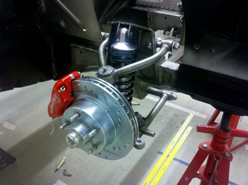

      The TCI front suspension installed.

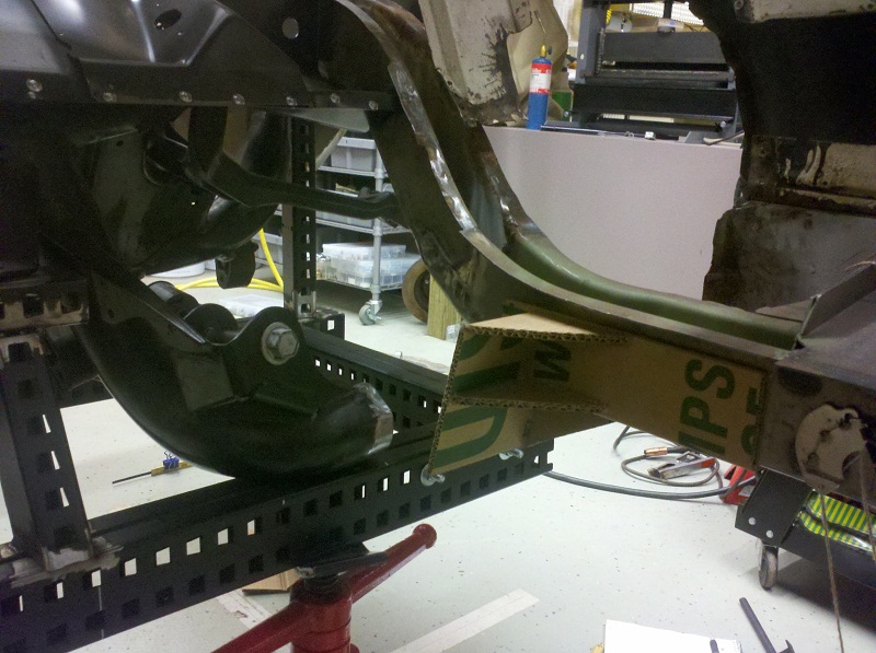

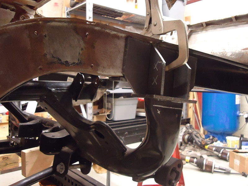

      On to the rear suspension and what has taken longer than I had hoped. I spent quite a bit of time trying to figure out exactly how I wanted the Cobra IRS to fit. Maximum Motorsports ultimately provided the most technical information that helped me position the rear end with respect to anti-squat, etc. I also decided that a hard-tail approach would be the best to eliminate those ****y stock rubber mounts. My design is to basically build brackets that will be welded to the four mount points of a modified IRS cradle. I cut all four of the stock rubber bushing mounts off and will weld these brackets to the IRS cradle itself. Those brackets will then slip over the existing Mustang rear frame rails and I’ll bolt through them. I also plan on modifying some rectangular tube steel to insert into the existing frame rails to provide additional support for the brackets. This whole process is allowing me to set the entire IRS up higher into the car, about 1.5 - 2 inches, and achieve a lower overall stance for the car without changing the suspension geometry of the control arms themselves with respect to the IRS cradle.
      I fabbed up some cardboard templates for the brackets and began cutting out my bracket pieces from ¼” plate steel (probably overkill but wanted something very rigid). The brackets will be made up of 90 degree bends wherever possible (thanks to Swag Offroad’s metal bender) and the rest of the pieces will be TIG welded together.

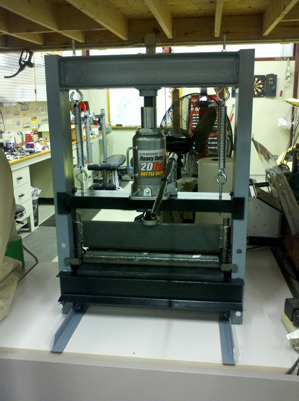

      20 ton press I built to use with Swag Offroad's metal bender

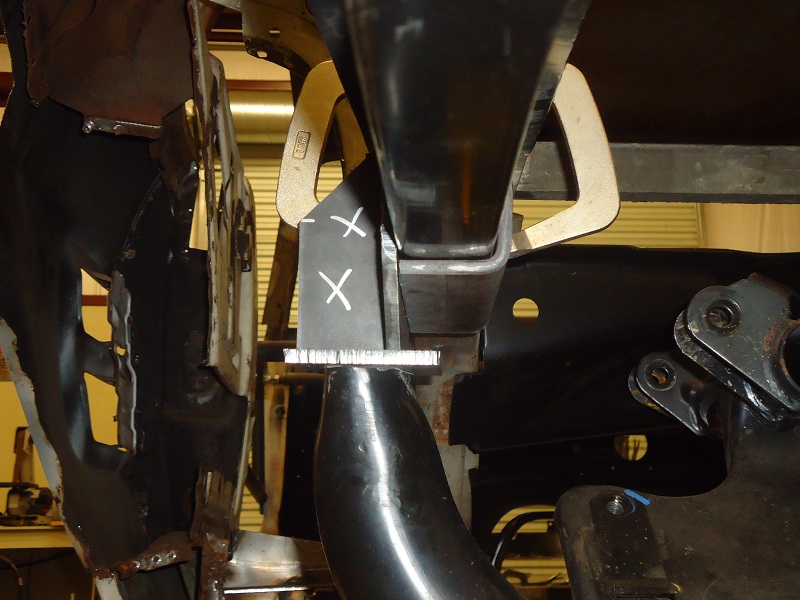

      Rear driver side bracket mocked up
      Mock up of the front bracket. I still have to cut the rubber mount off of the remaining cradle piece and TIG weld it back to the cradle. The cradle will then be welded to the bracket shown in the pic.

      I'm going to offer what is, in my opinion, constructive criticism. I hope you agree and take it that way.
      We see it a lot here where people massively overbuild parts and then attach them to sheetmetal. The rear cradle mounts that you built from what looks to be 1/4" will be welded to sheetmetal frame rails. Here are the problems I see with that:
      Welding - you'll end up with very little penetration into the 1/4" due to the fact that it has a very high thermal mass compared to the frame rails. Add to it that they're galvanized and it makes it even worse.
      Stresses - the drastic difference in rigidity b/w the 2 material thicknesses with result in a stress concentration at the welds where the frame rail material has already been weakened due to likely a lot of heat being put into it trying to connect it to the thick material.
      My recommendation is to spread the forces over a larger area with a similar thickness of material. I'd box the frame rail over a larger area with 1/8" and then build the structure out of the same. By spreading the forces over a larger area, you'll be decreasing the load and will end up with less deflection and greater strength and do it all for half (or less) of the weight. Structure is much more effective at maximizing strength and rigidity while minimizing weight.
      I hope this this is useful information. And again, I'm not saying what you're doing is wrong, I'm giving you my opinion on what I feel is a better way.

      Wes, I truly appreciate the information! It was one of my main reasons for deciding to post my thread on this forum; there's a lot of constructive feedback. Oh yeah, and after working on this car for some time and spending hours upon hours pondering whether my designs will work or not, I have a whole new respect for engineers!!!
      Anyway, You read my mind. So hopefully I can explain what's in the "chaos of space" I call my mind...I don't plan to weld the 1/4" brackets to the existing frame rails but will bolt the brackets (the mock ups don't have any holes drilled yet) with 9/16" Grade 5 or 8 bolts to the frame rails. To make the existing frame rail area stronger I was going to cut and weld from 2" x 4" rectangular 1/8" wall tube steel to fit exactly inside the frame rails, maybe several inches beyond the width of the brackets. I'll plug weld (penetrating the tube steel first and drag the weld puddle to the frame rail material) in a number of spots to secure the frame rail inserts. I was also thinking of welding in some round bushings to keep from crushing the frame rails with the brackets\bolts. And I'm quickly realizing as I type this response...I should have just replaced the dang frame rails with tubular ones!!! Argh!!!!!! What are your thoughts?

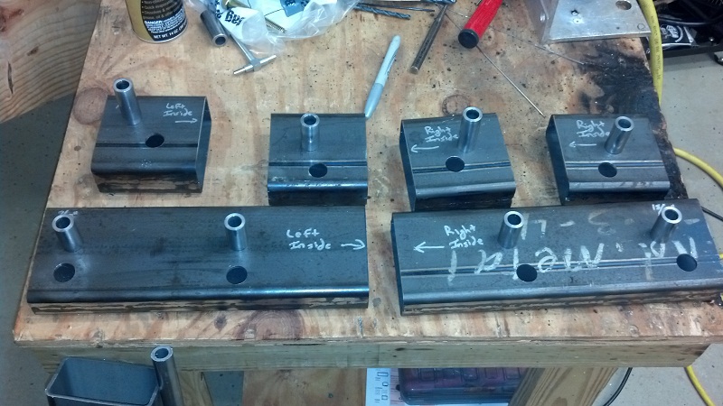

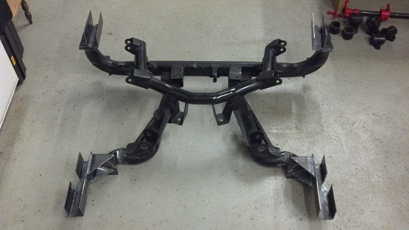

      I've finally made some progress on the IRS. Thanks to Wesley J, I redesigned the rear brackets and they're really coming together now. I ended up using some 10GA sheet (.135") and with a few 90 degree bends and a whole lot of TIG welding they're almost complete (oh yeah, forgot to mention all the plumb-bobs, tape measures and rules I had to use to make sure this thing was square with the front suspension and the rest of the car - by far the most tedious work of it all). I have a few more welds to finish, sandblast and paint and it'll be ready to mount in the car. I still have to come up with a plan to reinforce the frame rails and put some crush sleeves in them as I will be bolting the IRS cradle brackets to the frame rails --- that should be the easy part though! Ultimately the cradle will be rigidly mounted to the frame rails and is about 1 1/2" higher up in the frame for a lower overall stance.
      Here's the pic's
      The front tubes of the cradle had to be shortened and brought inward 2" to clear the frame rails and give enough room to weld to the new brackets.
      Side view of the cradle with front and rear brackets. I took 1 1/2" off of the rear tubes before welding the rear brackets in place. The front was just positioned in place before welding.
      Bottom view of the front brackets.
      Backside of the front bracket (upside down for welding purposes) where the cradle tubes are welded to the bracket.
      Almost complete cradle! A few more welds, sandblasting and some paint and she'll be ready!
      Thanks and enjoy!

      Good to hear you appreciate the feedback. I've learned on my build that the further down the rabbit hole you go, the further you want to go, if you know what I mean. I look back at what I've done and wish I would've just cut the entire floor out and built the frame/floor/firewall from scratch. I can build new sheetmetal in no time, it actually takes me less time to build a pretty panel and fit it that is does to connect it to the existing stuff... Anyway, I'm not answering your question.
      If you haven't welded it all up, I'd be tempted to change out the material that mates to the frame with 1/8", make it a bit longer, and weld your existing pieces to it. The other thing to consider is just doing what you have planned as you have 4 mount points.

      Yeah, certainly agree on the rabbit hole! The challenge is changing direction; you go down one path with a design in mind, spending valuable time and money, and then half way through it you think/see/hear about a different one...part of it I guess!
      I'm now thinking about changing the majority of the design, same premise (with the brackets) but different material thickness and structure. The whole time I really wasn't sure how well the IRS cradle would weld to the 1/4" plate. The IRS cradle is roughly 1/8" thick tube. I had started cutting out the bracket pieces and was going to, at some point, test welding one of the cradle pieces I cut off to the 1/4" plate. However, the cart came before the horse in the spirit of trying to make some progress :-(
      My plan now is to build the brackets out of 1/8” plate steel and create more of a boxed\gusseted structure. Basically I’ll utilize the original bracket design (based on the pic’s in my original post) and maybe place additional gussets where stress\flex points might be. Do you think boxing in the gussets will add any strength\rigidity or are they even needed? I’ll stick with then bolting this to the inner-reinforced frame rails. I’m not really convinced on welding the IRS to the 67’s frame rails as down the road it may end up with a straight axle???

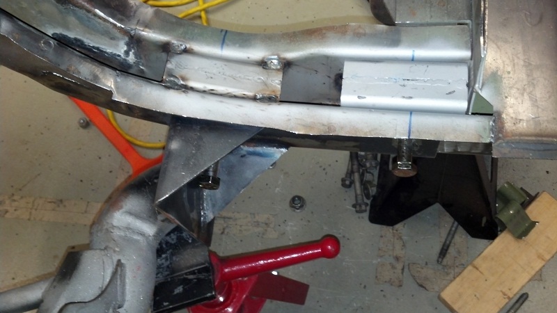

      I finally finished the framerail inserts; probably overkill but I know it'll be solid. They took some time to make as they're fab'd to fit flush inside the frame rails so the floor pans can be welding to them. I basically cut sections out of a 2"x4" rectangle tube steel and TIG'd them back together and then drilled 3/4" holes to hold the DOM tubing for the actual anti-crush sleeves. Once the sleeves were TIG'd in, they were sprayed with some weld-through primer (the UPOL stuff works great!) and set in the frame rails. I put a couple of welds around the inserts to hold them in place so they wouldn't move as I began to weld in the trunk flooring. The flooring itself will also be welded to the inserts to further secure them.

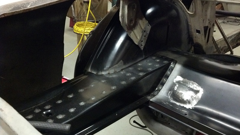

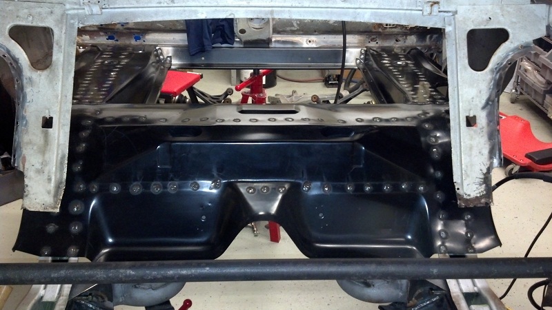

      ...and after drilling a million holes, I did manage to get the trunk flooring welded in.
