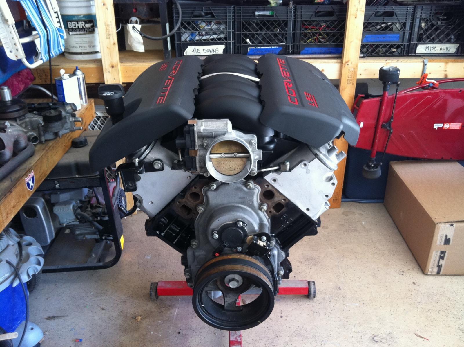

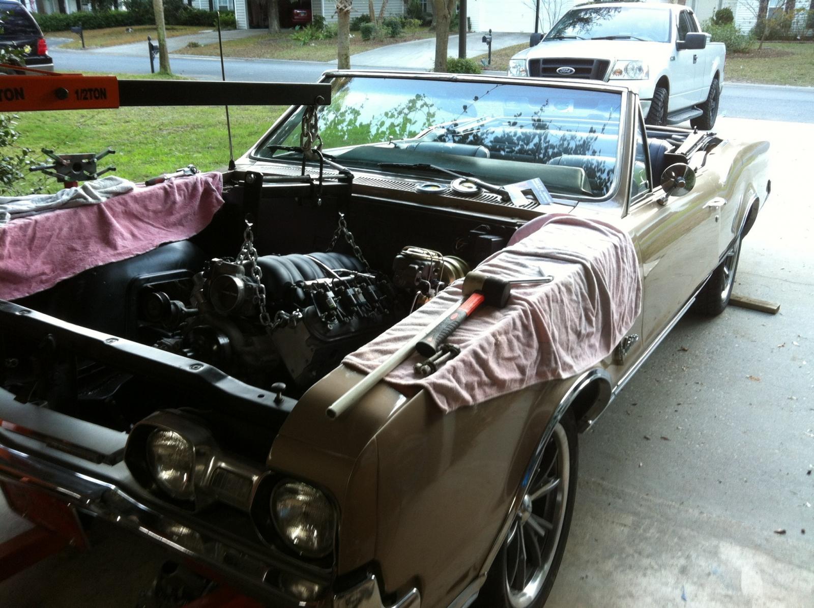

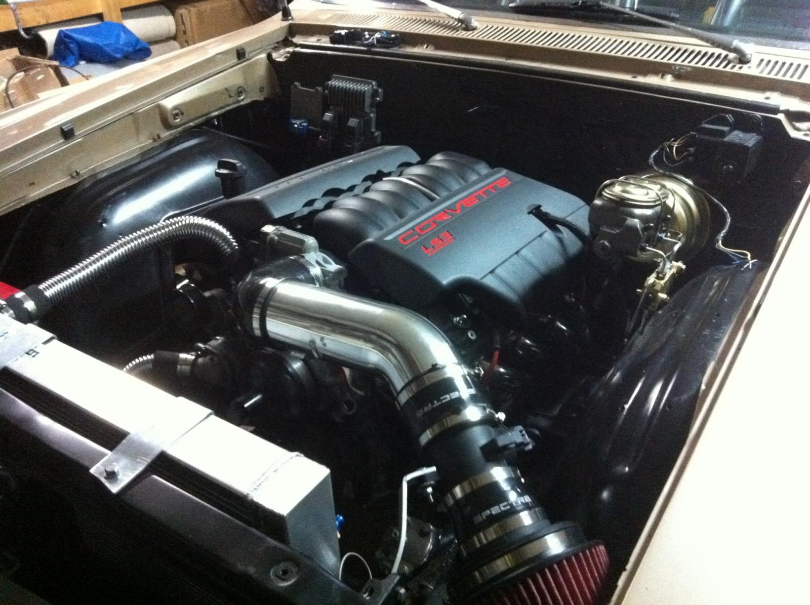

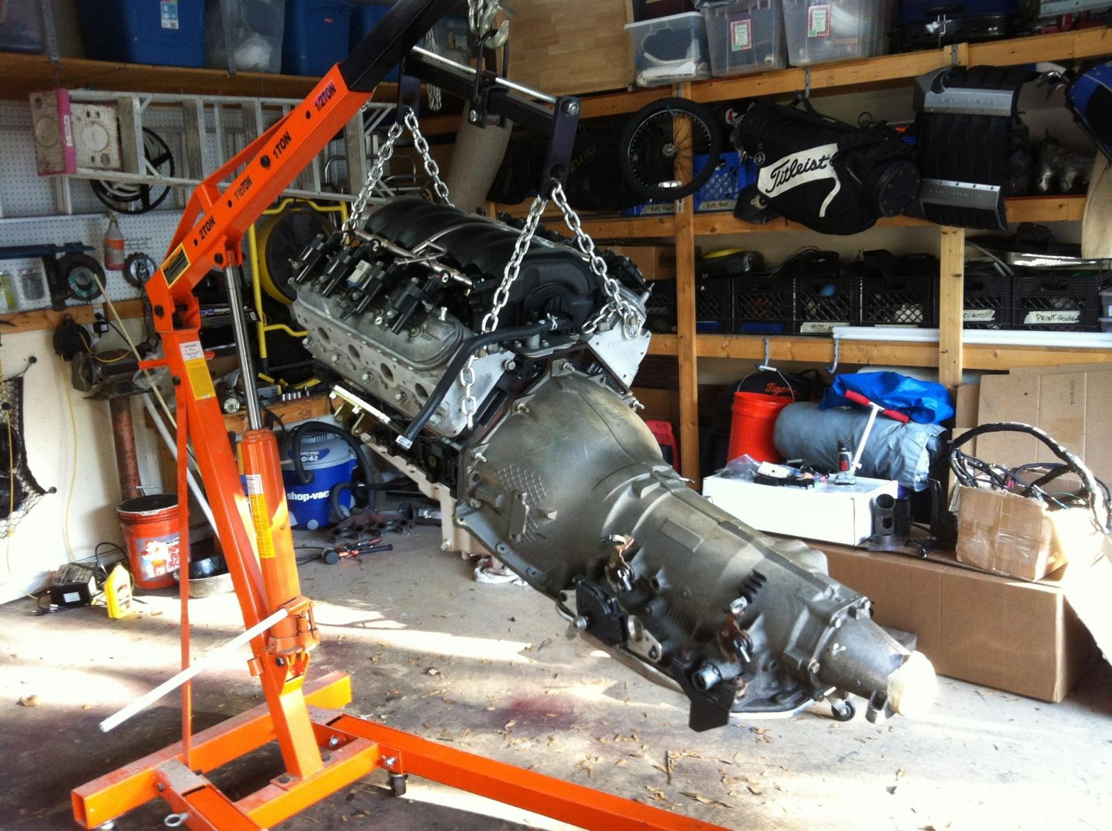

      Hi... I'm Steve from Savannah. Love the site so I figured I'd share my build with everyone. It's a super clean, laser straight 67 cutlass supreme convertible that I have just finished stuffing a 500+ hp Mast cammed LY6, LS3 intake, 4L85e, 9 inch rear, 4 wheel disks, drop suspension and a bunch of other $$!! Hope you like it as much as I do.

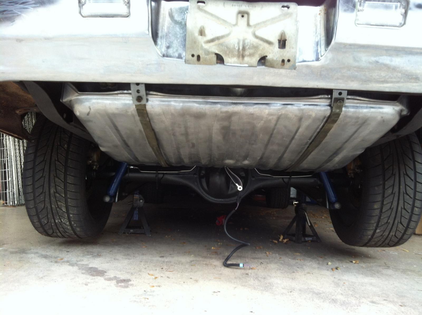

      Another LS conversion question. It looks like you still have the stock fuel tank. Are you running an external pump?

      I'm running a stock fuel tank with external walbro 255 pump & vet fuel/filter regulator

      Thanks for the info...i was a die hard pontiac guy for years. Had a 10 second 66 goat with a d port head 455 that i ran for years. I learned the hard way...and expensive way to boot!! Now im doing things smarter not harder. This car will run mid to low 11's as it sits with no power adder (yet!!), gets 20+ miles per gallon, never overheats, can be driven anywhere and sounds like an angry freight train comin atcha when your on the gas! Try that with any BPO motor.
      As for the tank... it's a stock replacement tank from rock auto with the built in fuel pump for EFI applications. Then I used the vette filter/regulator combo unit....so far so good!!!
