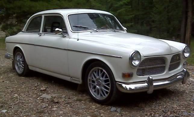

      OK - I'm getting hopelessly lost in the world of suspension geometry and appeal to the collective wisdom of this board for a little assistance. My project car is a 1966 Volvo Canadian (Amazon/122s whatever you want to call it). I've had the car for 7 years and it has undergone a number of simple revisions and some rather more complicated additions. Like the rest of you, I take this car out to track days (surprise a lot of people) and the rest of the time it's a vigorously driven street car. Before everyone starts to laugh - it's making 160 hp out of 2L and I've converted the front brakes to Wilwood FSL's and have a disk brake rear with LSD. It's only 2400 lbs and generally handles well with 28mm front sway and 20mm rear. Spring rates are variable (250 - 500 lbs/in) up front and 150 lbs/in in the rear with Bilsteins doing damping duty.
      After rebuilding everything, I'd like to equip the car with rack and pinion steering, get some suspension travel at the stance that I like and am not shy with the plasma cutter and welder (all processes). As a Volvo performance guy, I have to home-brew just about everything - so don't hold back if you've got a crazy idea. I like crazy.
      Here's the patient:
      Here's what I know:
      - I set up the suspension for the current ride height and the centre of the hub is located 11 7/8" from a level surface.
      - Track (wheel mount face to
      wheel mount face is 55 1/2"
      - The frame rails are 24.25" inside and 28.625" outside
      - LCA is 16" from pivot to ball joint.
      - UCA is 10.5" from pivot to ball joint.
      - LCA pivot is 7.1875" from the centre of the crossmember.
      - UCA pivot is 10.75" from the centre of the crossmember.
      - LCA is set at 5.5 degrees (ball joint is higher than the pivot).
      - UCA is set at 2.5 degrees.
      - Camber is -0.5 degrees
      - Caster is 0 (as far as I can determine).
      It's a narrow car and I'm just about sitting on the bump stops right now (one inch of travel).
      The original design is good for its intended purpose, but not for what I do with the car.
      I'm thinking that I'm going to have to chop off the front of the car and build a new front suspension. My problem is that I'm not sure what I should be looking for - there is a bunch of Mustang II stuff that would work - but what should I do to calculated what I've got now and what do does good look like for geometry?

      Very cool project. Love the idea of something different. So, looking at the last picture with the lower A-arm looking level. It appears that you still have suspension travel (if you reduce older rubber bump stop for smaller urathane style).

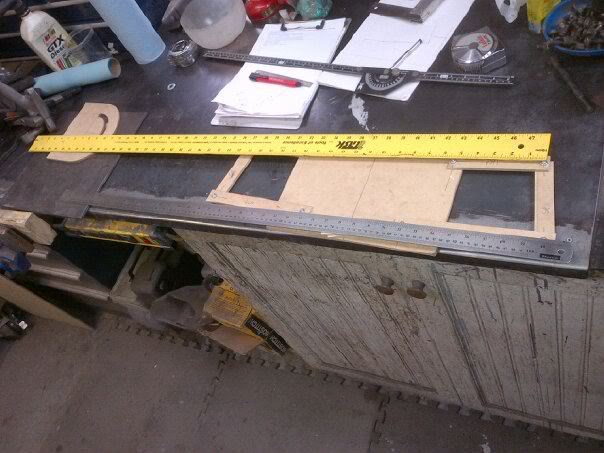

      Thanks guys - I was needing some encouragement to figure a few things out. Here's the list from today. First up, I created a wooden model of my suspension geometry (2D) and discovered that my instant centres are 132" long (see photo). All those geometric examples where the UCA/LCA intersect within the chasis...what an eye opener!
      So AFAIK that means that I get a lot of camber gain (positive or negative) with suspension movemen or body roll. This makes sense as the usual solution for these cars it to lower the car just a little, but equip it with big antiroll bars (28 mm front and 20mm rear (remember 2400 lb. car)) and stiff springs to try to limit body roll and suspension travel - after I got my wooden model built, I tried it out and it makes total sense. It shows dramatic movement of the hub with body roll or bump.
      I can't fit a rack as the pivots for the LCA are only 14.75" apart! I'd need 16" to fit a mustang rack (I think). I've emailed several manufacturers and they all say no due to bump steer.
      The C-notch is really narrow (8" wide) so if I just wanted to drop it, I could make it taller, but I dont' really care to lower the body on the frame, I want to have suspension travel. Now I suppose if I did that I could raise the suspension, which would give me more travel (or cut my bumps) - but I really think that instant centre is my issue (as raising the suspension makes the instant centre longer!). This geometry makes sense when you consider that it was designed for tall sidewall tires and lower speeds with no caster to make manual steering tollerable. I have looked at (but not measured directly) what would happen to my roll centre and it would be migrating like a lost Irish imagrant (sorry - not a cultural slur...just family history).
      I think a custom clip is the only answer for real handling. I've already installed a wider track rear end (2") with a custom 4 link that I fabricated...helped a bit, but the rear roll centre is fixed with the 4 link to the centre of the diff (where the panhard rod crosses). I'm going to be converting the rear to a Supra IRS (not a drag car!).
      So I'm now thinking that a Welder's series crossmember (reinforced as things like the LCA mount look dangerously weak) with Mustang bits would be a giant step forward (start the M2 Flame wars!).
