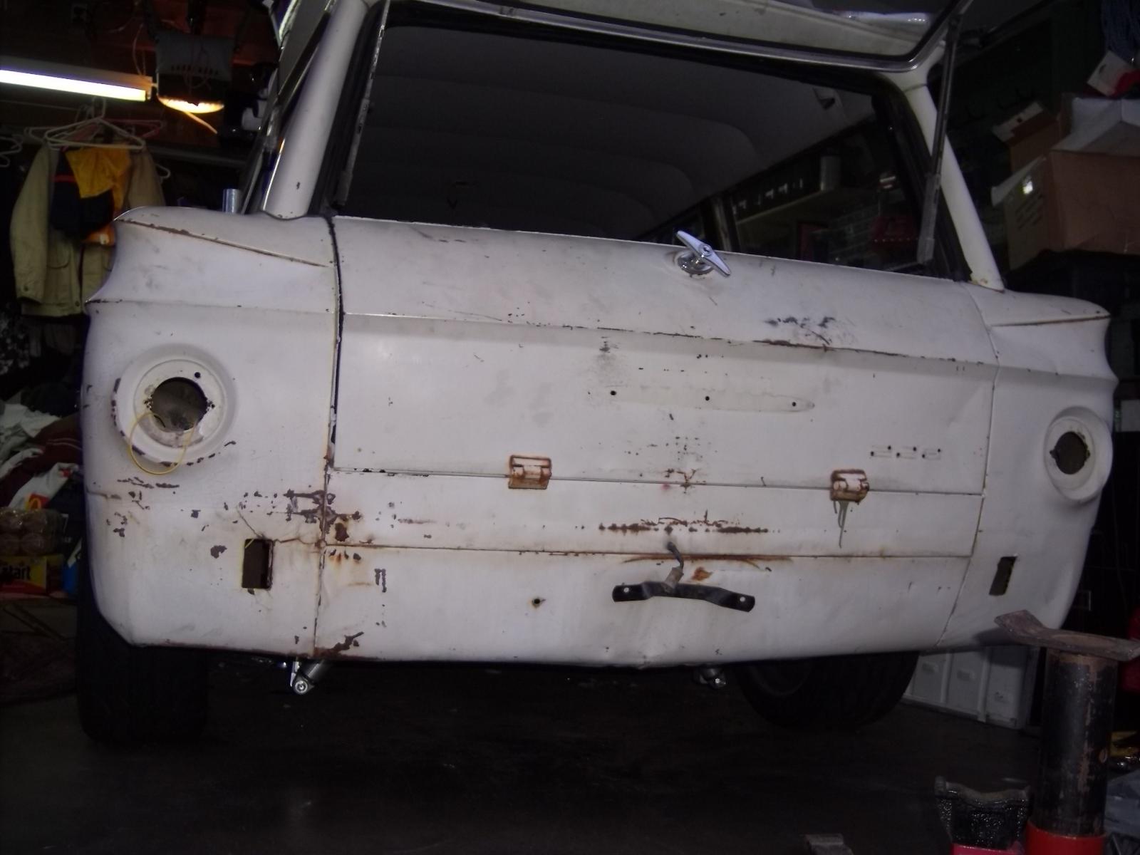

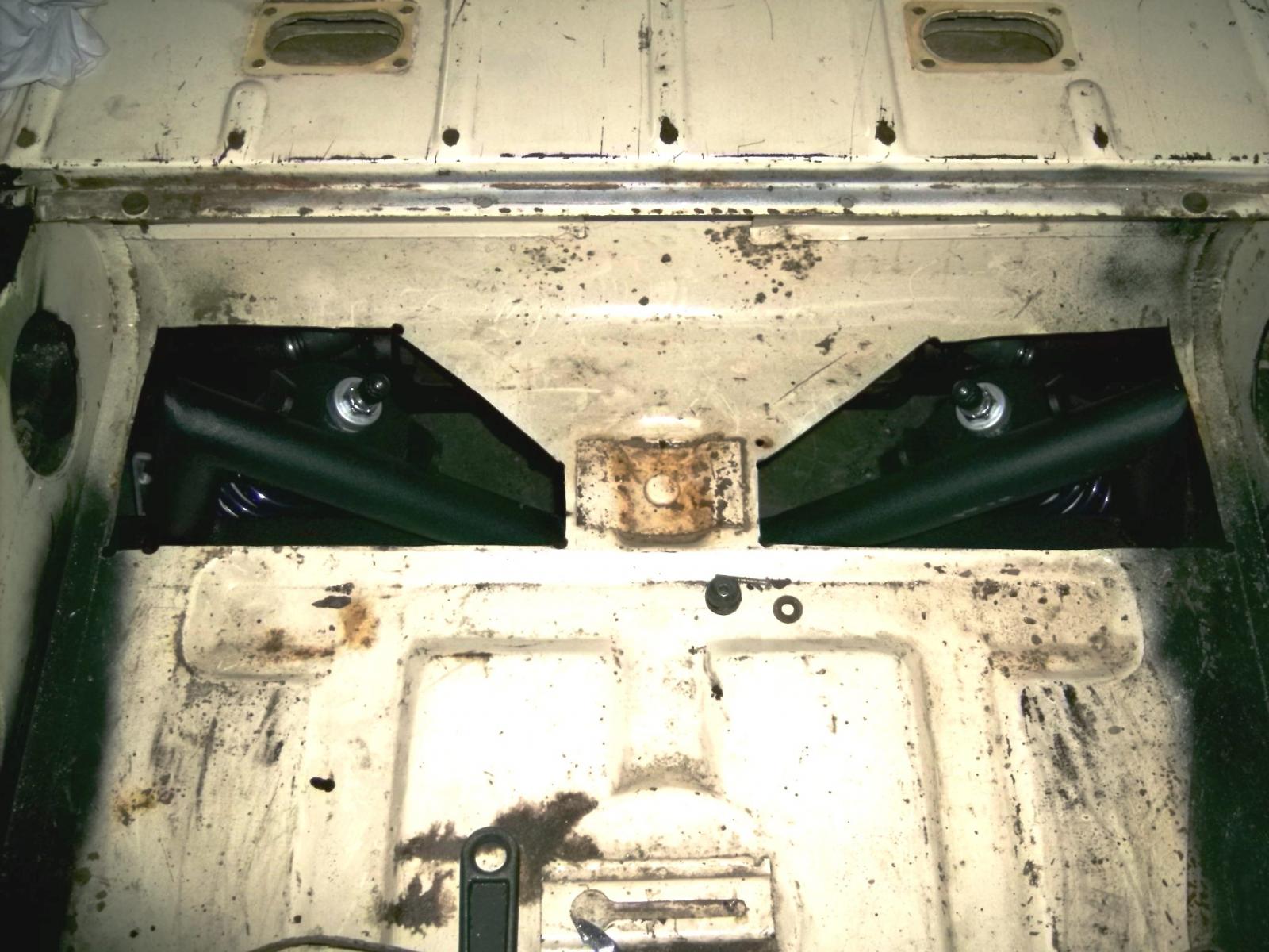

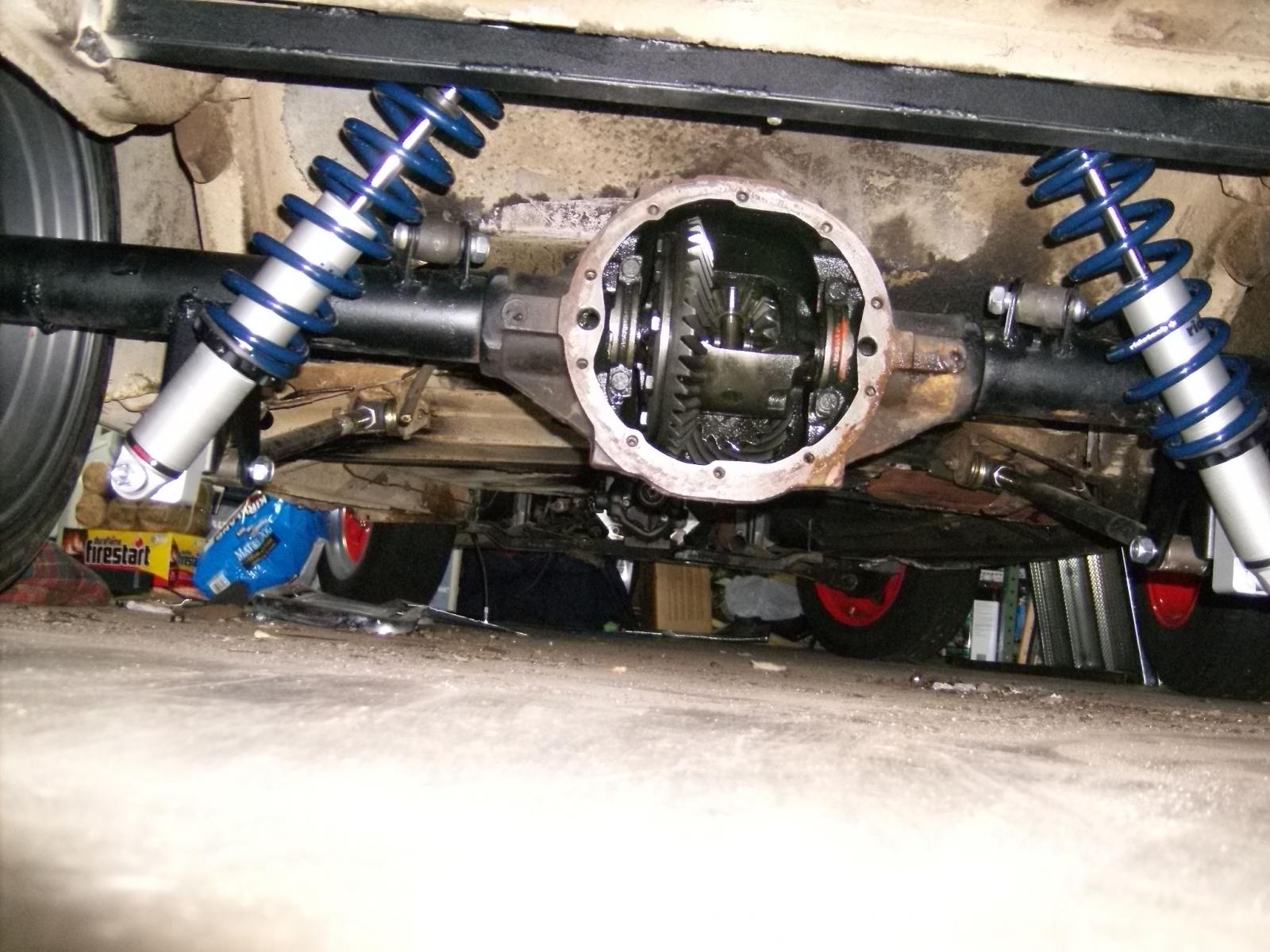

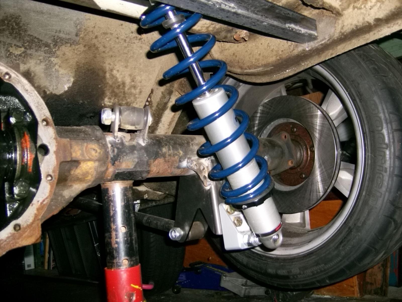

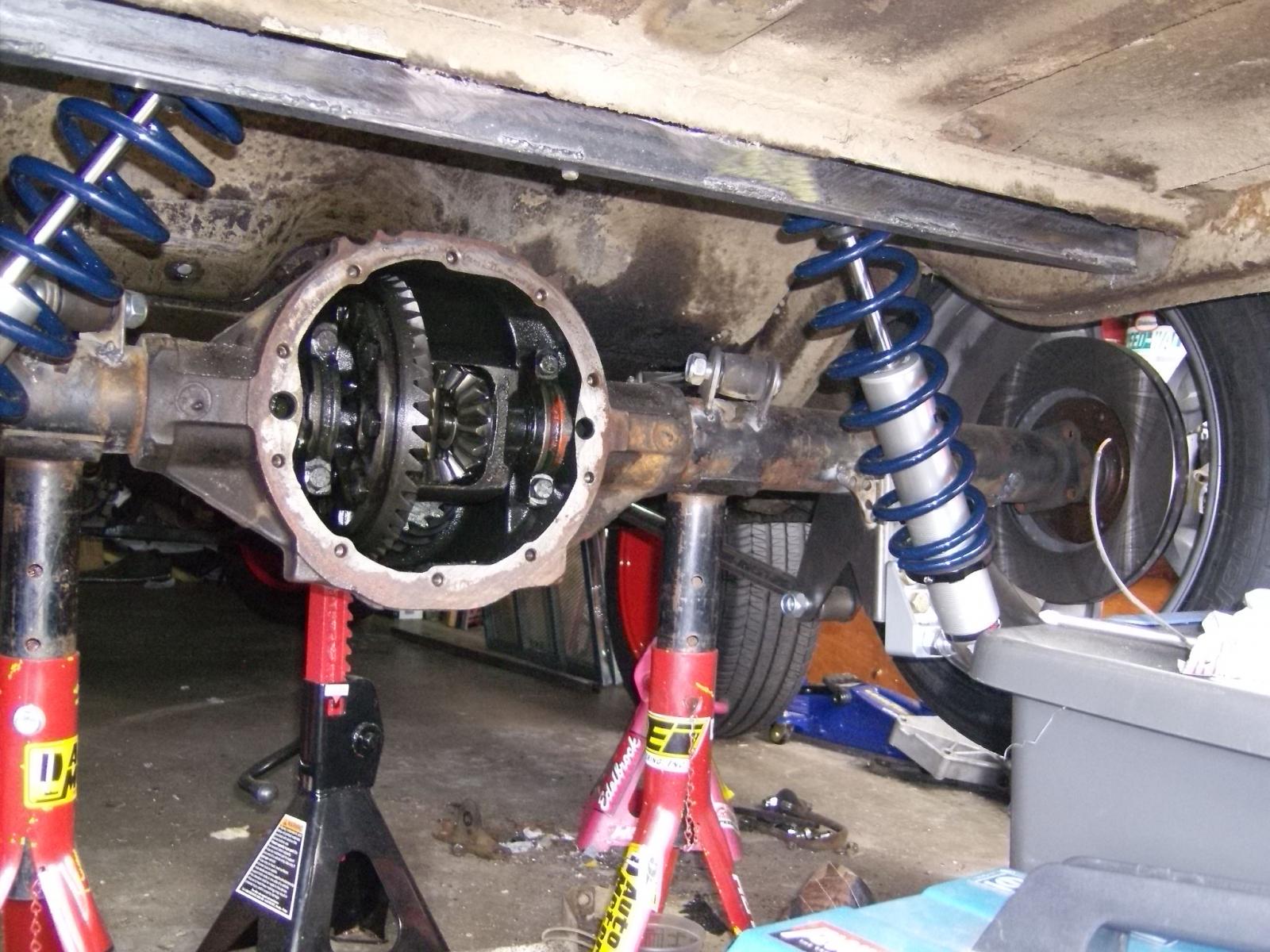

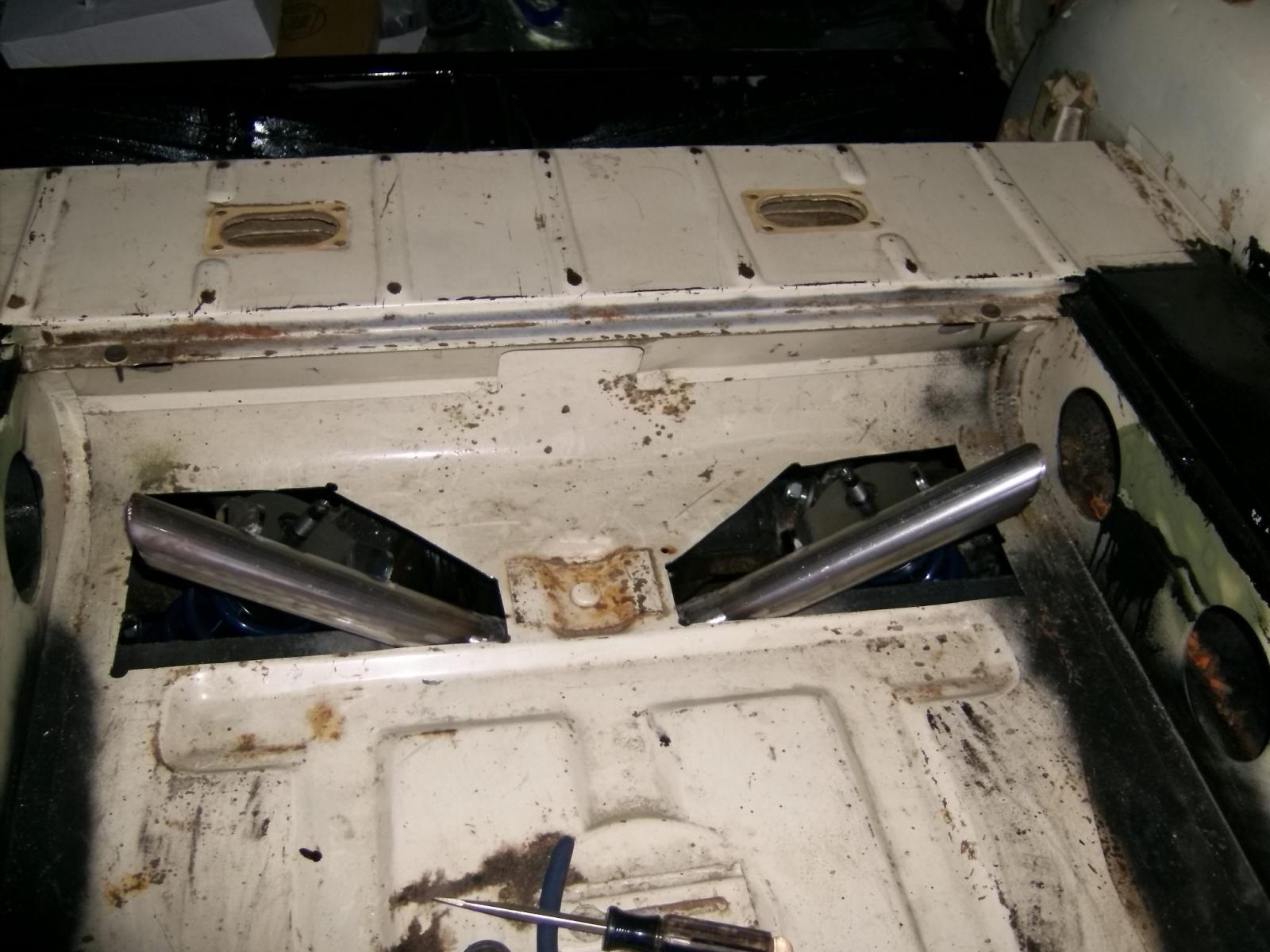

      Pictures of work so far...
      So we've subbed in the Camaro sub-frame in the rear and @Rod fabbed the shock mounts in the rear cargo hatch.
      The car now sits so low the roof is almost to my 5'2" shoulder.
      You can see from the pics what's been done...
Size:  174.5 KBName:  GEDC0623.jpg
Size:  227.1 KBName:  GEDC0635.jpg
Size:  259.1 KBName:  GEDC0650.jpg
Size:  120.0 KBName:  GEDC0651.jpg
Size:  223.4 KBName:  GEDC0654.jpg

      If you leave them in long enough, in the right kind of weather - they kinda are automatic ;-)
      Great to see progress guys - can't wait to see this on the track!

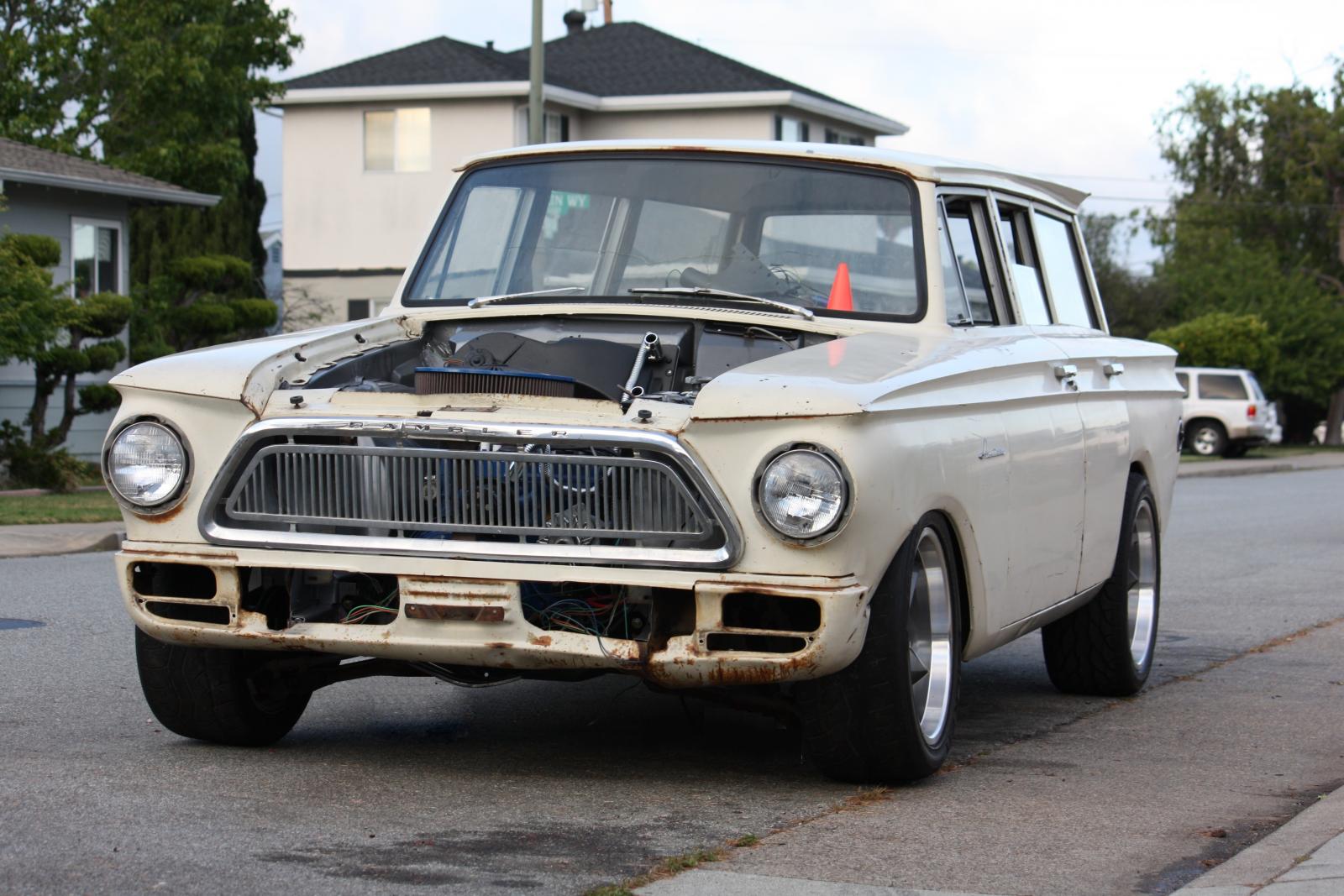

      She's on the move!
      Sort of.
      Tonight we pulled Sugar out of our high-tech garage-of-luxury to turn her around and I snapped a few pictures.
Size:  212.9 KBName:  sugar2.jpg
Size:  224.6 KBName:  sugar3.jpg
