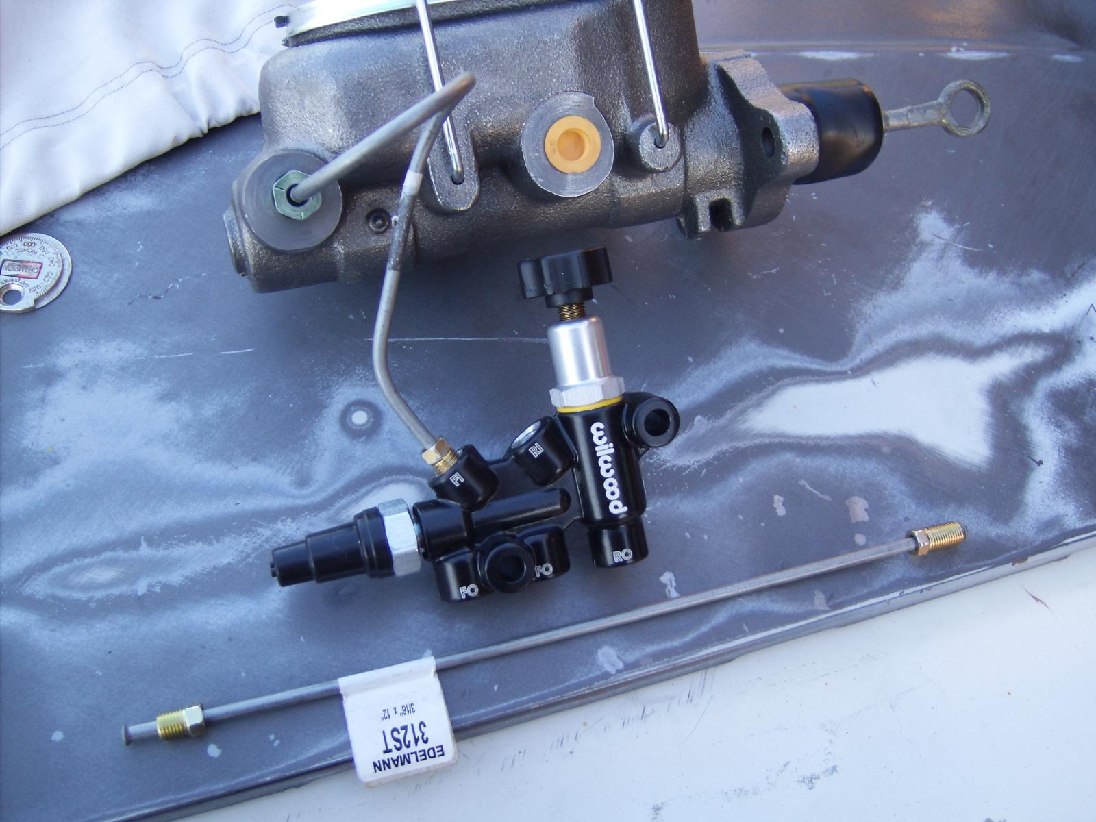

      heres some of the small details going into Sugar, a Corvette dual bail master cylinder custom bent lines and wilwood prop valve, nothing is pre built for the car for a performance disc brake set up, so cut lines add ends and double flair then bend, and repeat

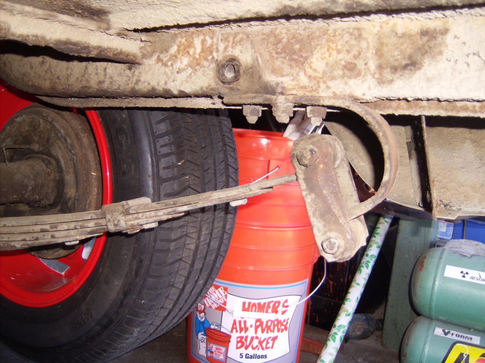

      50 year old rambler suspension
      here's what it all looks like stock and original
      rear leaf shackle and articulation spring
      another angle on this link and spring, with this design the car had 19 inches of articulation (if one side was on the ground the other side had to be lifted over 19 inches to get the wheel off the ground)

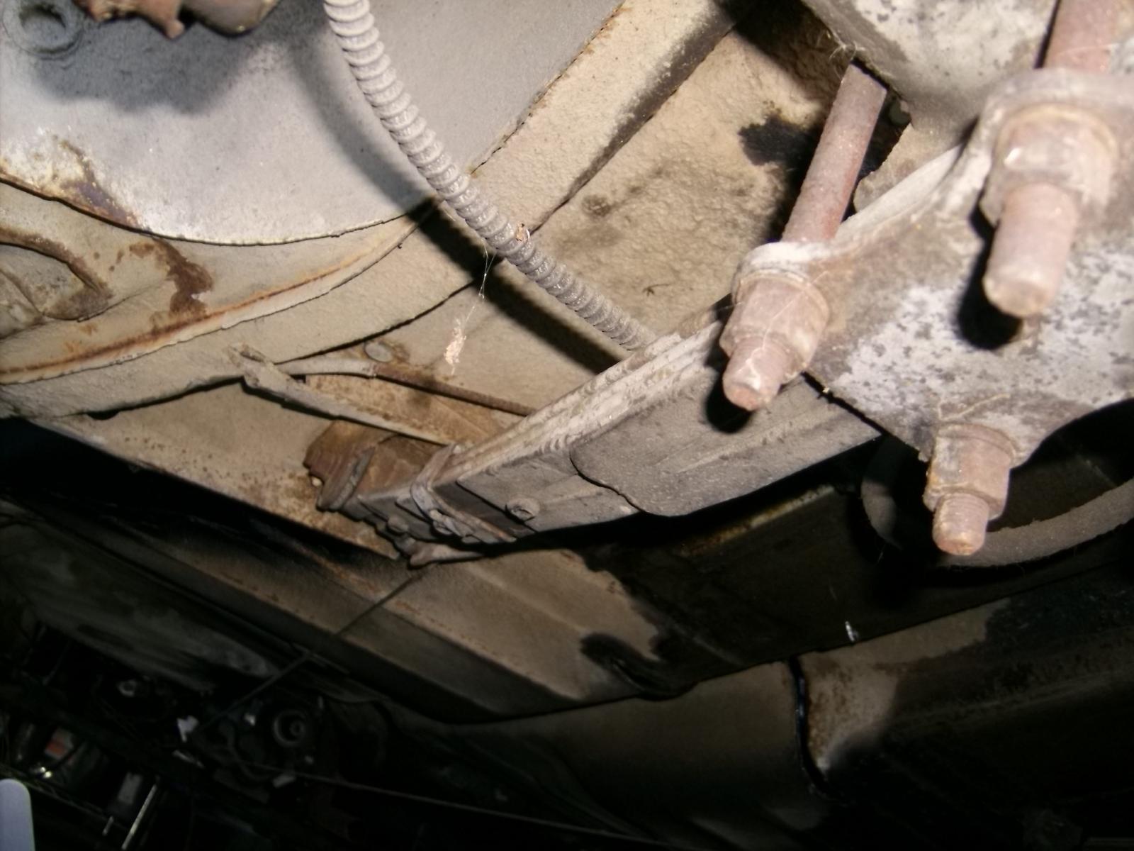

      here's the front leaf spring eyelet mount

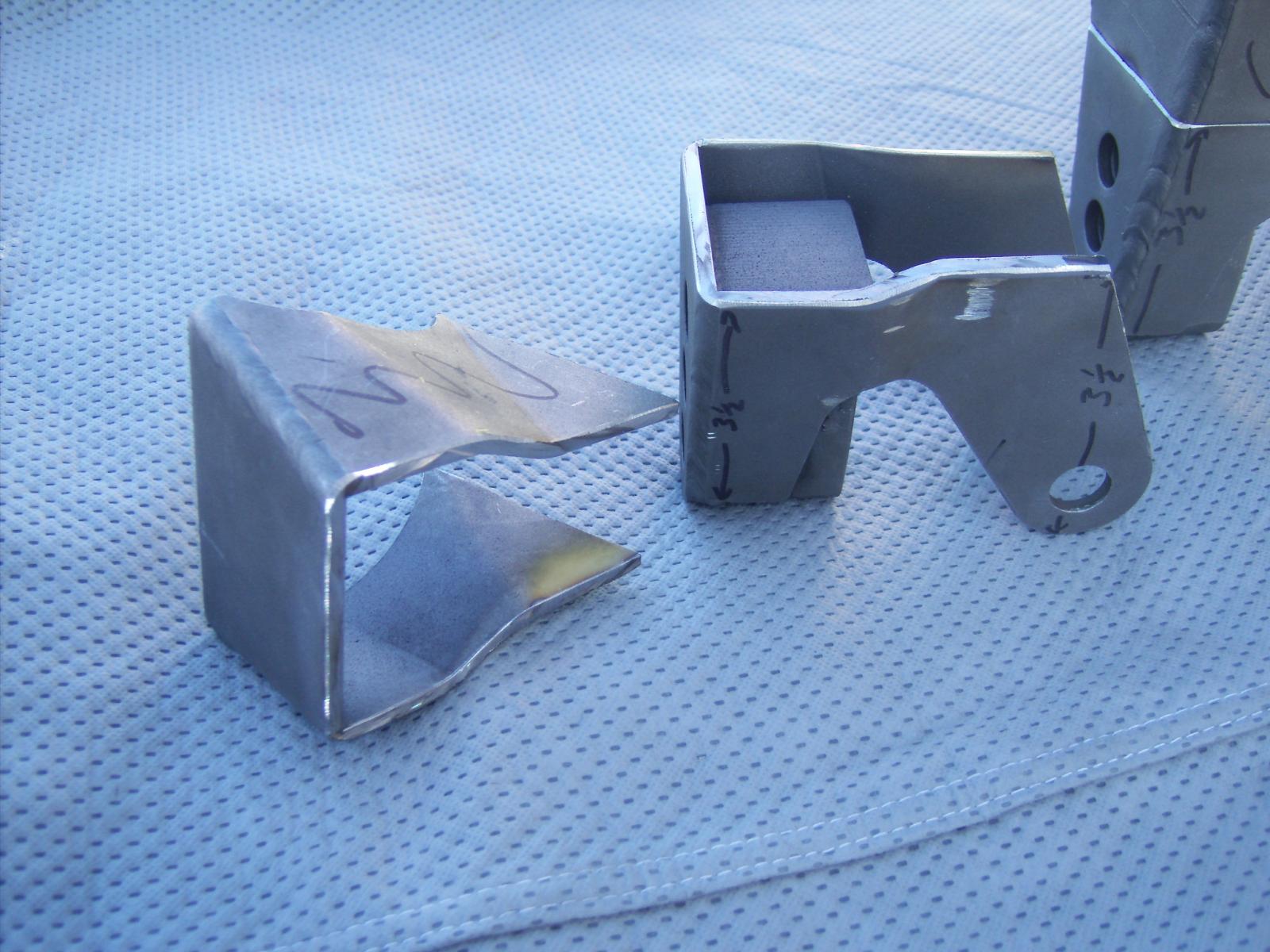

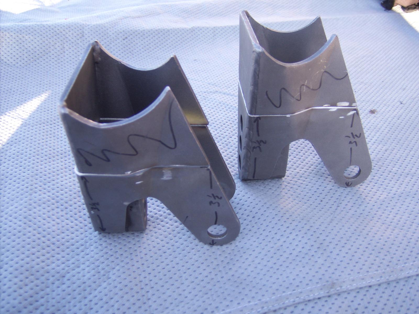

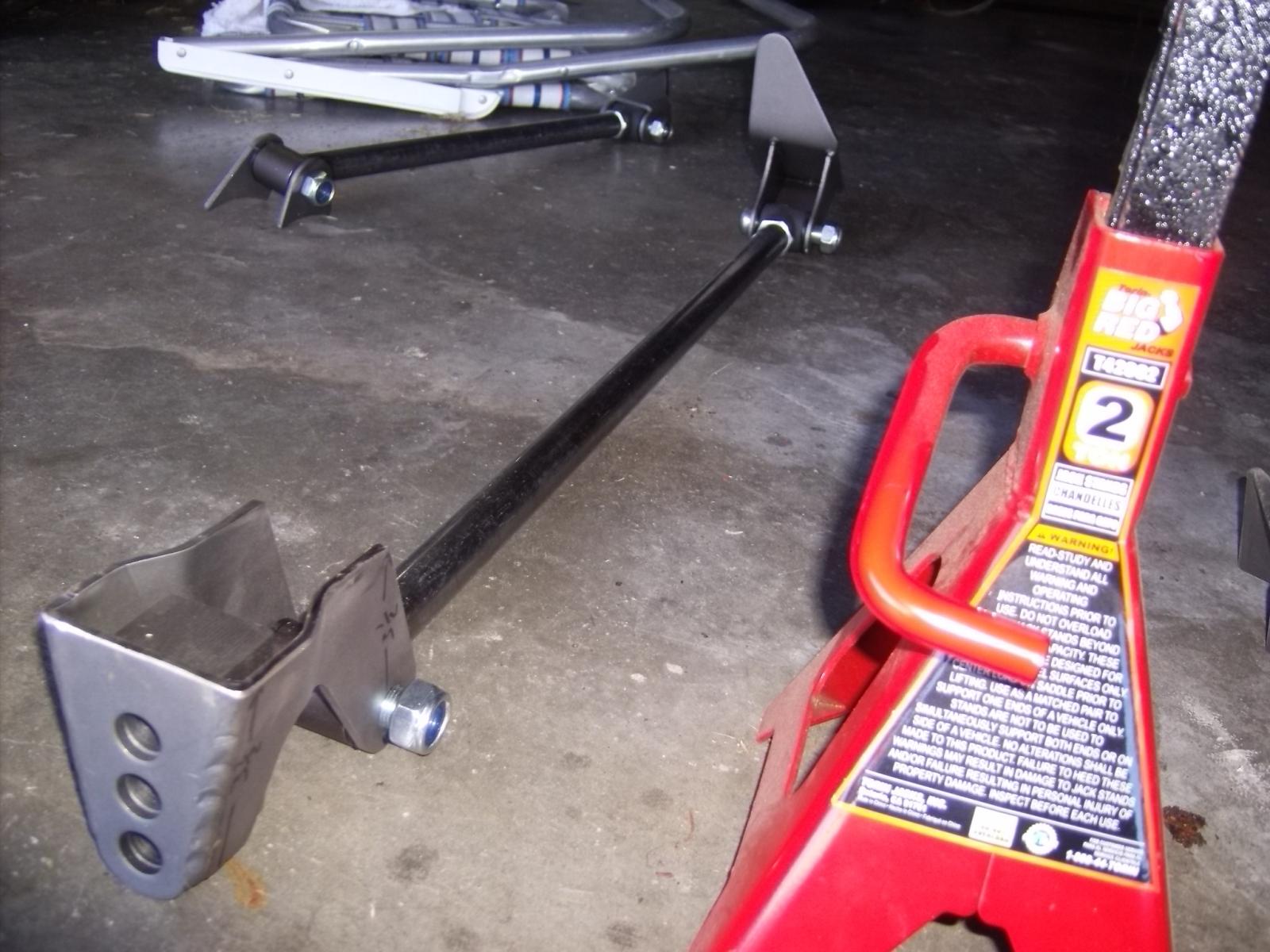

      Ride Tech triangulated 4 link for Sugar(1963 Rambler American Wagon)
      were modding every thing on the kit, here's the plan, Build 4 link, Build Watts Link, custom rear Sway Bar, first we'll build and assemble the setup then take it back out to send out for powdercoating and all the hardware plated, Build 4 link, Build Watts Link, custom rear Sway Bar
      the rear perches are cut down to be welded to an axle plate

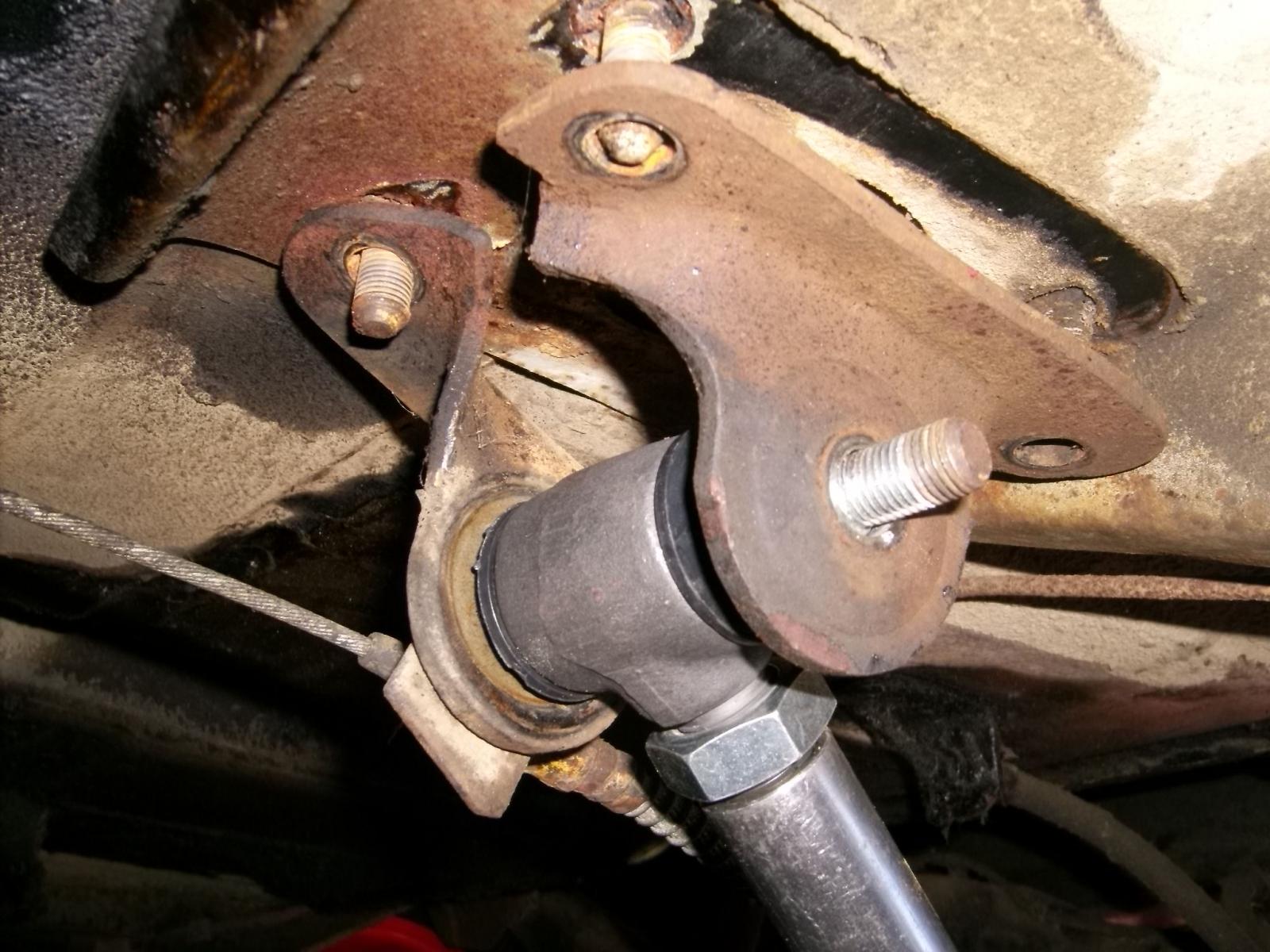

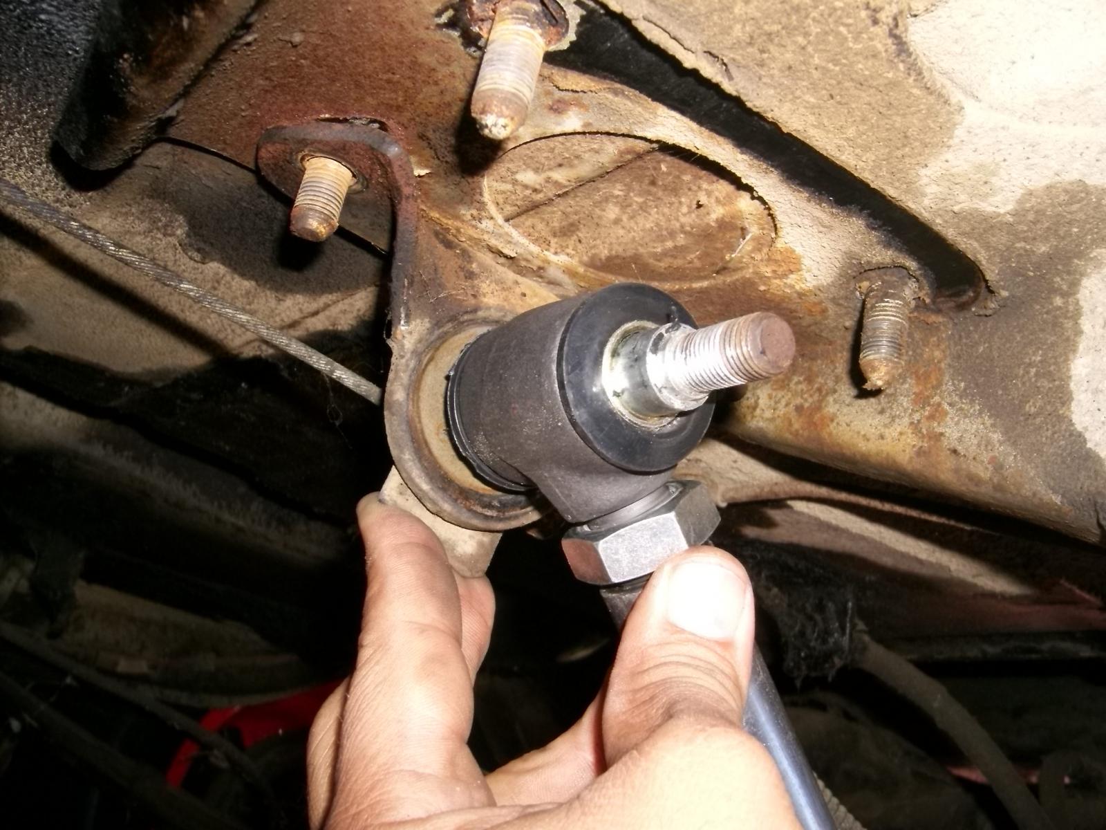

      and here how the front leaf spring mount is going to serve as the front lower locating bar support, the new parts slip into place with just a small tube shim

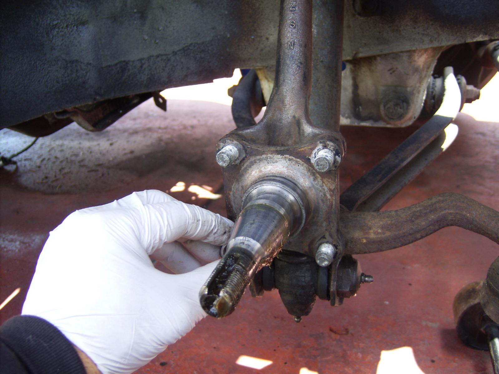

      1963 Rambler Disc Brakes? Sugars gets a brake

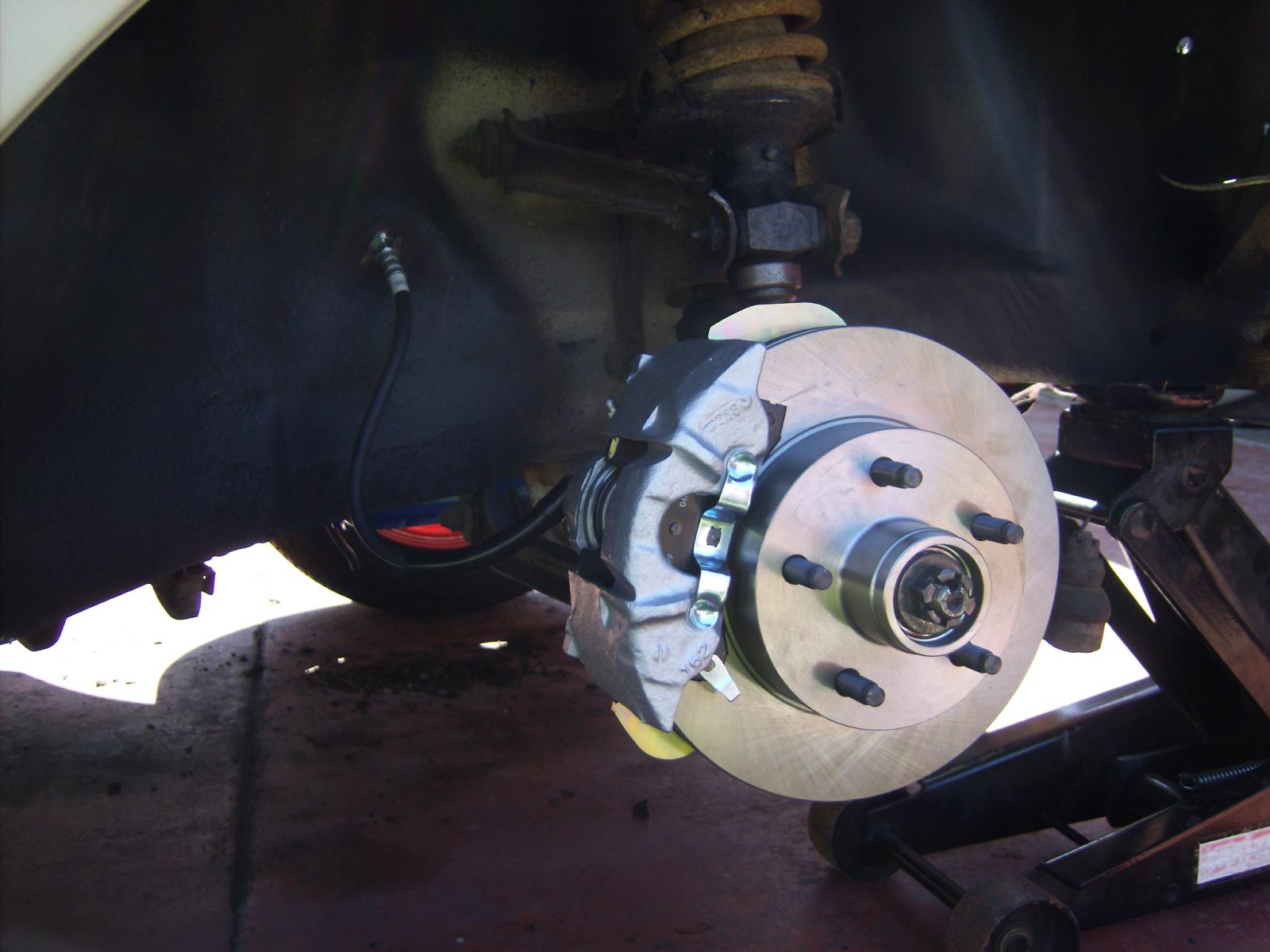

      1963 Rambler Disc Brakes? know how hard it is to find factory ones, the next best thing is a ScareBird brake bracket setup, a well made bracket with detailed parts list to run modern parts on a 50 year old car, front disc brakes made easy!
      first strip the old off

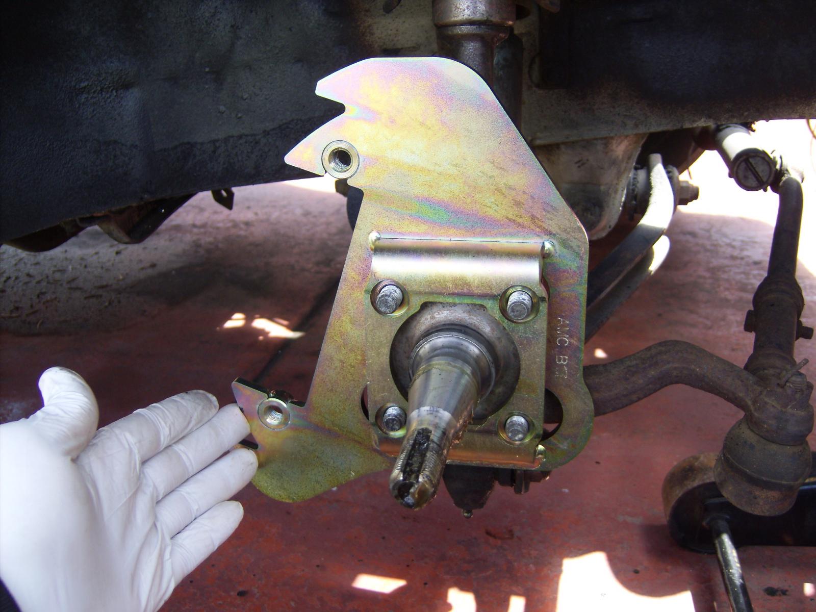

      next add the sweet Scarebird bracket
      then is simply add the Ford ranger disc's, Chevy Cavalier Calipers, and Caddy hoses
