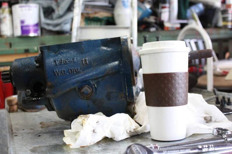

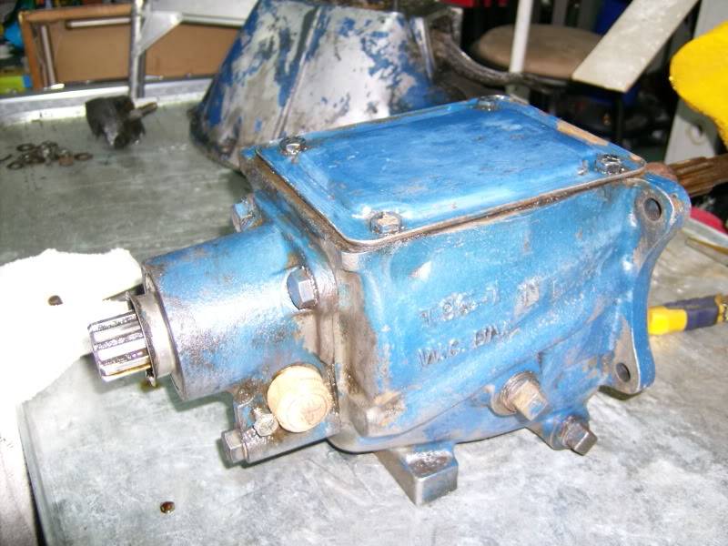

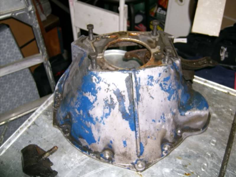

      Here's how huge a Borg Warner T-96 3-Speed looks like next to a cup of coffee.
      The bell housing was significantly larger than the tramsmission itself.

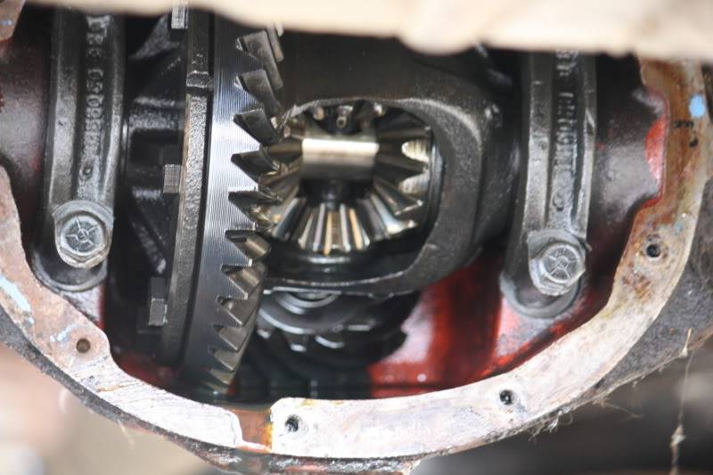

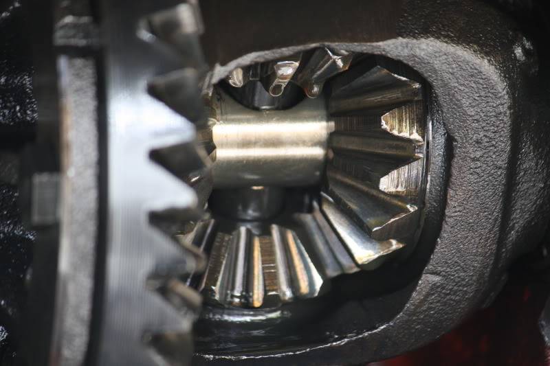

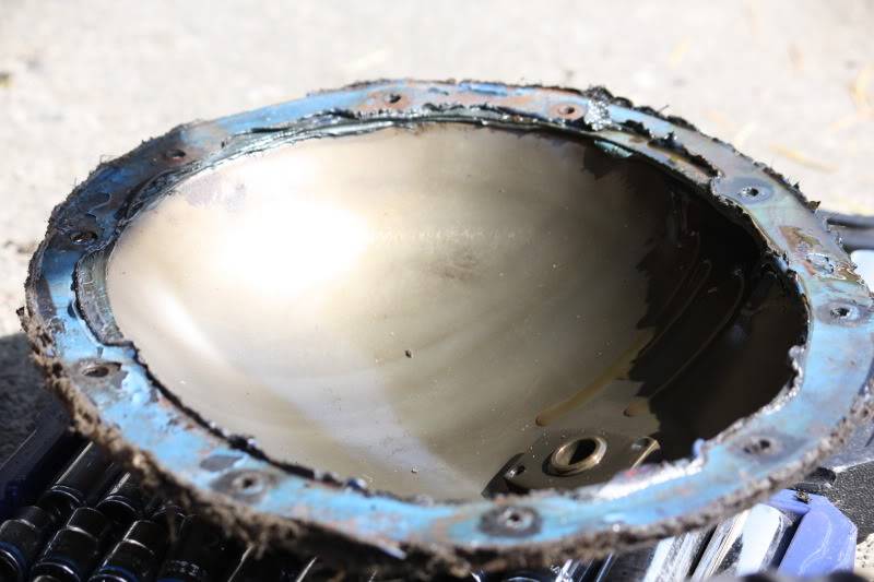

      We cracked open the pumpkin in the rear and were VERY pleasantly surprised that things looked nearly pristine!
      One less thing to restore! > I should point out that the last known registration of the car (presuming it's last drive) before being partially dismantled and stored was 1996. If the drain plugs had been removed from the interior we'd be dealing with a car that was stored as perfectly as a car can be. There was even oil in the gas tank preventing ANY rust from developing inside the tank.

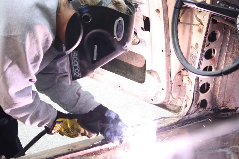

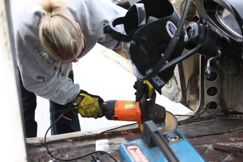

      I learned how to weld (a skill I have wanted to learn for many years) and welded a couple of patches to the driver's side of the floor.
      I quickly learned that anything you weld, you have to grind. If you're a new, less than perfect welder, there is a LOT of grinding. My welding career on this project was short lived because unlike POR-15, I do not have a love affair with the grinder. I think my arms and ears are still vibrating.

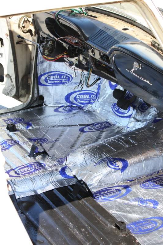

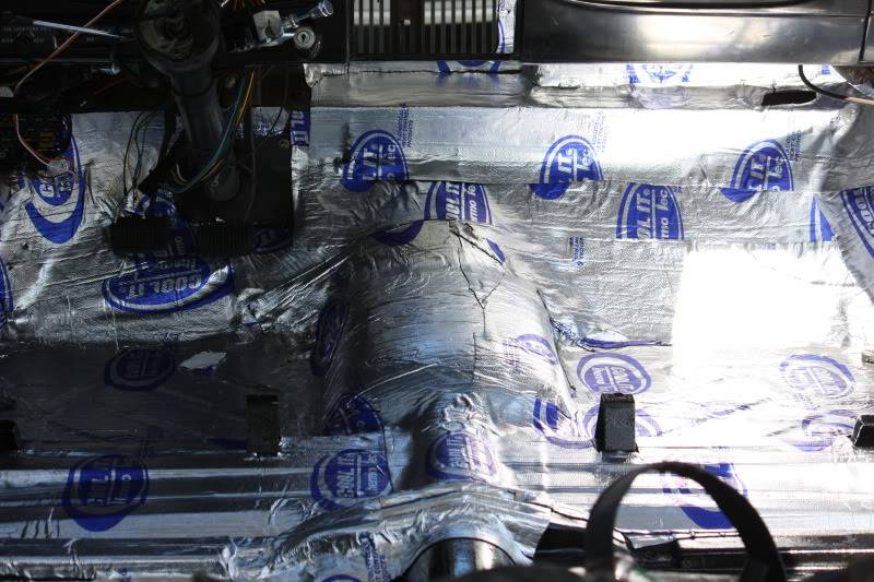

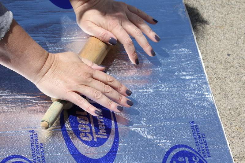

      Once the floors were painted with POR-15 the sound deadener went down (I'm pretty sure I'm going to need a lot of this stuff).
      They don't call me Suzy-Homemaker for nothin' my chosen tools for the sound deadener were a rolling pin and a metal serving spoon.
      (and laying it out in the sunshine to heat up and flatten out)
      I'm not going to win any awards for beauty on this application but I did my best to get it on as neat as possible while still covering everything and not wasting a single scrap.

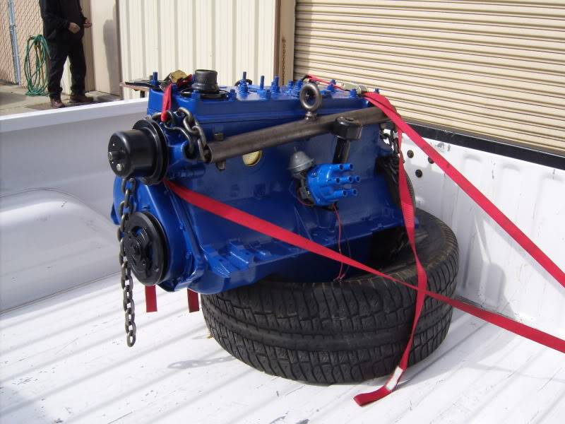

      Now it was on to the engine compartment because.... guess what?! The engine is back!! so it's time to get that beauty in the car.

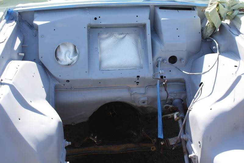

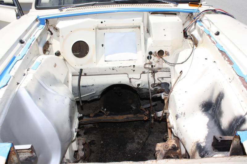

      But before I go into that, take a look at where I started with the engine compartment: (I should point out that the engine wasn't in the car when I bought it, it had been stored out of the car.)
      Here it is scrubbed within an inch of bare metal and taped off for primer:
      Here it is primed for silver hammer tone paint:
