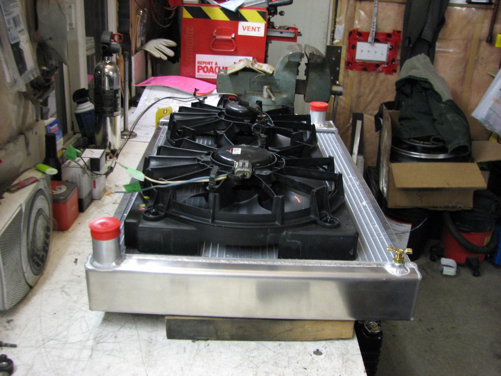

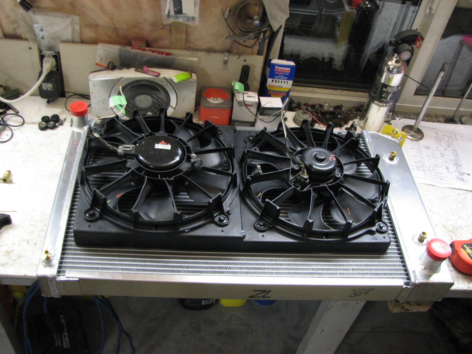

      Took the radiator out to give it a quick paint job, I must of banged it somewhere cause when I put
      it back in the car it was leaking. It looks pretty ratty anyway so I got a new aluminum radiator.
      Went to my local pick-ur-part and found a nice dual fan setup in a '99? Chevrolet Malibu. Got a
      couple relays, a thermostatic switch and a fuse holder to wire up my new fans.

      Couple pics of the radiator and fans.
