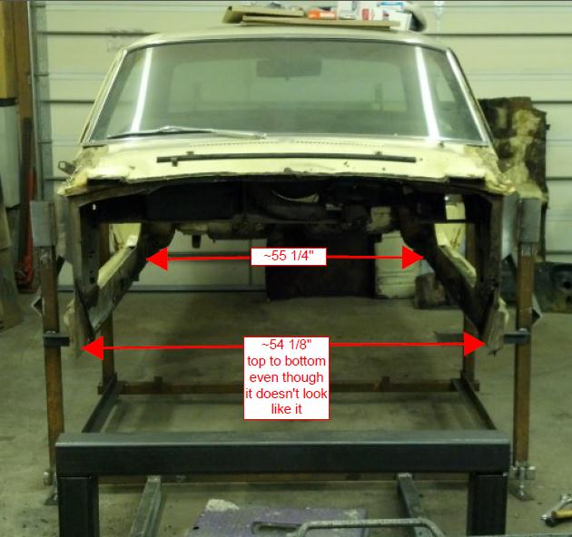

      A little more cutting and confusion
      So I did a little more cutting (rest of the firewall) and some measuring......but I'm a little confused still about the rockers
      With the firewall completely gone I was able to measure the width that corresponds with the rockers and it was approximately the same width down to rockers....which is an inch or so narrower than the rockers just in front of the rear wheels.
      I have found conflicting information on the web....I have a shot in the dark email out to dynacorn to see if they might share some info, so we will see on that.
