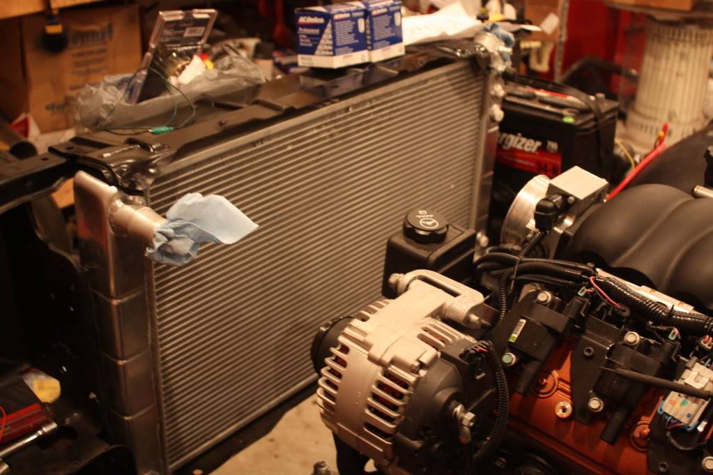

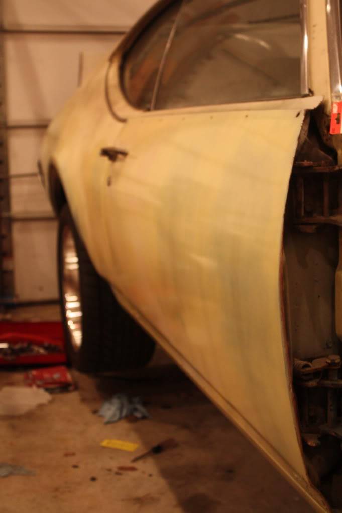

      This is the same car that was being built in my Red Rocket build but I realized I liked the Saffron Yellow paint so much I would keep it. I had been doing a boosted build originally but life just kept getting in my way so for now it is going for the sleeper look with the column shift and bench seat.

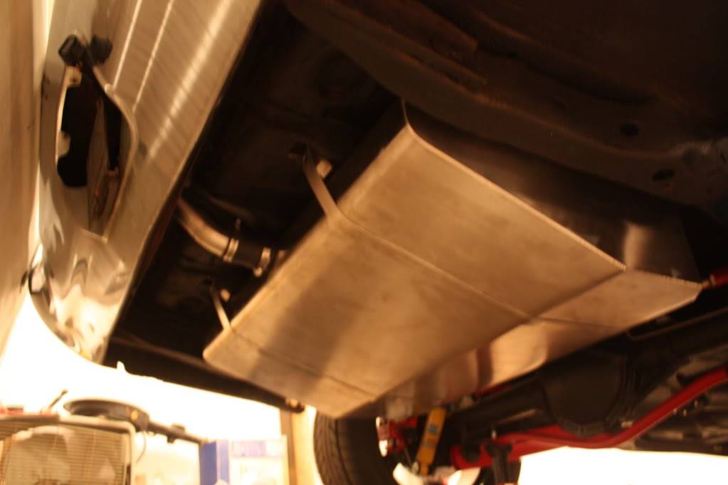

      It has Boss 338s on her right now with 285/40-18 in back and 255/45-18 up front. I am highly considering going with 17" steelies with poverty caps to complete the sleeper theme. She has a full BMR suspension under her with Bilstein shocks. I may swap the rear springs for 2 inch drop if I don't like the stance. Fuel system currently consists of a Rick's tank with a 5th gen Camaro pump with a 4th gen fbody regulator sipping thru a vaporworx pickup assembly.

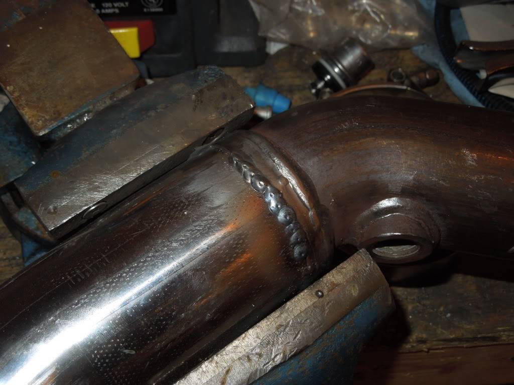

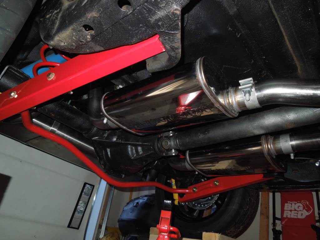

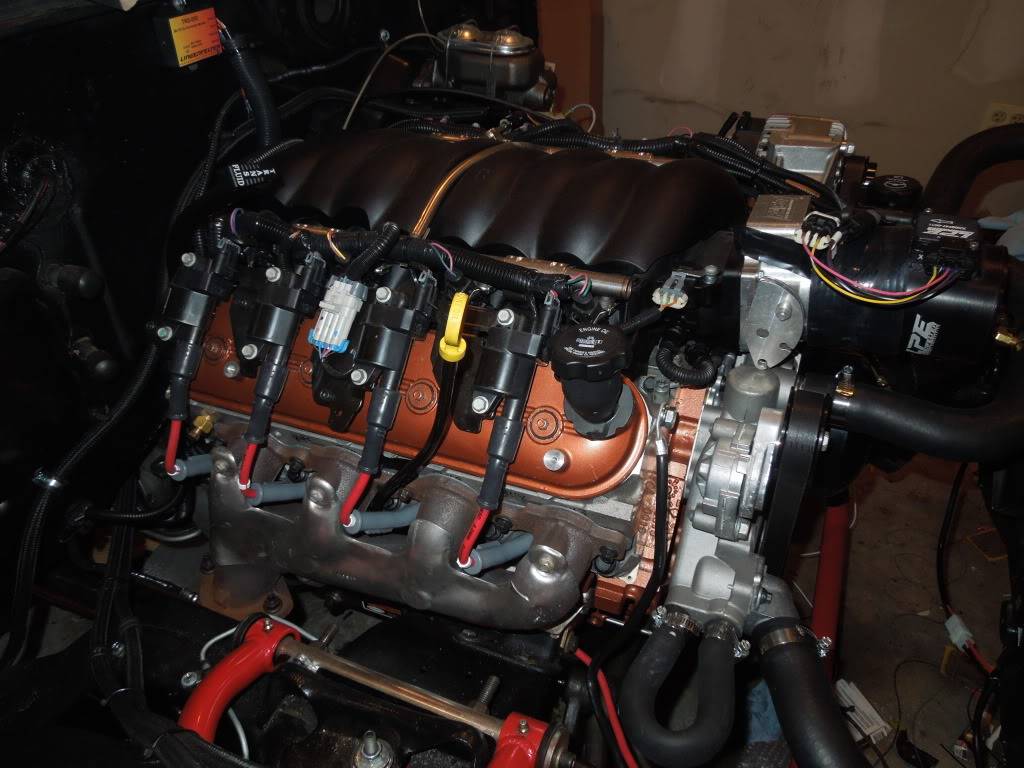

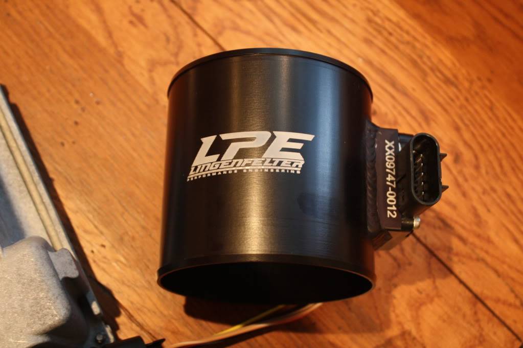

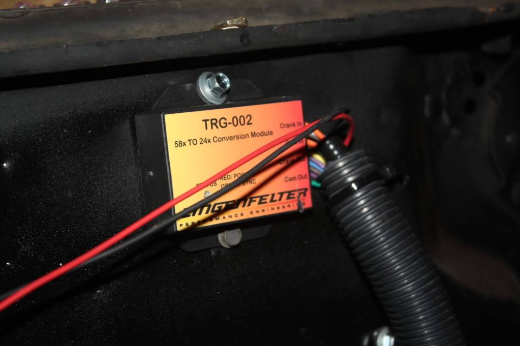

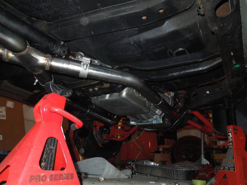

      This today I just got done the main portion of the exhaust. I am sticking with LS3 Camaro manifolds for now so I can keep the column shift. Engine is an LY6 with lightly ported L92 heads, LS3 intake/injectors, FAST 90mm throttle body and a Lingenfelter 102mm MAF. She also has a decent Lunati cam and a built 4L60e with a 2600-2800 restalled stock converter. Rear's a 12 bolt with 3.31 gears.
      When I finally get all the parts together I will be going boosted...think Jim Moran's (Speed Inc) '70 Malibu...absolutely LOVE that car...very inspirational!
      Here's a few pics and vid of her running with the exhaust for the first time. Enjoy! Oh and sorry for the ridiculous mess that is my garage. Trying to finally get her cleaned up.

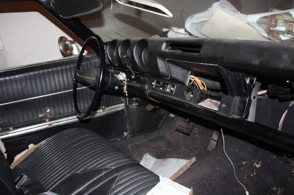

      WAY DIRTY interior but overall in good shape!
