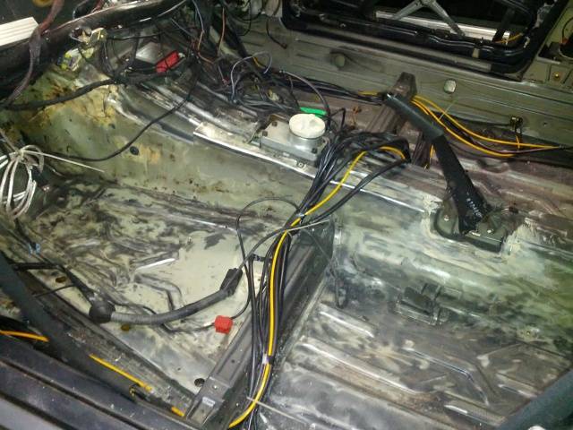

      So it's been ages since I did anything meaningful on this.
      So over the last few days, interior stripping got some progress, most of the passenger side done now. Think I'll get stuck into stripping out some wiring before I do the painting to make life a bit easier.

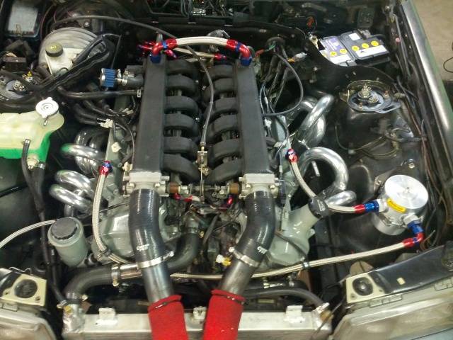

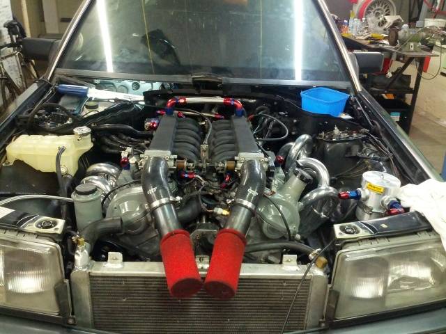

      More importantly, I got it to this stage:
      Nearly ready to make vroom noises again. Needs a top radiator hose found/made, coolant fill, breather hoses made and power steering fill and hopefully it should start.

      And it did!
      But of course, mo' cylinders, mo' problems. Definitely not running right. Has an intake leak somewhere and I can't really work on chasing it because it is very loud in the garage and my garage is under the house. Wife was not impressed with the "carbeque" smell through the house now from unburnt fuel and the fresh coating on the headers starting to smoke.
      So now I need to finish some stuff under the car so I can put the wheels back on and move it outside to start the investigating.
      Clayton

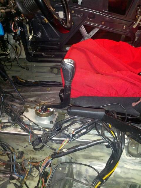

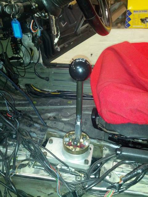

      Knocked over another little job.
      The shifter handle that came with the quick shifter was to suit our Holden Commodore (Pontiac GTO) and swept back.
      So I fired up the welder (which I am **** at) and made a new handle. I'm pretty happy with the result and the hand seems to fall quite easily from the wheel to the shift knob now. Important because racecar :D
      Aiming to have it back on its wheels this weekend.

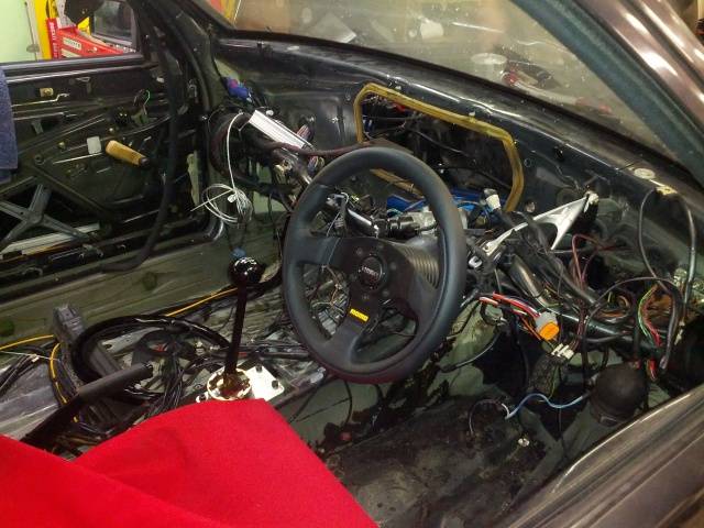

      So the old man came over and we got a few more jobs done. It's not back on it's wheels yet because a mate is coming to town next weekend and has offered to bring his guard roller with him which needs doing, so no point putting it down only to have to put it up again!
      Bled the brakes and clutch. I love my power bleeder!
      Did a spanner check on the rear suspension. I also started pulling out the rear swaybar. I had a thicker rear bar made and installed it early last year, but I'm thinking of doing so,ethng a bit different. In any case, I don't have a front bar until I get something custom made so rather than risk diabolical handling, safer to pull it out. I need to get a new jack so I can drop the subframe enough to finish pulling the bar out. If any one wants a 22mm rear bar and bushes, let me know!
      We then played with Speedflow to make some hoses for the cam cover breathers.
      Also finished off the radiator hoses and filled up with coolant.
      The old boy needed a job he could do sitting down so I got him to put on the little Momo wheel I got awhile ago. It might be too small, but I always wanted a little wheel so I'll give it a go.
      Next weekend will hopefully be guard rolling and if I have a new jack, swaybar out and then back on the ground
