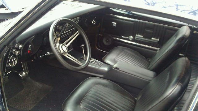

      The 700R4 came in a LOT of vehicles so your shifter options are pretty good. If you can find a way to look up all cars that came with this trans, then you could spend a night on google images looking at their shifter options. 1980's era autos with 700R4's often had overdrive and/or cruise control with switches near or part of the shifter and you can use these shifters to wire your locking torque converter to. I run a 700R4 and shifter borrowed from an 80's era Jaguar XJ in my '67 Camaro. The cruise control switch on the shifter is wired to lock up the torque converter. Not the best pic (was taken by previous owner), but shows the shifter mounted into a 2nd gen Camaro console.

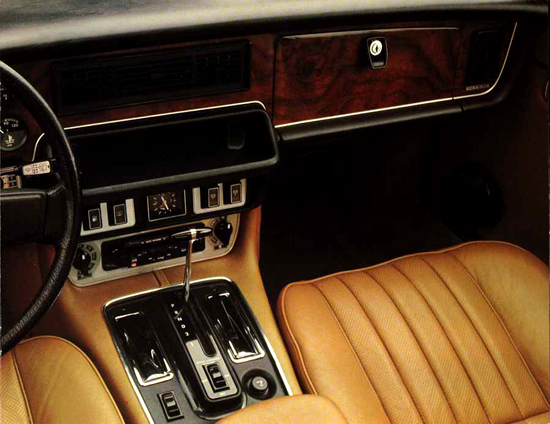

      Here's a close up of the shifter from some Jaguar marketing material.
