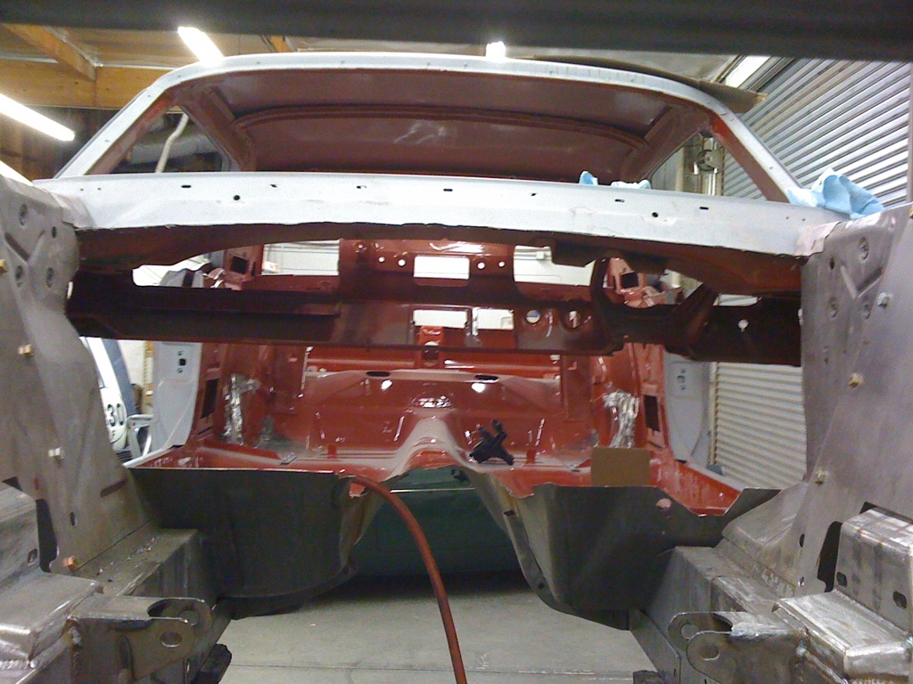

      Hi all, I finally got some time to start posting the build of this 1966 Mustang coupe. The car will have TCI suspension front and rear, Ford Motorsport Coyote crate motor and a T56 Magnum. I'm starting this post a little late in the build, so I'll bring you up to date. Body and all other sheet metal was chemically stripped, most of the bodywork is done, body is in primer, interior and trunk have been painted. The TCI front crossmember is welded in place and all the rear suspension parts that are bolted to the undercarriage have been fitted.Coyote engine was a recent customer change so we are going a little backwards.

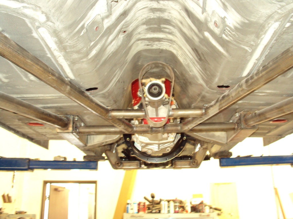

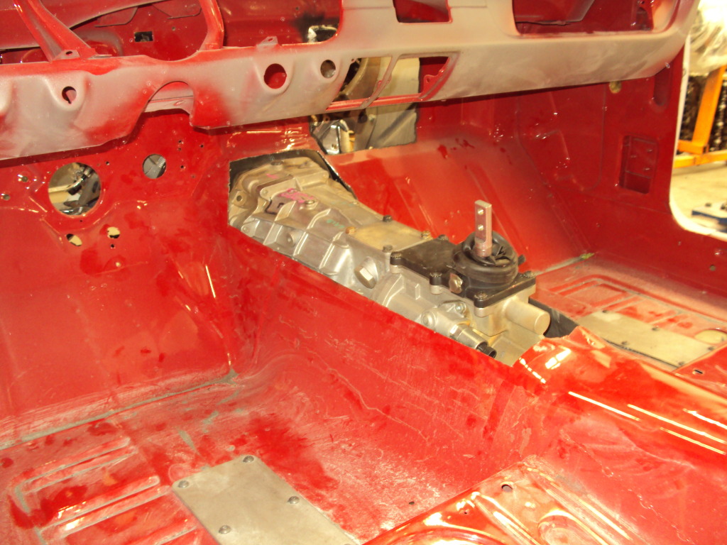

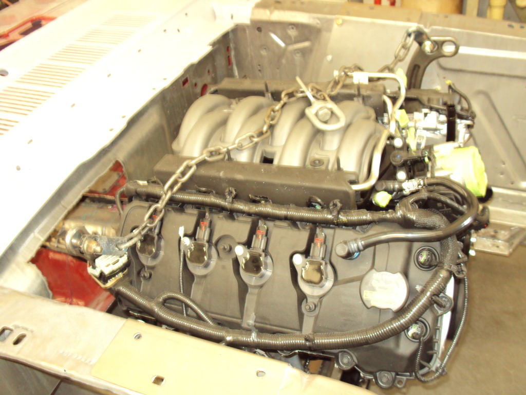

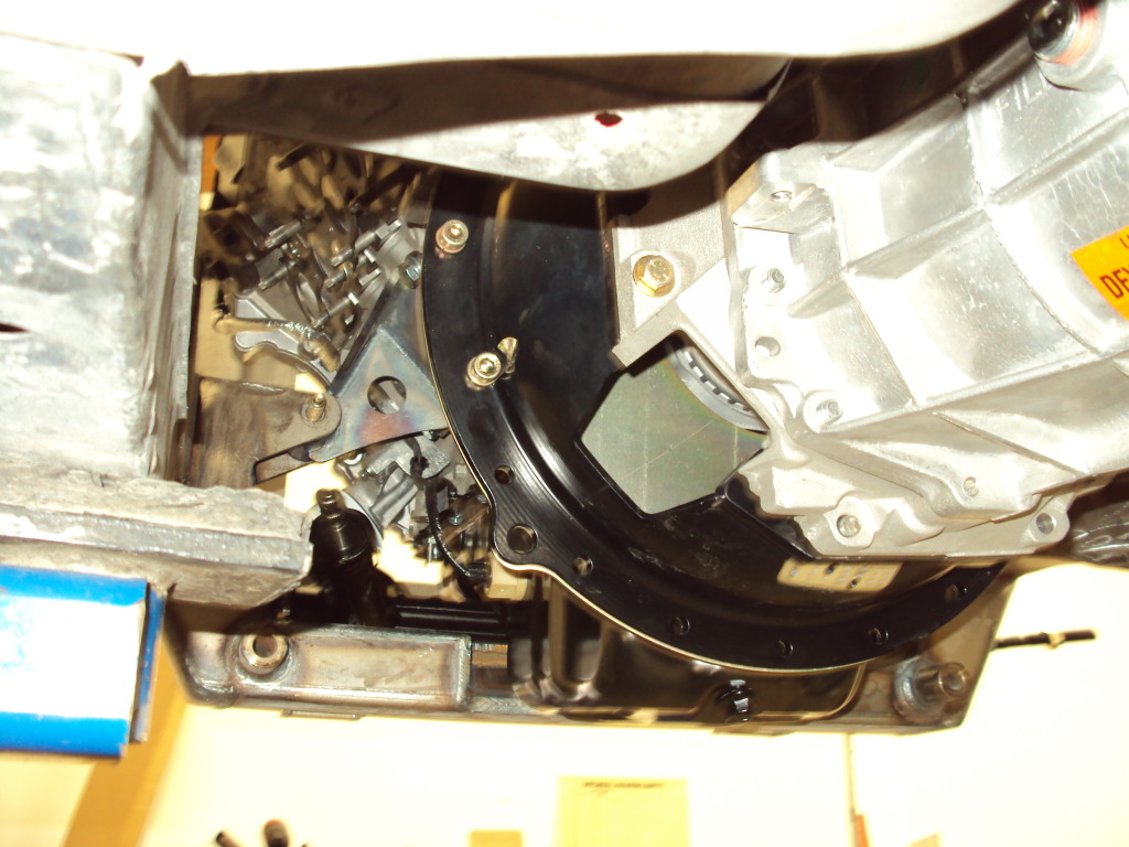

Size:  335.5 KBTime to start fitting the Coyote motor and T56 Magnum which was purchased from American Powertrain. The plan for this install was to get the engine as far back and down as reasonably practical to help overcome the forward weight bias that all mustangs have. Upon initial fitment of the engine we had to notch the TCI crossmember for oil pan clearance and decided to take out the stock firewall. We also had to cut the top of the trans tunnel in order to get the correct driveline angle.

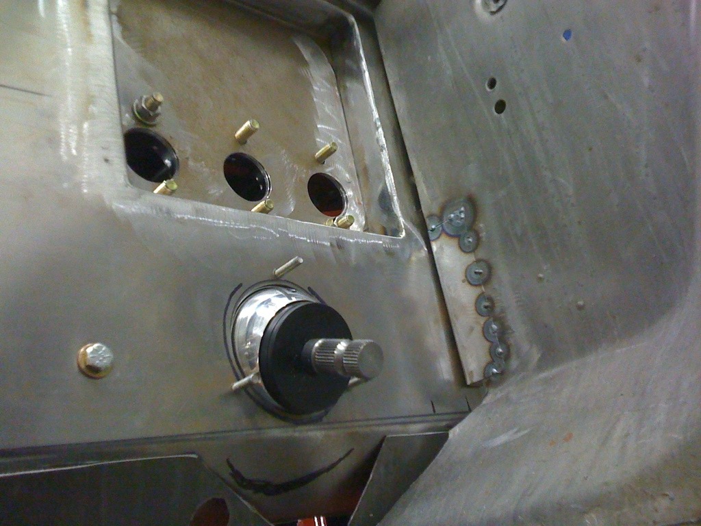

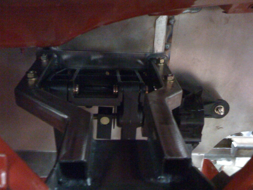

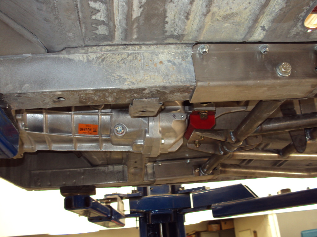

      The motor mounts are TCI, I believe they are for 4.6 and 5.4 engines, they move the motor back and down in comparison to the coyote mounts. Sal if your reading correct me if I'm wrong. As for the trans mount, I decided to make part of TCI frame connector/torque arm mount do double duty since the tubing TCI uses is stout enough and it was there. Since the cylinder heads on the coyote are huge, it was impossible to fit any std master cylinder and since I like my master cylinders and reservoirs in the engine compartment, not inside the car, I decided to use a wilwood pedal assy with the 75 series master cylinders which are about 3.5" long. Heres some pics of the motor and trans mounts, firewall and pedal assy.

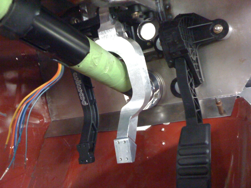

      I fabricated a support structure for the Wilwood pedal assy, tying into the factory mounting under the dash. Next I located and installed the gas pedal assy supplied with the coyote motor. I started to fit the Ididit steering column and I learned I had an oh ****! When I first measured for the brake pedal assy, I had the pedals stradling the column, but then I started allowing bfor the gas pedal assy which is huge. I ended up moving the brake pedal assy over to accomodate the gas pedal and forgot about the steering column. Well I like to play with my mill, so I ended up machining a custom brake pedal

      ^ Sweet pedal, almost to nice to hide up under the dash.
