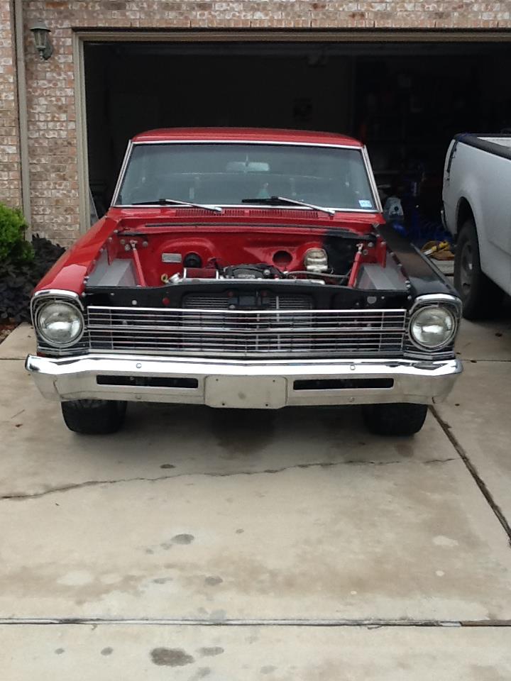

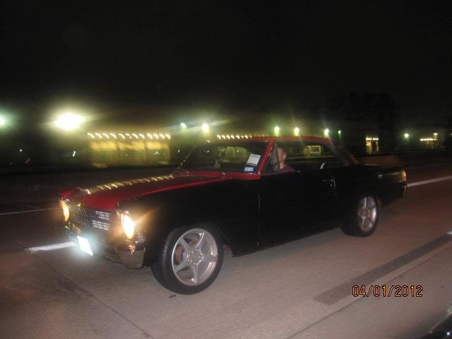

      Here are a few more pictures with the front end assembled, bumpers put on, LED tail lights in and in "drivable" condition".

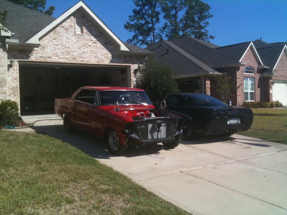

      It has been quite a while since ive been able to get some pics up. But Since my last few posts i have come along ways with the car, here are a few pictures of the car when i had it driving before it went under the knife again.Name:  11.JPG

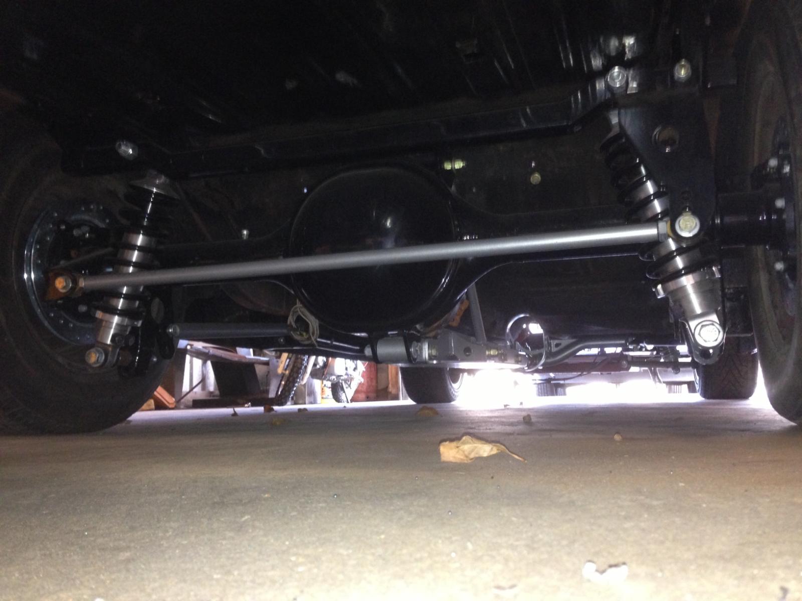

      Now for the good stuff, got a lot of parts in. Got a set of Wilwood 6 piston front brakes and CPP power steering rack. Got my TCI "torque arm" rear suspension (Included 9'' housing, 3.73 true trac posi, wilwood 4 piston rear calipers, aluminum double adjustable coil overs and 31 spline axles) As well as procar seats and GForce harnesses.

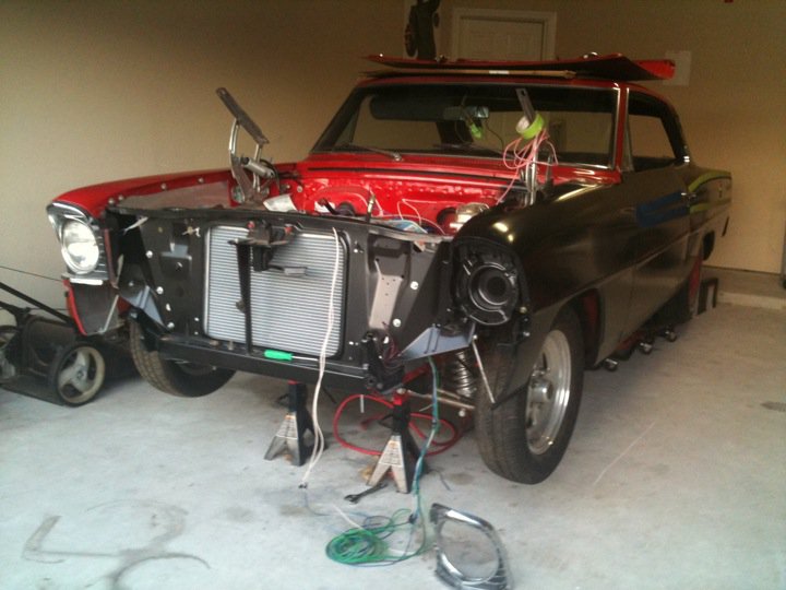

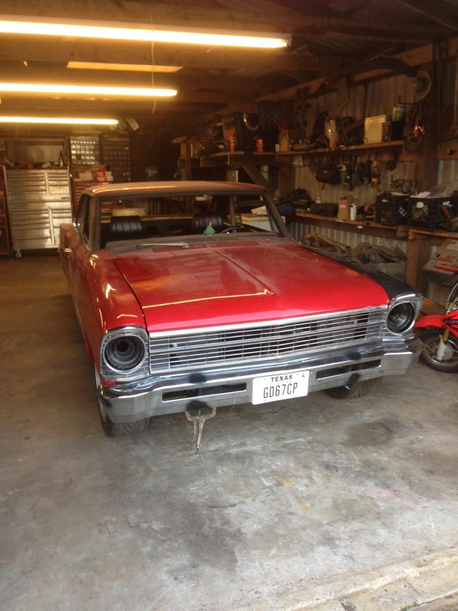

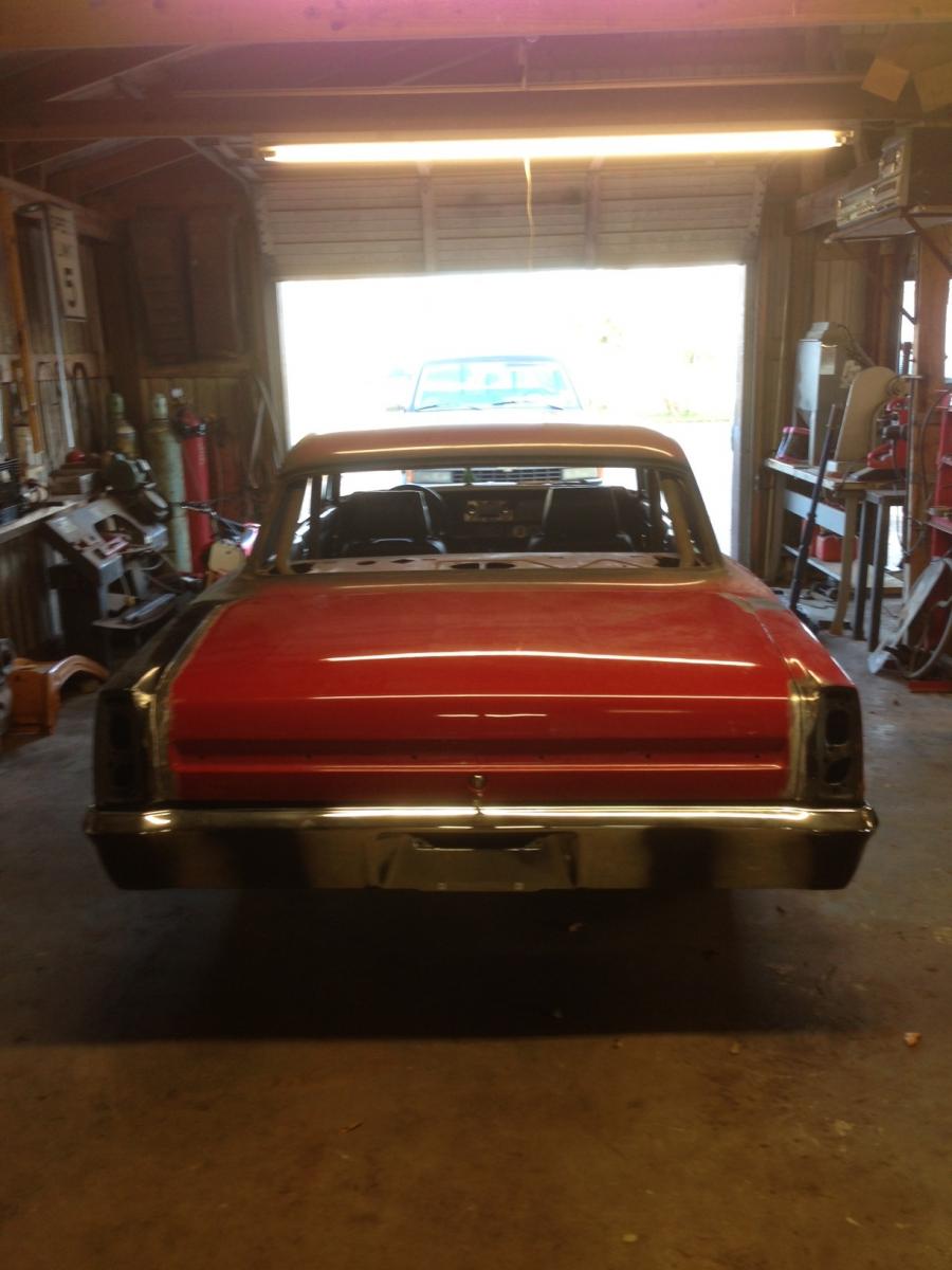

      Back under the knife...

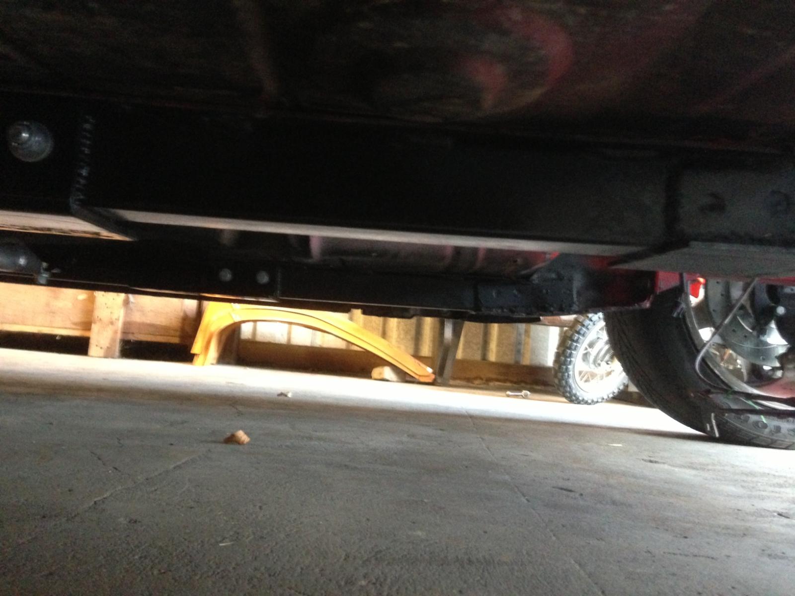

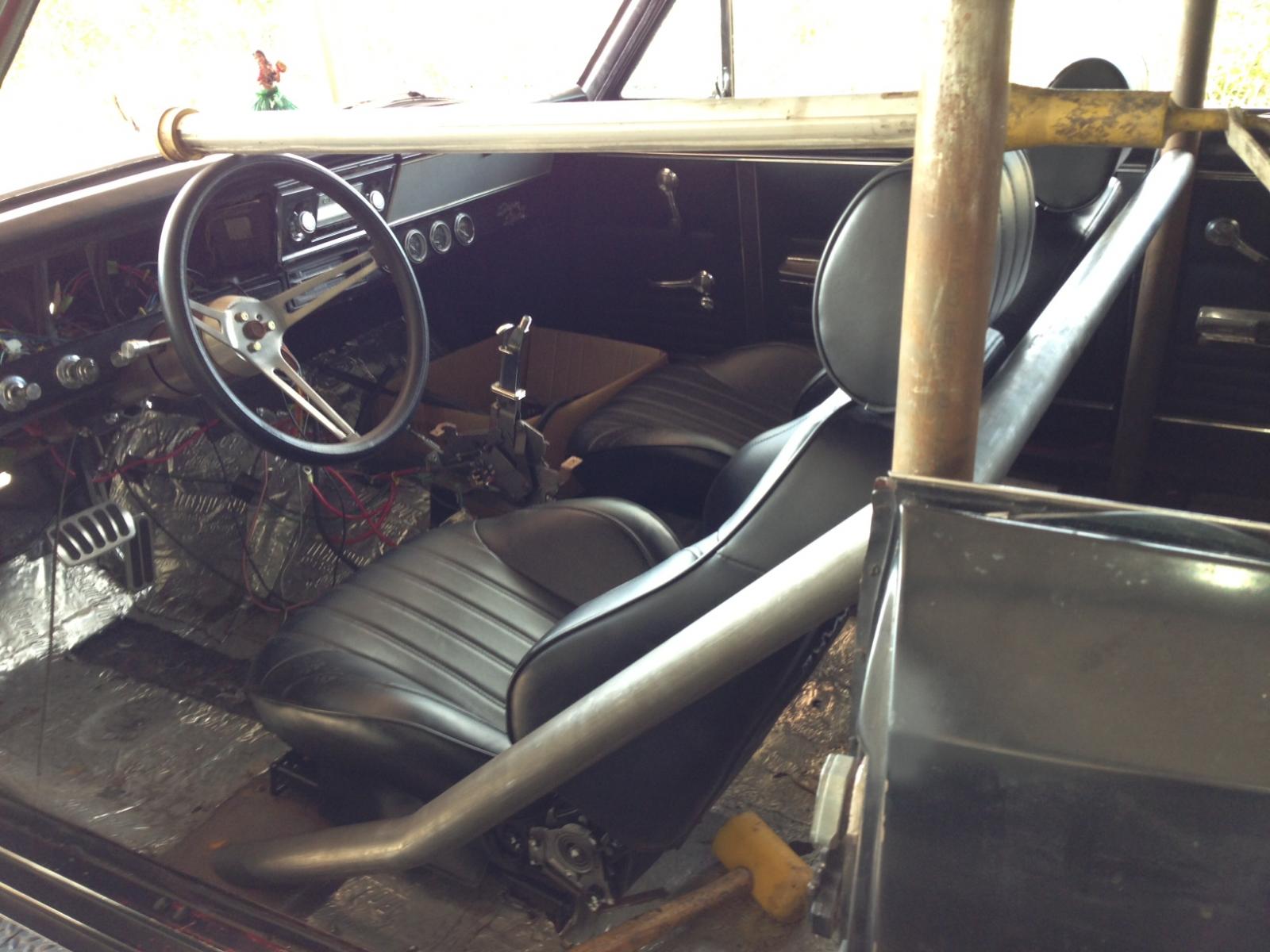

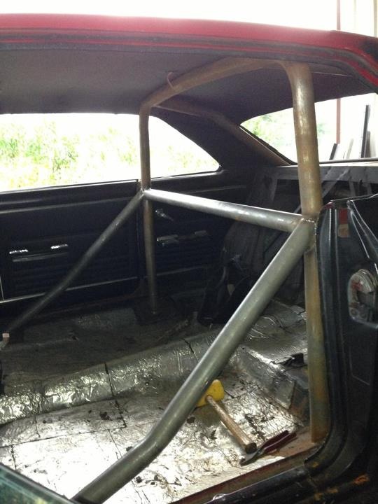

      After driving and enjoying the car for a while all the parts needed a new home so it went back on jackstands... After basically disassembling the car i started by replacing the frame rails with 10 gauge mandrel bent boxed rears. Replaced the front frame rails with the same material. Installed the rear end/suspension. Then installed a 6 point roll cage that i hand built out of 2'' .125 wall mild steel tubing. (First cage i ever even attempted making) I know that the cage isnt really legal but i dont intend to go faster than a high 11 sec pass, i also didnt want to have to climb over or deal with door bars on a street car. The reason i installed it was for a big piece of mind, needed a harness attatchment points and wanted the car to be as rigid as possible.After that i had a friend do the body gaps on the whole car (being half new sheetmetal needed it bad) He also filled all the holes in the firewall not being utilized, shaved/tucked the bumpers and got the doors/trunk/hood to pretty close to perfect.Name:  16.JPG

      Radley
      -1967 Nova SS
      -2009 Pontiac G8 GT
