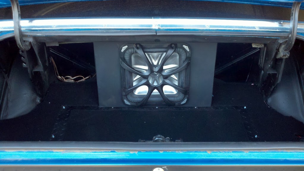

      Here is mine. I welded a couple brackets to the floor of the trunk and the sub box just bolts in place. 12" Kicker L5

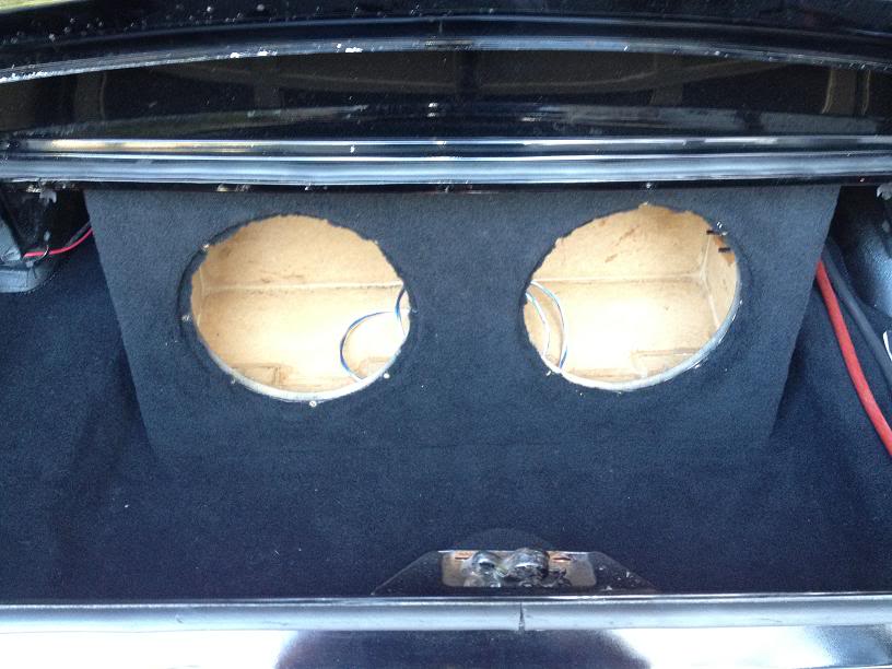

      I decided to build a custom box. I'm finished with the box and wiring, just need to mount it and build some closeout panels for the sides, but here's what I have done so far:
      Here's the basic shape of the box:

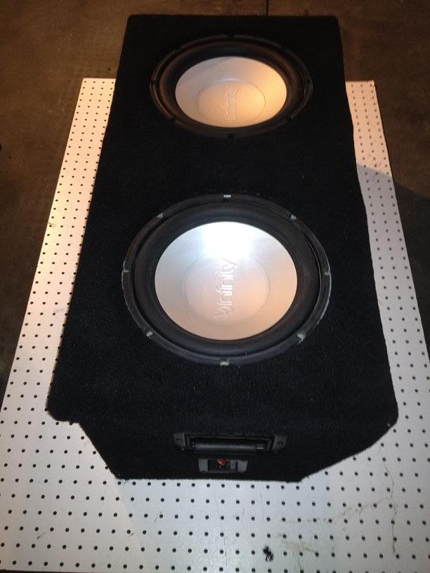

      Here it is test fitted:
      Amp rack in, trunk carpet just in for test fit:
      Here's the test fit of the carpeted box, I used the same cut-pile ACC carpet that I did for the trunk and interior:

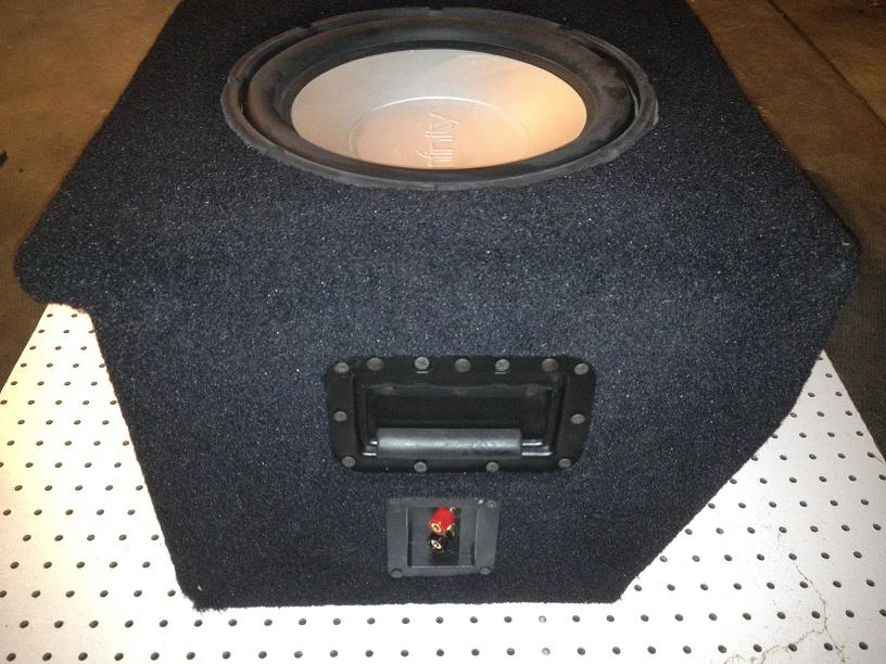

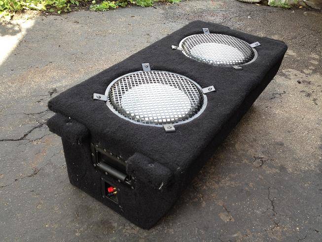

      And here's a shot of the box. I added spring loaded handles to both sides to aid in removal:

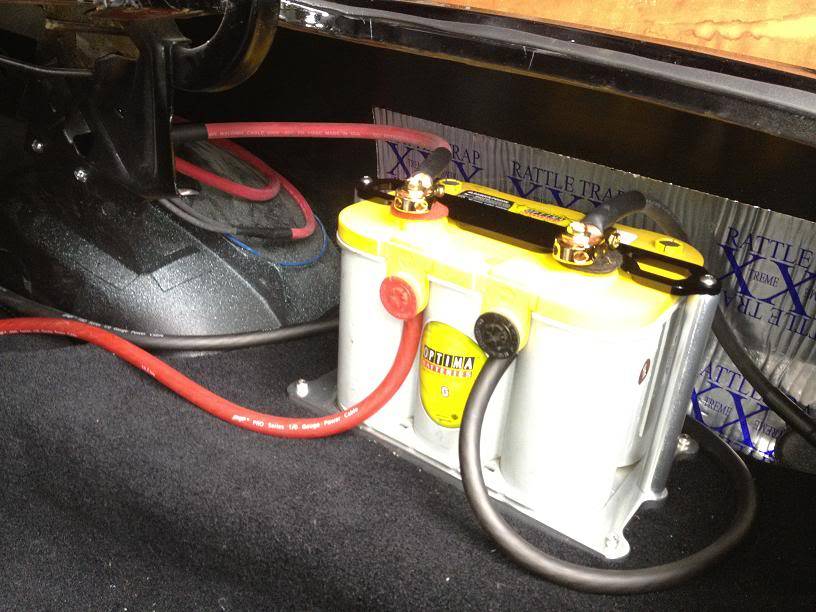

      I'm also relocating the battery to the trunk while I'm at it:

      Quote Originally Posted by nekkidhillbilly View Post
      be nice if you had some plugs for the speaker leads and put a handle on it
      You can see the handles and speaker terminals in one of the pics above, but here's a better shot:

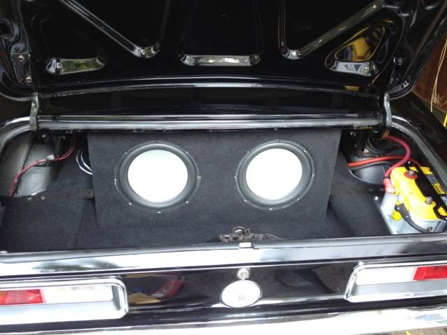

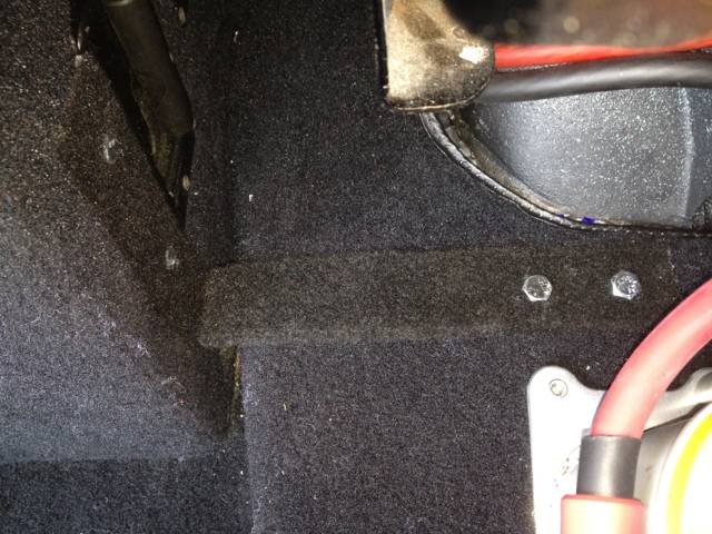

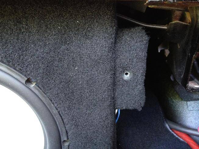

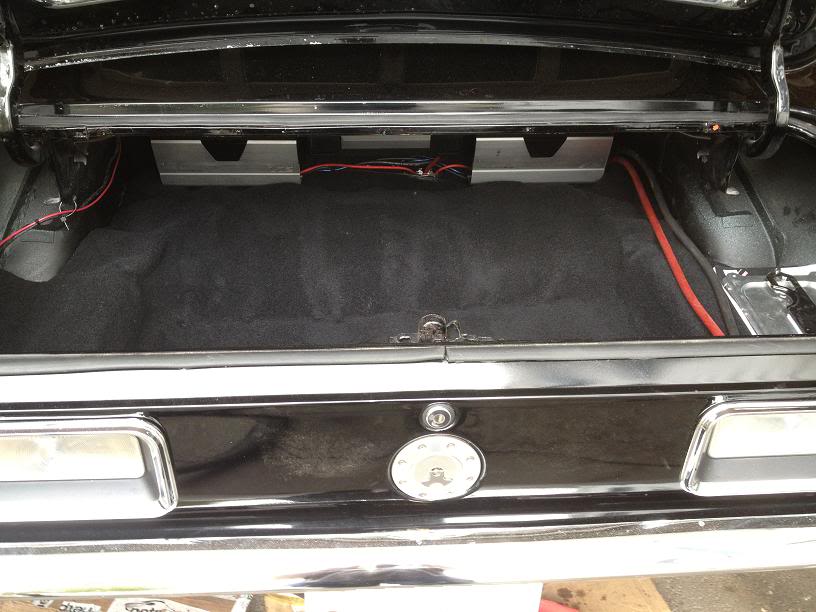

      I mounted the subwoofers to the box and mounted the box to the trunk. I wanted to be able to easily remove the box incase I ever AutoX it. I would just need to unbolt four 1/4" bolts from the sides and slip it out. Finding a location for the brackets I fabricated turned out to be a challenge. The rear frame rails run right below Everywhere I wanted to attach them. The carpet on them isn't a perfect match but eventually I will build some panels to carry the ends of the box out to the quarters.
      Brackets:
      Carpeted and bolted down:
      This is where I left off. I still need to add some grilles to protect the subs:

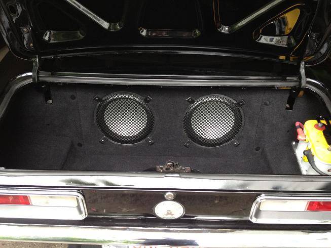

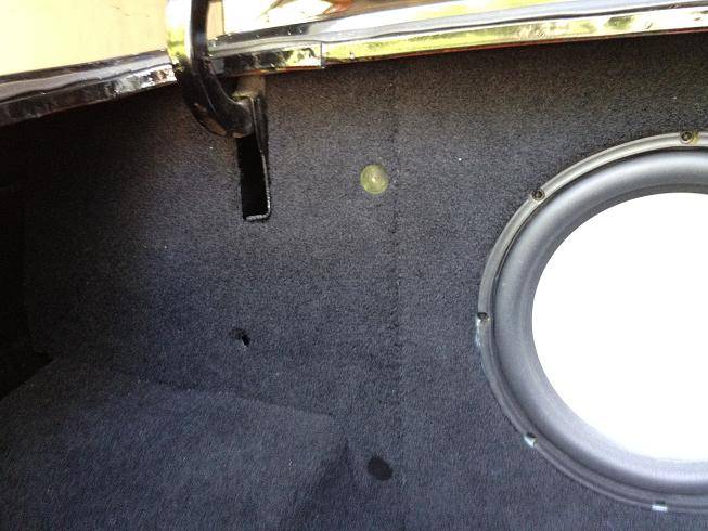

      I finished up fabricating and installing the closeout panels for the trunk. I mocked them up with some cardboard first:
      And then cut the panels out of luan:

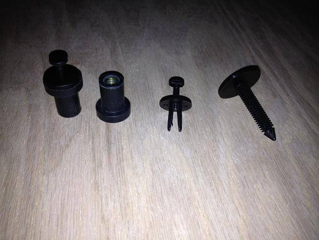

      To hold them in place I picked up a couple different automotive fasteners, and a weird rubber nut with a threaded end on one side and a boot on the other:

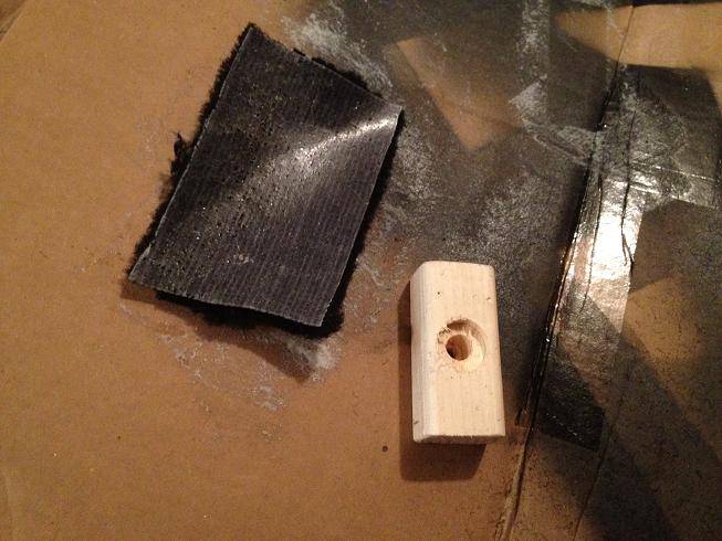

      I cut a couple of blocks and drilled out for the rubber boot and wrapped them in carpet:
      I attached the blocking with some 3" drywall screws:
      I wanted to use the push button style fastener, but it didn't hold as well as the one with all the ridges. Here's one of the panels carepeted and installed:
      I'm pretty happy with the look. Clean and fairly simple:

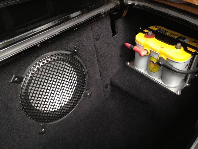

      I added some grilles to the subs while I had it out of the Camaro (again). I'll probably look for something a little less rugged, but these will keep anything from puncturing the speakers in the mean time:
      A closeup of one sub and the battery:
      And another pic of the whole setup:
