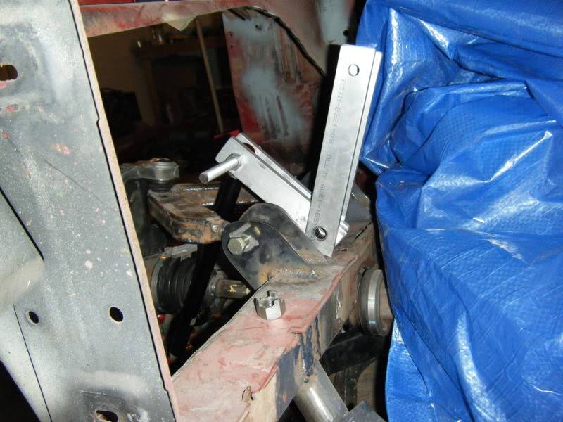

      I know that this is really not advanced tech but i figured that guys who check this area of the site out would be more likely to be able to help here. I need 2 simple sleeves made up for the push rod front suspension im building. All i really need are 2 tubes with a 9/16 OD and would prefer a 1/2 bore but 7/16 would be fine too if the wall was way too thin. These will have a bolt pass thru them so they will not be unsupported. Length will be somewhere between 1.5-2.0 inches, not sure the exact length yet. Material, would prefer stainless steel so it will not rust. To give you an idea of what I need, the sleeves will go in the needle bearings of the rockers at the frame mount (pictured below). I need sleeves so I can properly tighten the bolts without causing drag on the rocker. I plan on finding some bronze thrust washers to put between the 6061 rocker and the 1018 frame bracket that I have yet to build. Please PM me or reply here if you can help, ill obviously pay to have this done and would greatly appreciate the help!

      I've got some .563 (9/16) x .065 wall 4130 tube. OD of .563, ID of .433. No lathe required.

      Rite.....my bad, never thought to check if something off the shelf would exactly fit my specs. I used 3/4 120 wall DOM once to put a 1/2 inch bolt thru.....once. Way too much slop for me. I want this to fit perfectly which is why i figured it would have to be machined. I found 316 stainless tube with 0.5625 OD and a 0.4325 ID. I guess I can run a drill bit thru it if necessary but would a 7/16 bolt fit thru that or does that 0.0050 really matter?

      Thanks for the reply's guys. I looked into those shoulder bolts but i never saw one in 9/16. I sort of have to keep that bolt size because it worked out perfectly for what I am building. I wanted to use 3/8 thick bar for the arms of the rockers. That gave me the perfect 3/4 inch spacing for the rod end and also the 1.5 inch spacing for the coilover at the other side plus it is what i feel comfortable for its strength. The needle bearings were only available in the 3/4x3/4 with a 9/16ID. I asked if there was something with a 1/2ID yet still the 3/4 width but no luck there.

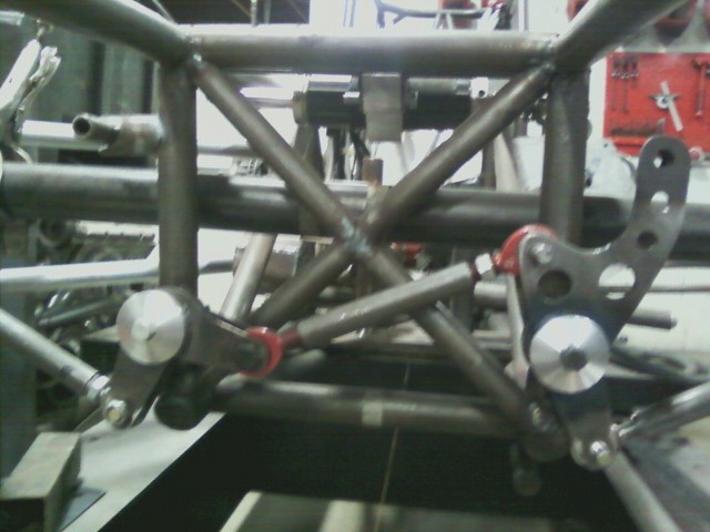

      I used these on my supermodified front suspension: http://www.timken.com/en-us/products...CupRoller.aspx
