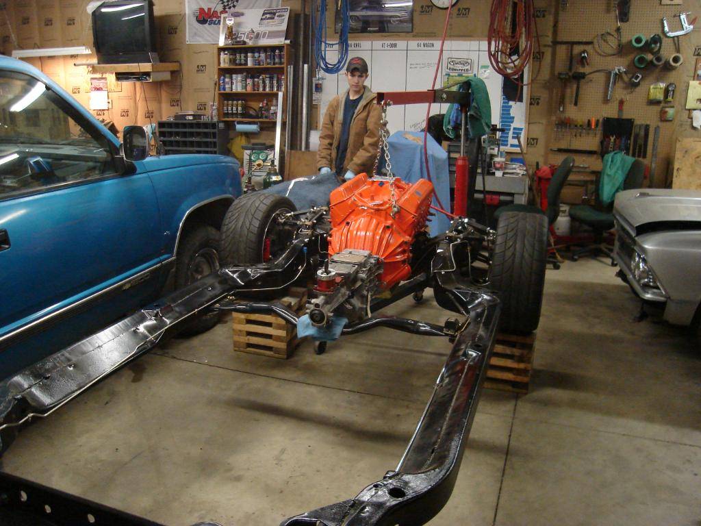

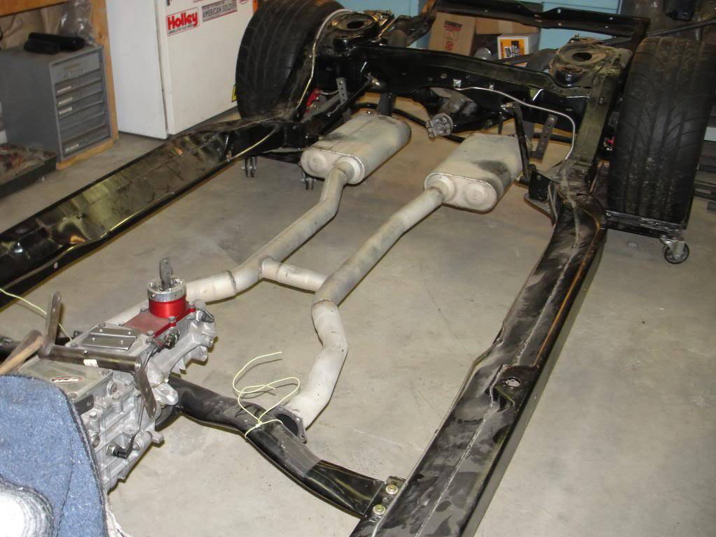

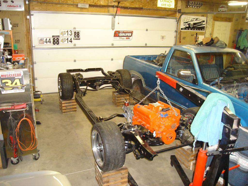

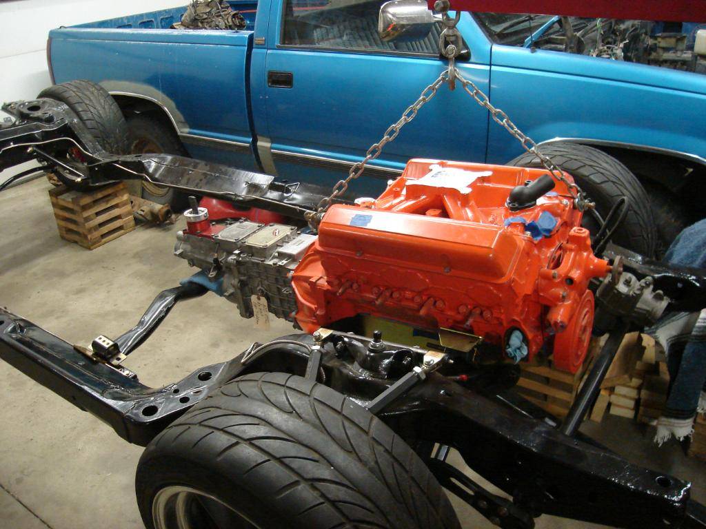

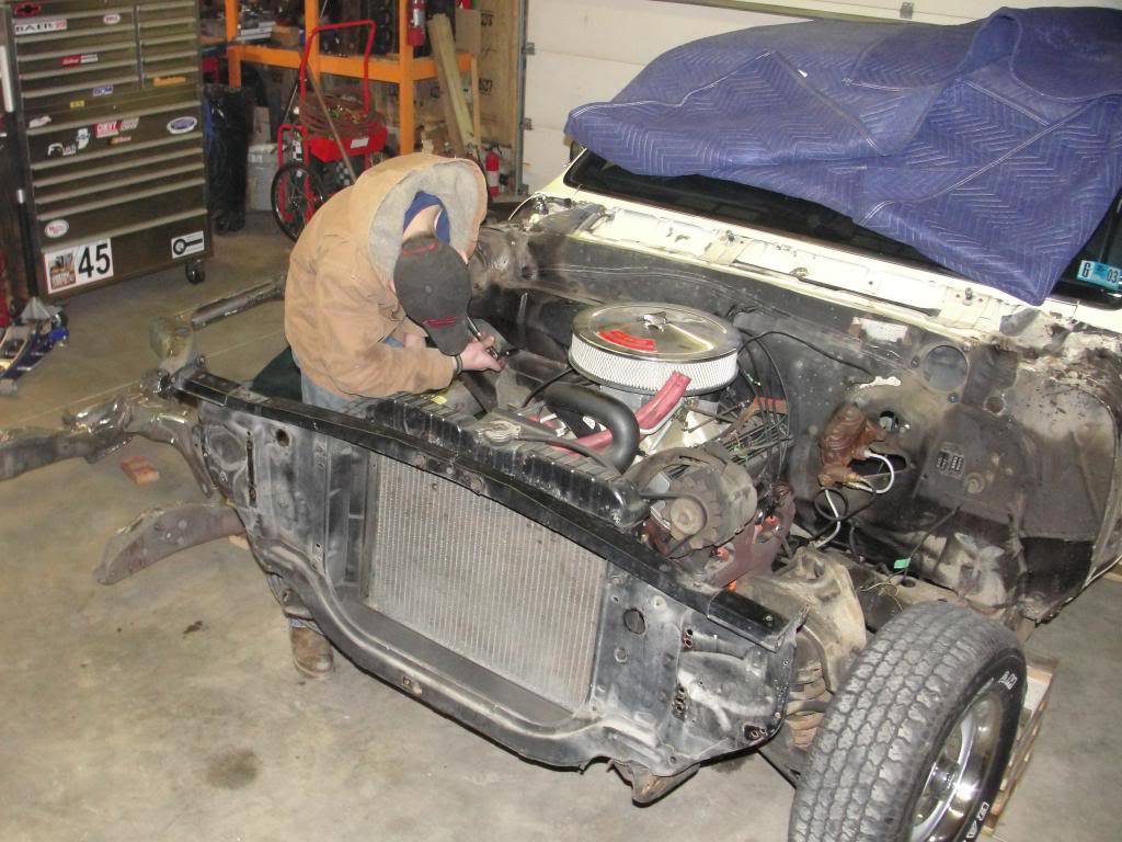

      Finally finished the brake a fuel lines a while back and set the engine and transmission this afternoon. The body is close to coming off the old chassis, but two body bolts are being stubborn.

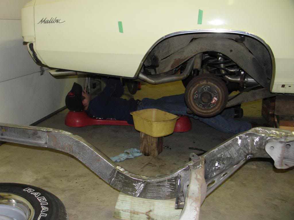

      We've been selfishly working on our 66 instead of Andy's. But, now it is again time to make some progress (complete) Andy's 66.
      The 2.5" Flowmaster exhaust that came off of our 66.
      Covered and waiting for us to finish the thrash on our 66.
      Sam working on something. Probably the super stubborn body bolts.

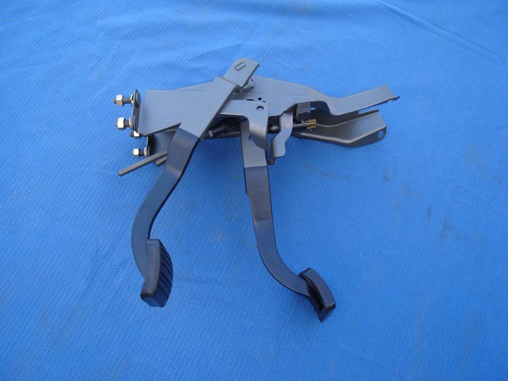

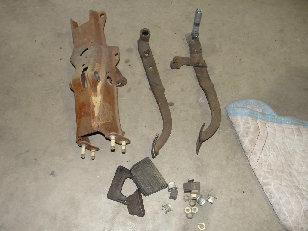

      Getting ready to rebuild the clutch and brake pedal assembly.
      Rebuilt
      Sam taking things apart on the firewall.

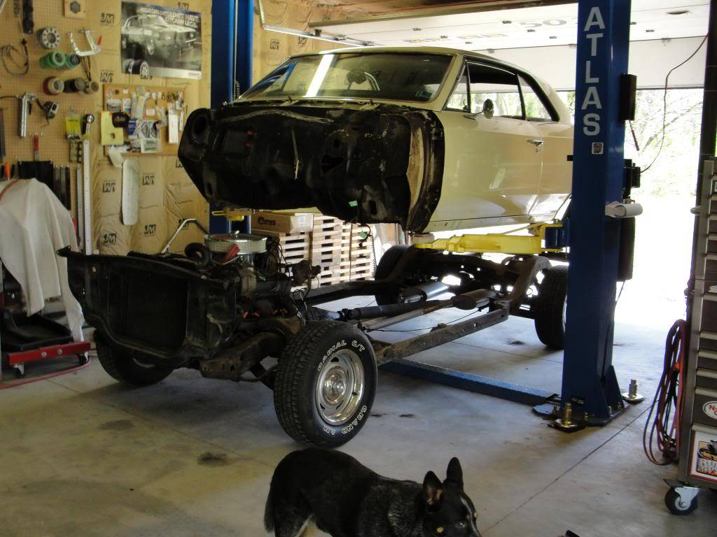

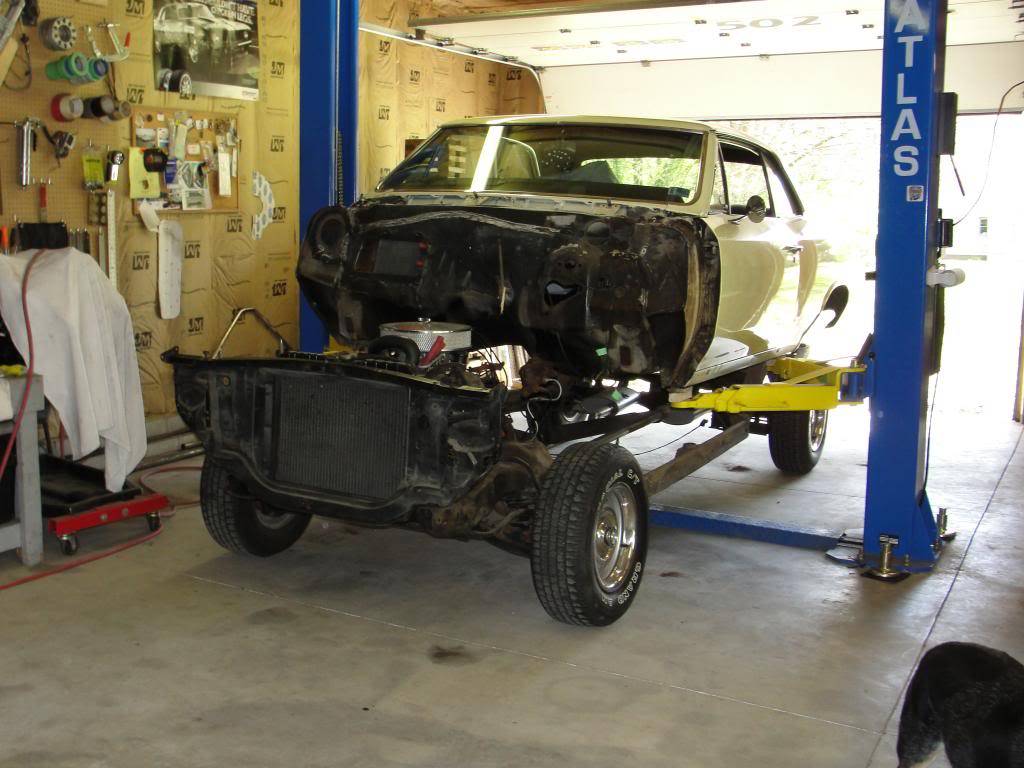

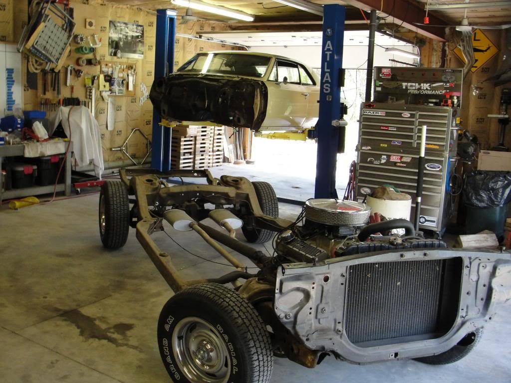

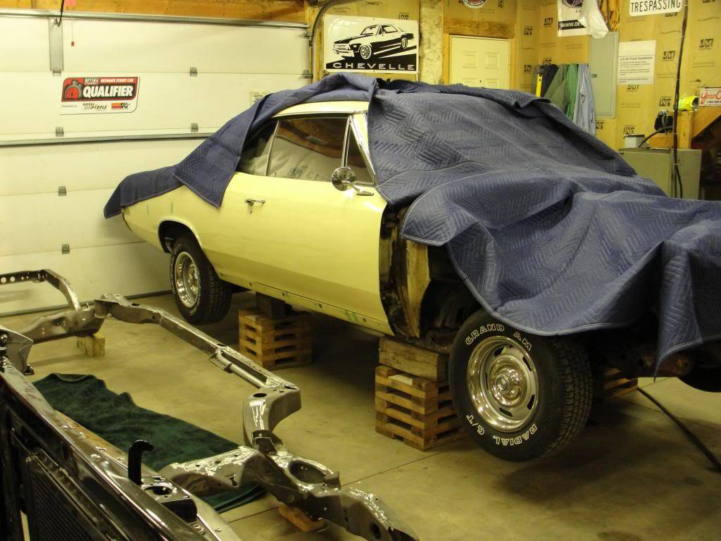

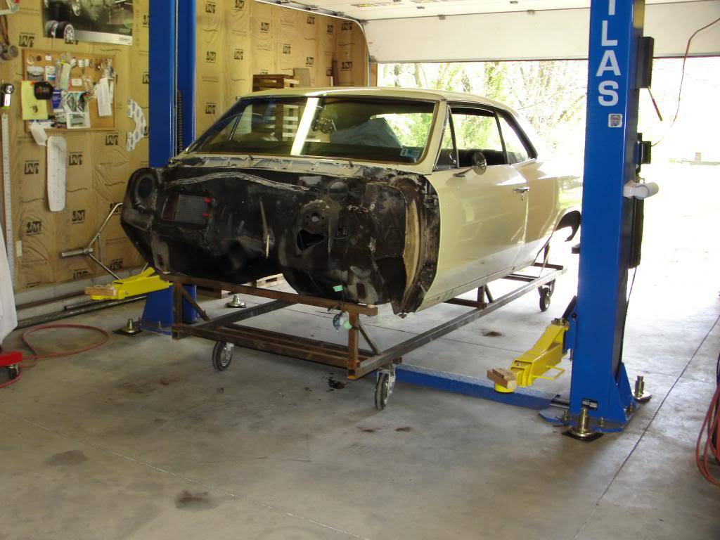

      Body finally coming off the chassis.
      Safely set back down on the body dolly.

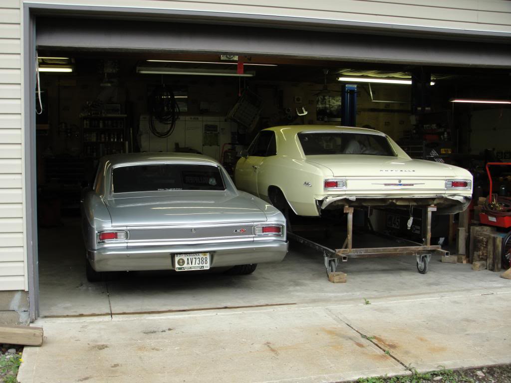

      Just thought this was a cool shot of both 66's together.

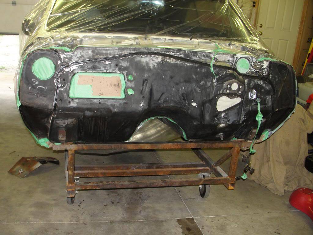

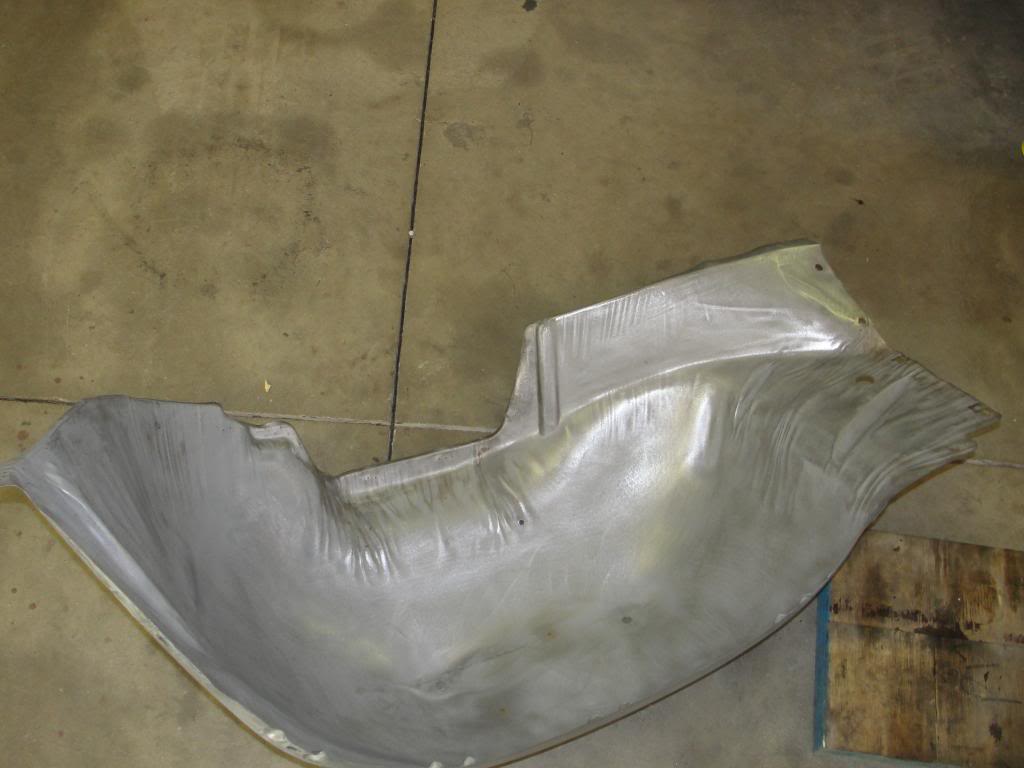

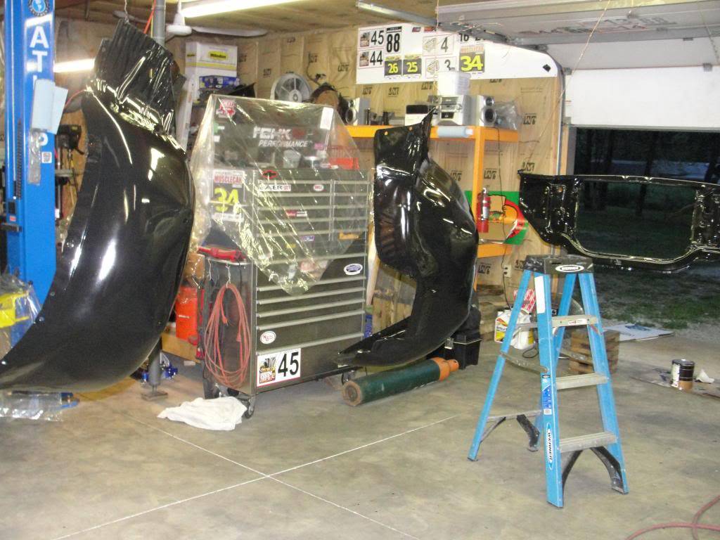

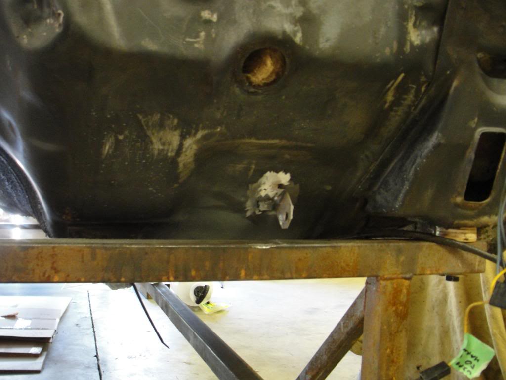

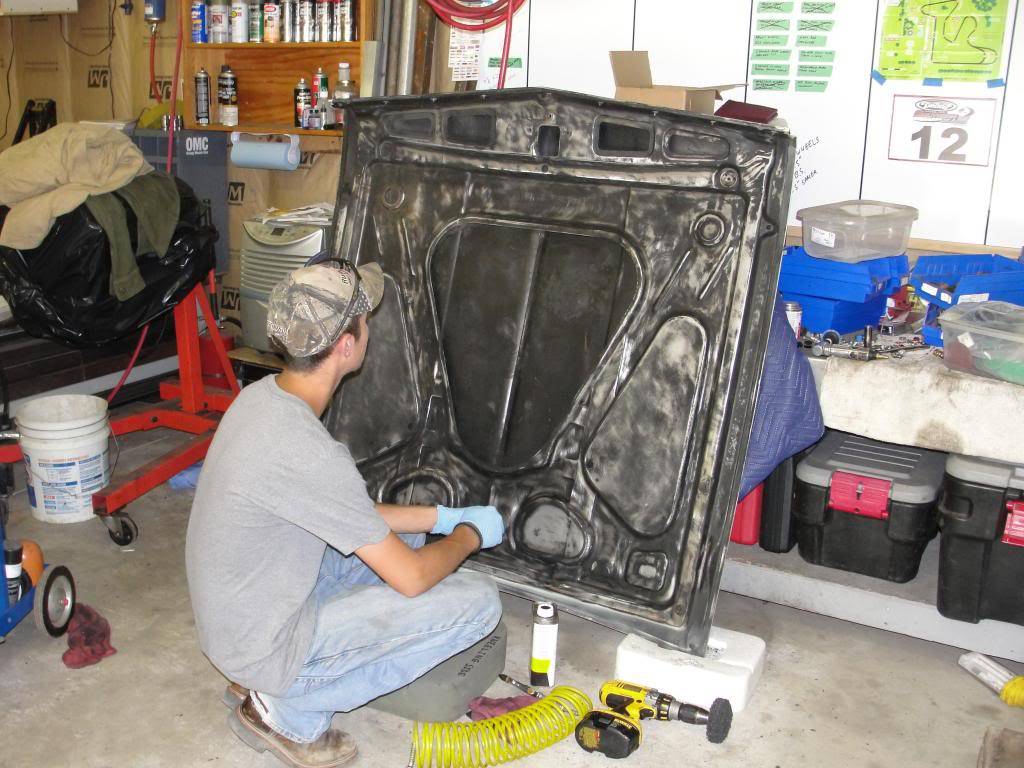

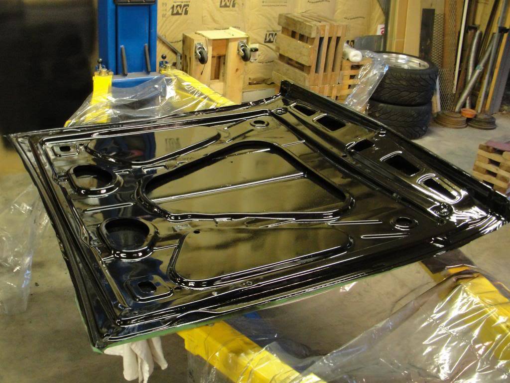

      We made a huge step forward last night with the painting of the firewall, core support, inner fenders and bottom of the hood. Seems like these would be quick to prep and paint but the firewall and bottom of the hood were covered in a gooey undercoating and every time we thought we were close to being ready we would find more goo. Sam did a large amount of the prep but when things started to bog down Deb and I hopped in. Finished up last night and all looked great.
      Inner fenders were chemically dipped and then sanded to give the paint a good surface to stick to.
      Sam working on cleaning and sanding the hood.
      firewall prepped for clutch return spring bracket install.

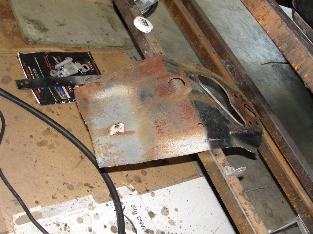

      Cut this off a parts car for good measurements.
      Welded in position.
      Firewall prepped, seam sealed, and everything taped and masked.

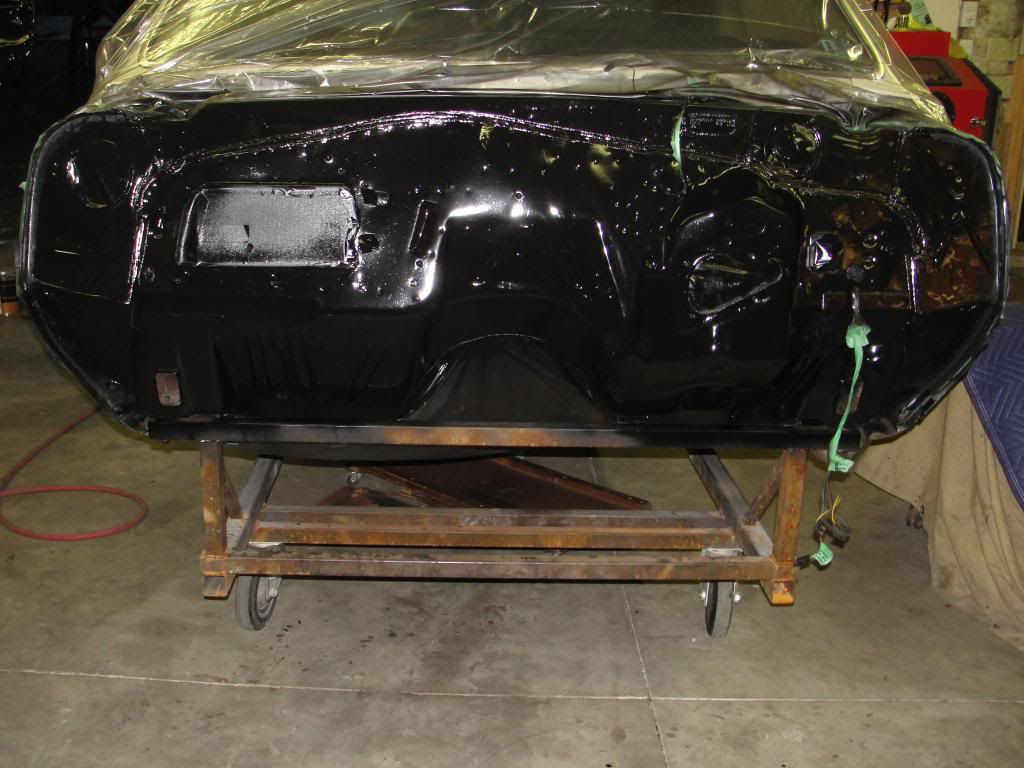

      Painted parts
      Very happy with how everything turned out. Next is modifying the trans tunnel to allow for the TKO 600. TMI seat covers are on order.
