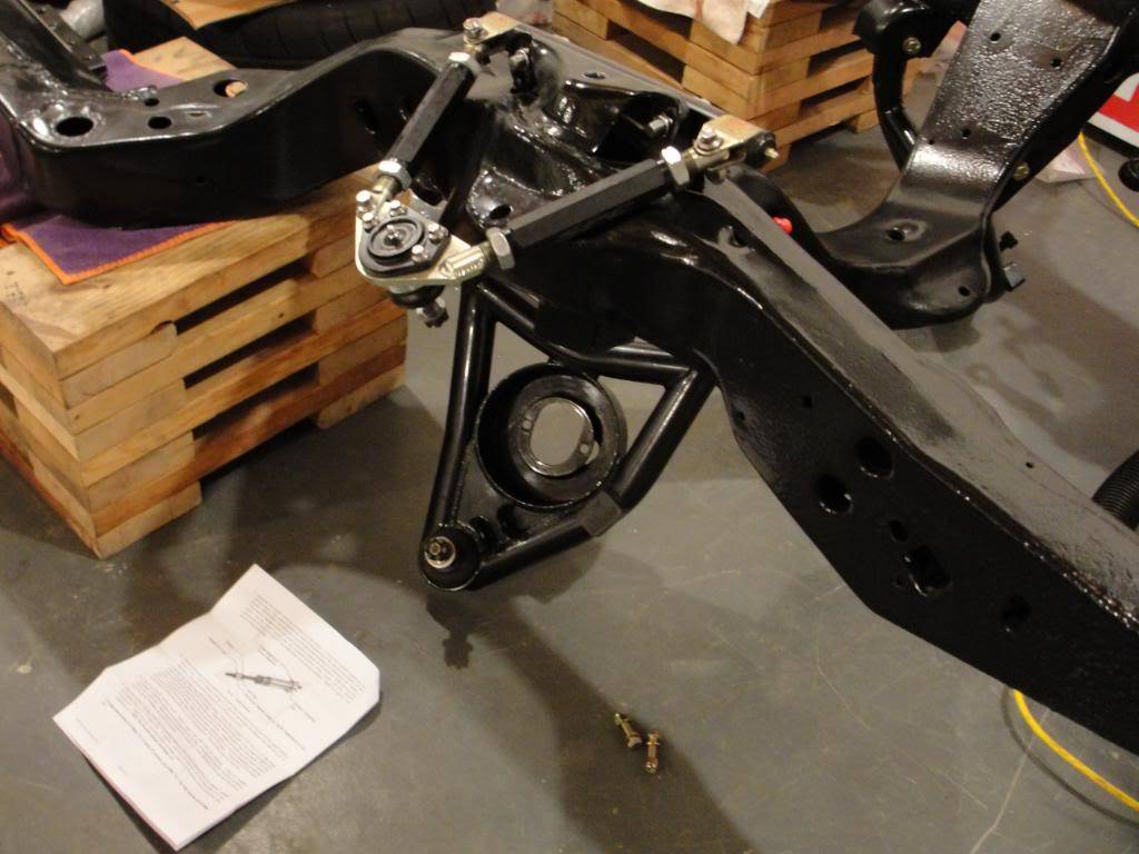

      I'd love to see a write up on the installation of those coilovers as that's something I might be interested in installing one day. Have Sam take lots of pictures.

      The fronts are really simple to install, but the rear is much easier with the body off the chassis. Pretty much just as the instructions say.

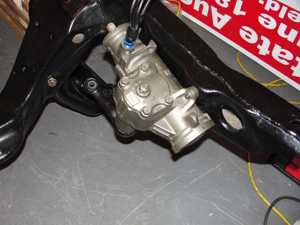

      Jeep Grand Cherokee steering box
      Front suspension as it was going together

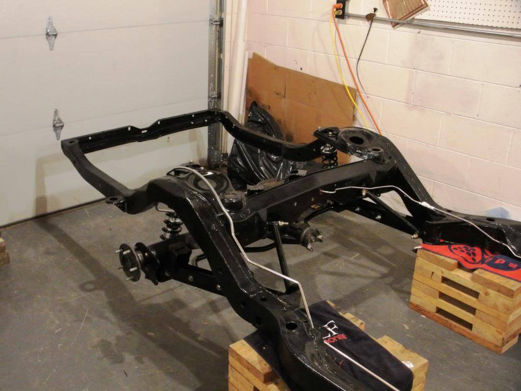

      Rear suspension together. Next will be ordering all the miscellaneous steering components and restoring all the clips and brackets that we need. Always helps to have a field full of Chevelle's!

      sweeeeeet!..i feel sure them DSE coilovers will handle and perform nicely!

      Yep, the same ones that are on our 66 right now. Working well for us!

      Can I ask what year the box is out of and what is needed to make it work in an a-body?

      You can use the '93-'98 Jeep Grand Cherokee box. You will need your pitman arm, new coupler and inserts for the metric fittings on the steering box. Call Lee Manufacturing and they can hook you up with the parts needed outside of the box and pitman arm.

      Yep, exactly what Chris said! I actually found and printed the information from the technical reference pages on Chevelles.com.
