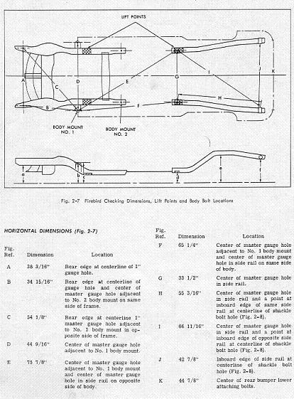

      Use these pictures to help you figure out how high each point needs to be:

      Wow, thats some good info! Thanks a million. I had already finished this up and got them all level within .125". I'll check it compared to these specs and see how I did. Thanks again.
