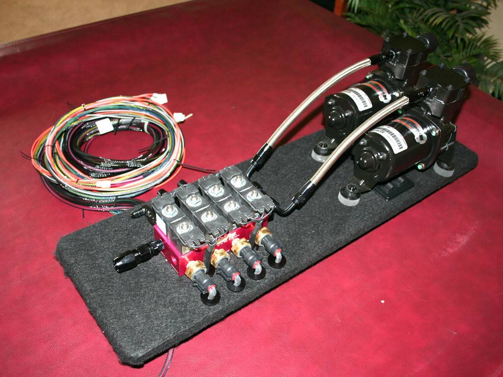

      Yup! Im with Britt on this one. A single is all thats needed, if its a quality unit. And Ride Tech has them. NOW!! I did do some wiring to modify the two compressor system. I wanted more control of the compressors. So I wired in two switches. They are three position switches. Basically the three points are computer controlled, thats where they are set always, or ON (meaning they are on no matter what) or OFF.
      Yup. can turn on the compressors when the air ride system is off. For example if I want some air in the tank without turning on the air ride or car for that matter. Its basically an air compressor at that point. And I can turn off one of the compressors during normal operation for what ever reason. I have control issues no doubt, but only with the car...

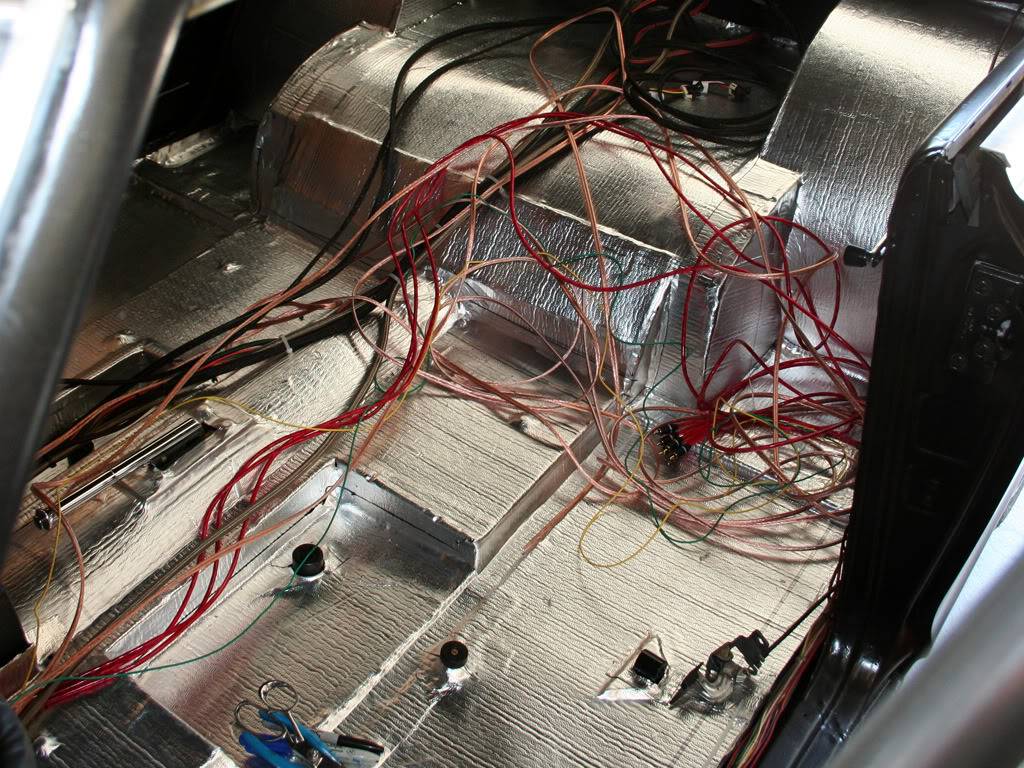

      Oh wait? The routing of the air and control lines? That WAS your Q. I replaced the plastic air lines with stainless steel braided lines. Why? No reason, they are NOT better. In a way they are worse, they are heavier. But I have hundreds of feet of SS braided line in my garage so I needed a use.
      I routed the air lines and electrical control lines IN the car. For no other reason than because it was simple. No more than that. Ok more than that. I wasnt comfortable running the air lines on the outside of the car. It was NOT a coincidence that the air lines fit better inside the car. It was a predetermined choice... JR
