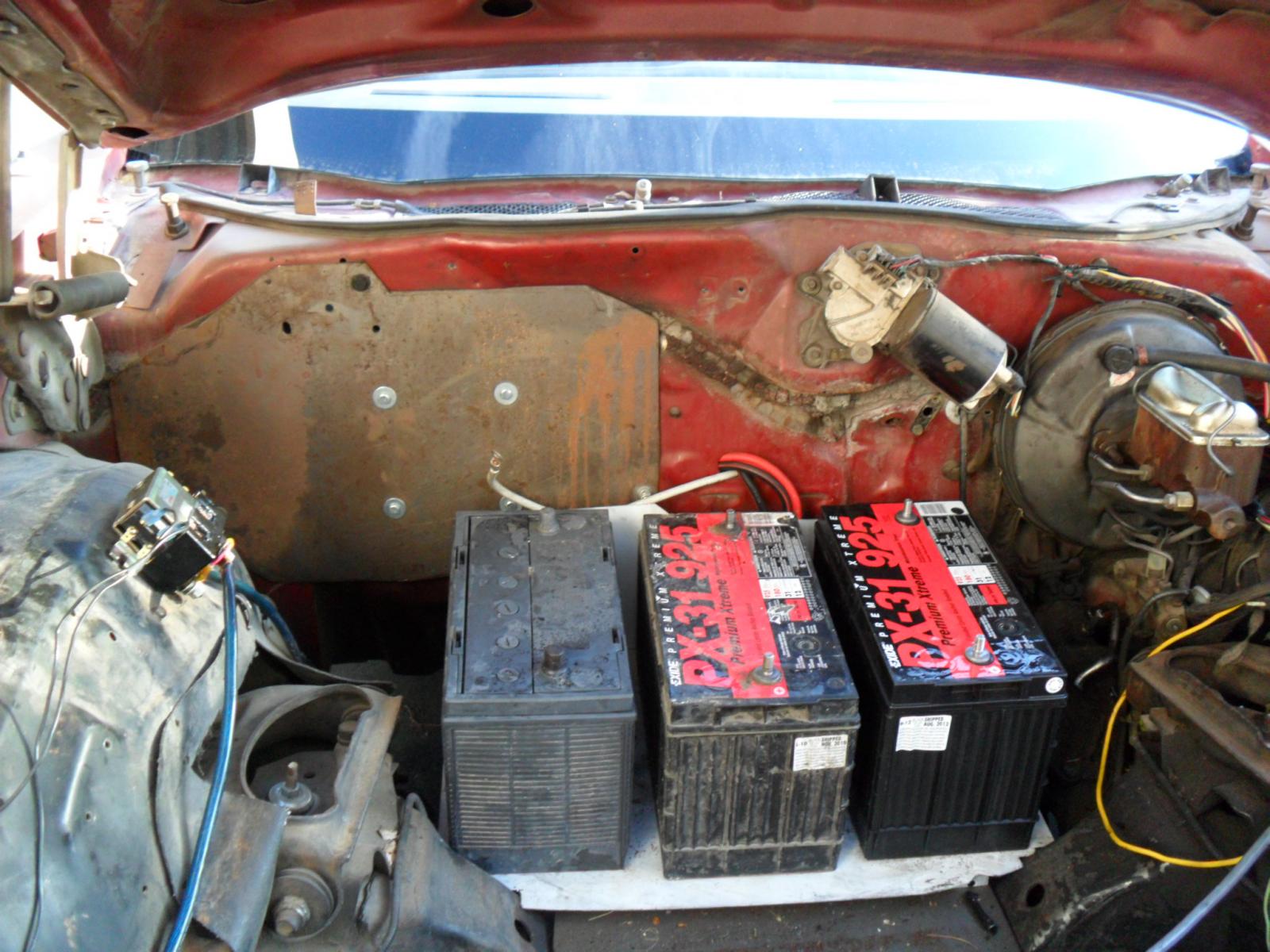

      Getting the trays done as low as I need and want , has kept me up when I had the time . I'll post picks of the trays as soon as they are welded up . I'm going with lead acid battery's .They are cheap and can take a beating .

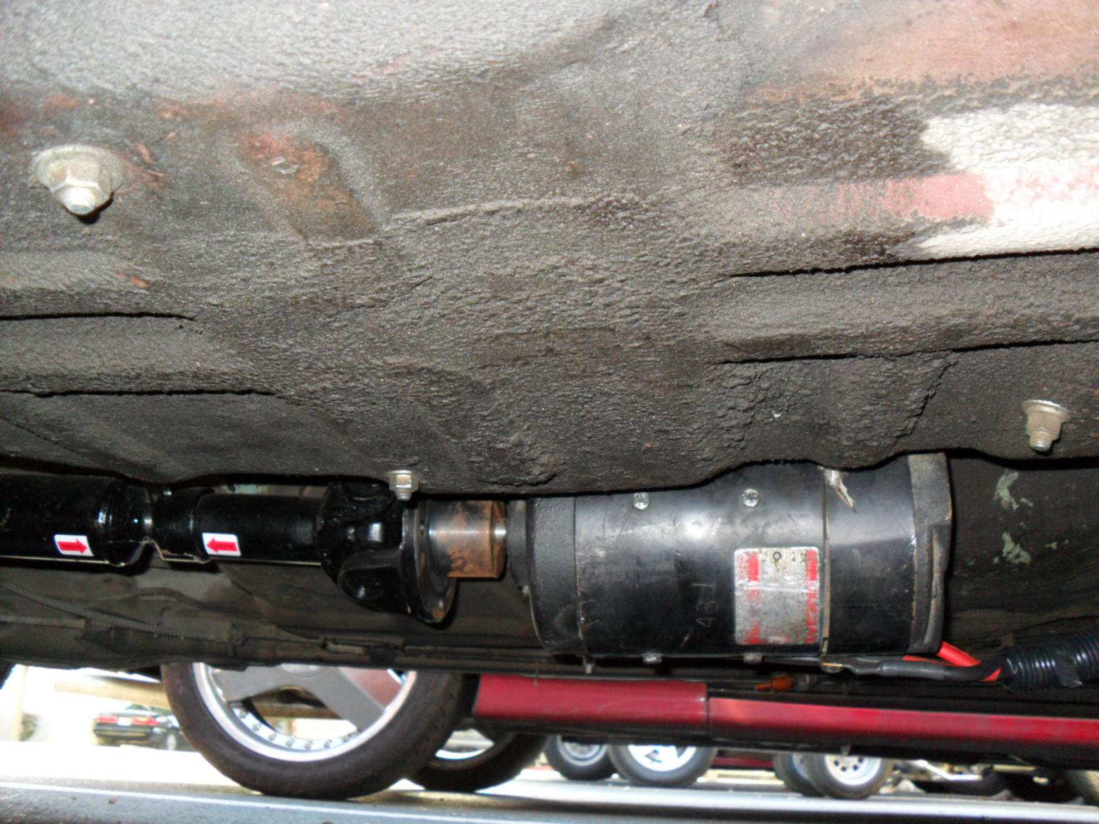

      I had to pull teeth an eat soup for months ......
Size:  229.4 KBName:  Picture 412.jpg
      I got the parts in the way I wanted and it works , the brakes and light , the tray's work perfect and the motor turns the way it should . But the controller does not work and or my batteries may be dead and or not the power for the controller , I have no charger yet so I'm S.O.L. .(side note ) For people that want electric cars , they don't help very much .
      Well , it's time to send it to the shop for body work like I all ready planed for Auguast . I'll try to get more pictures . The grey battery fell on the camera , so give me time . I think the motor mount I made for the motor is really good and so does most people that see it . Well , more baby steps to come .
