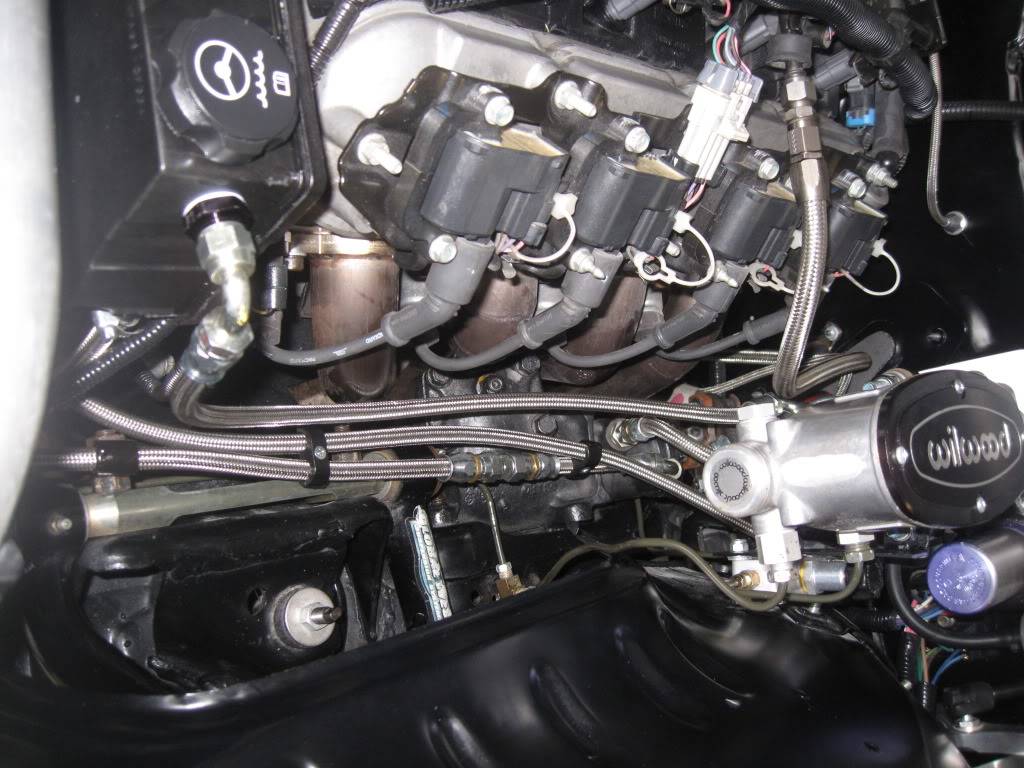

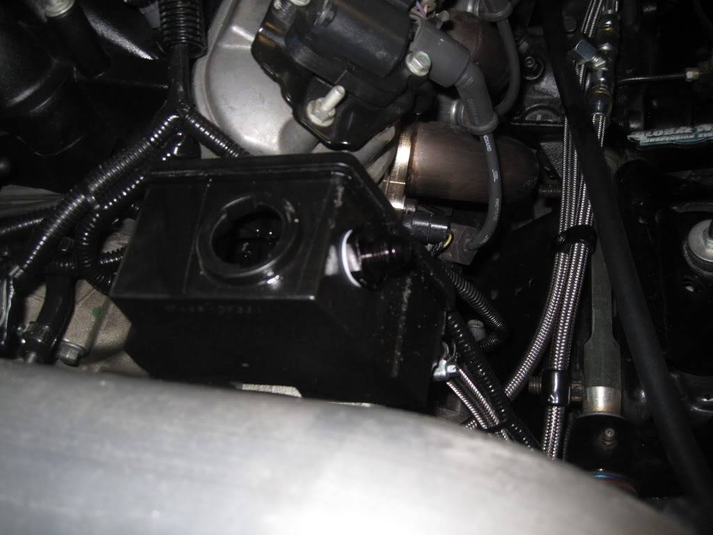

      Fixed! That's right, Who's bad? No just kidding, without the help form the guys at Hydratech and the people on this site I'd still be banging my head against the wall. The bulkhead adapter came in Wednesday and I made a template from a coat hanger to get the length of the new, dedicated return line. The guys at Charleston Rubber & Gasket have been great throughout this build and they helped me out again with the longer hose and the male - male -6 AN to replace the T.
      The noise, foaming and premature brake pressure are all a thing of the past. Now it's time to move on and work towards getting this thing on the road where it belongs!
