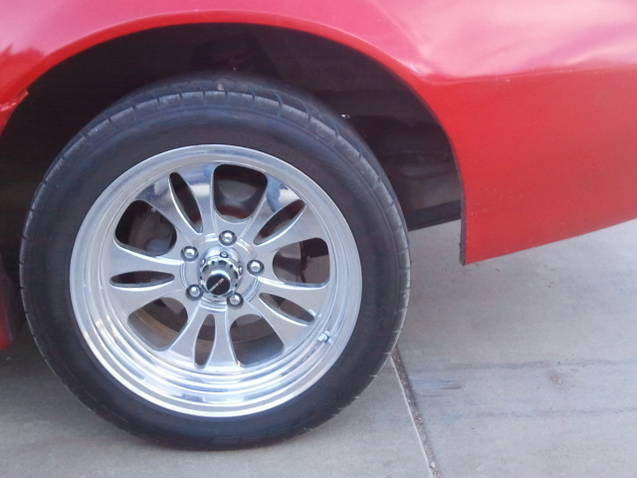

      Feb 2011
      145
      My car is all stock for the most part.
      I have done some mods.
      I put a 3.73 gear in the rear. I had the muffler shop put dual
      exhaust on it. The latest thing I have done was put 17s on it
      the suspension on the car is 4 years old and was set to stock ride height.
      Here is a Pic of what bugs me.
      I dont know what it is but the wheel wells make the 17s look tiny
      And here is a pic of the mufflers
      they look tucked in there nicely but like I said if I drive over something just right they drag.

      the factory tires were 27.5" in diameter. it looks like you have the garden variety 26" tire on there now. if so, you are adding .75" of extra fender gap. also, if you add an inch larger diameter wheel to the rear, you will have to add an extra inch to rear tire diameter to avoided the dreaded shorter rear sidewall syndrome. this is where the rear tire sidewall is shorter than the front and looks like crap.
      you can lower the car a couple of inches and be fine if you tighten things up. of course stiffer shocks and springs are the norm for lowered vehicles to reduce bottoming out.
      as for the exhaust, you always have the option of a transverse mounted muffler behind the rear axle. you can get these in dual in/dual out configurations. that should buy you an additional 1.5" at the current muffler location. that may not sound like much, but it is alot when dealing with lowered cars.

      I would get the pipes up with dual in/dual out transverse mounted muffler, put a nice set of handling oriented shocks all around the car and put a 1.5" block on the rear springs.
      if done properly, the exhaust should gain you about 1.5" and the blocks should put you back right back where you are now as far as total ground clearance all while closing the fender gap 1.5". now here's where the stiffer shocks come in to play. they should firm things up nicely and solve the bottoming in dips problem.
